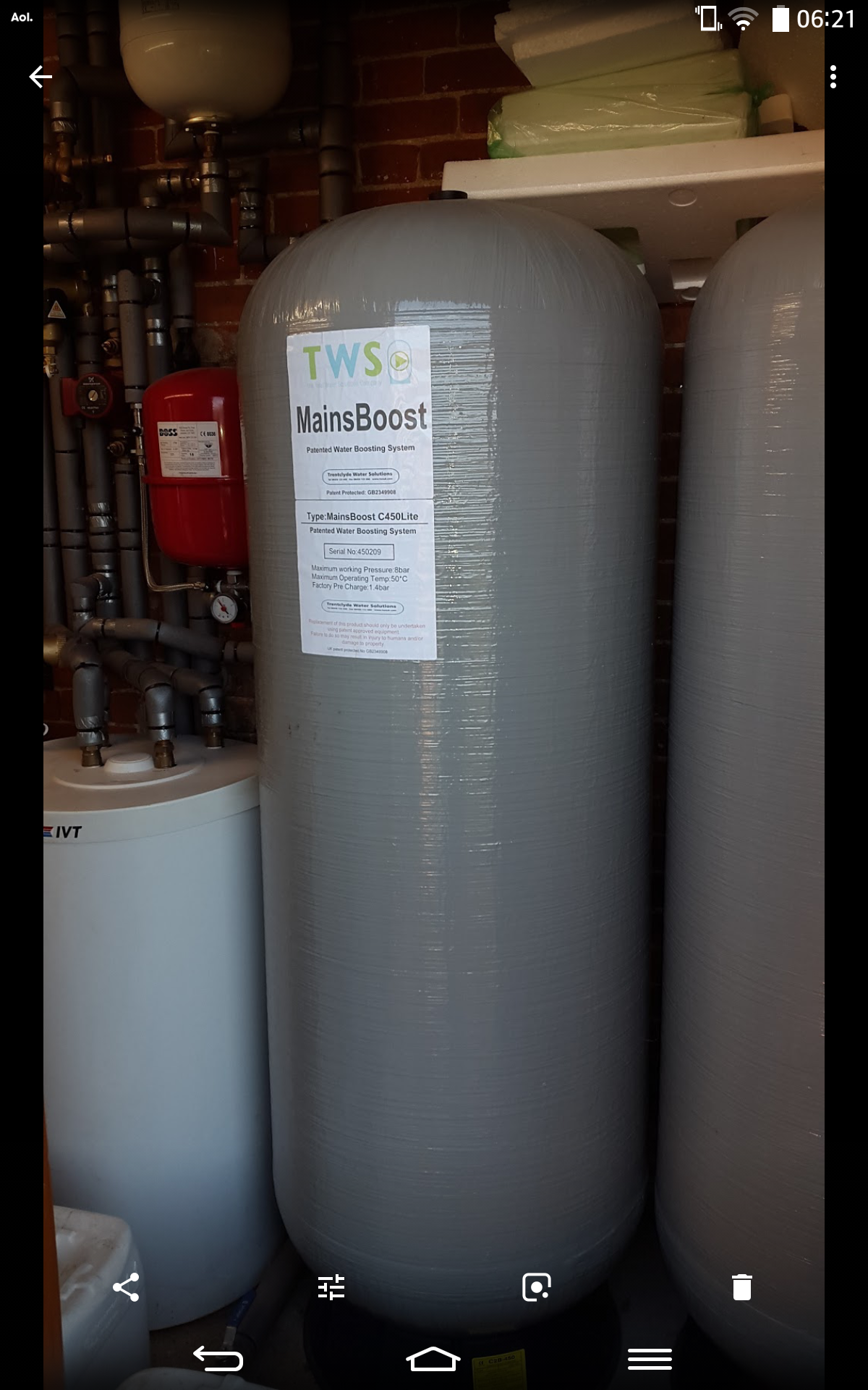

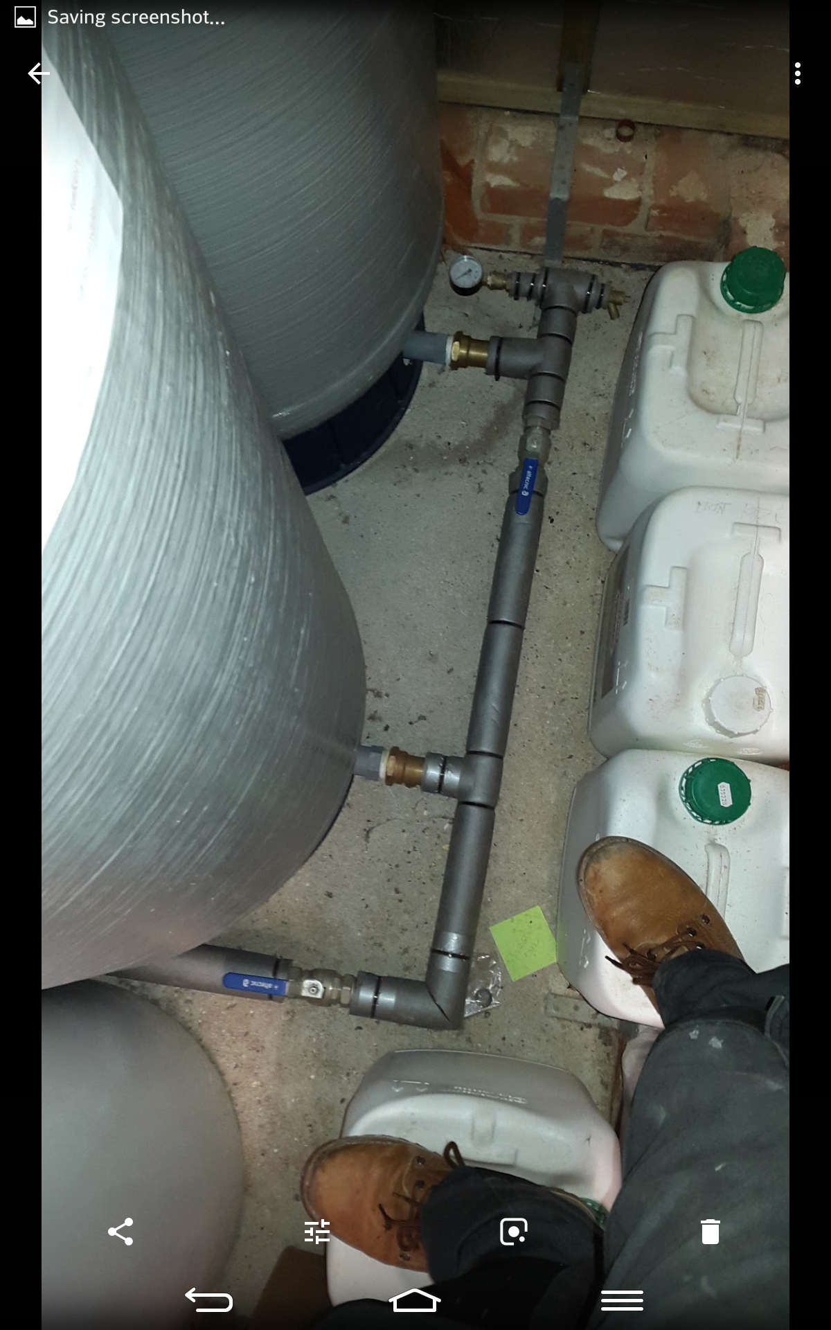

TWS contact them bud heres one thats been in 6years 20mm supply in and does 2 properties . kop
