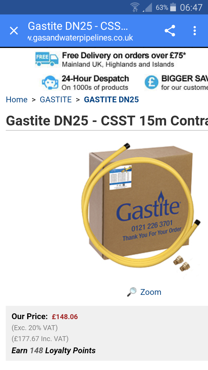

  10. ShaunCorbs
    • Like Like x 1
  11. king of pipes
    As shaun has kindly quoted above kevin i just ordered a contractors pack 15m of 25mm gastite flexible gas pipe with fittings from [email protected]&waterpipelines.co.uk please be aware you need to be gas safe to work with this product. regards kop
    • Like Like x 1
  12. ShaunCorbs
    Don't you mean 28mm and how are you going to connect to copper if it's all in the floor ?
  13. king of pipes
    No joins in the floor shaun a adaptor to 1" BSP each end 300mm above ground sorted
  14. ShaunCorbs
    Depends where the gas is fed from already if off existing in the floor or a in the wall meter box
  15. king of pipes
    Gas Meter to point of use new supply bud cheers kop
