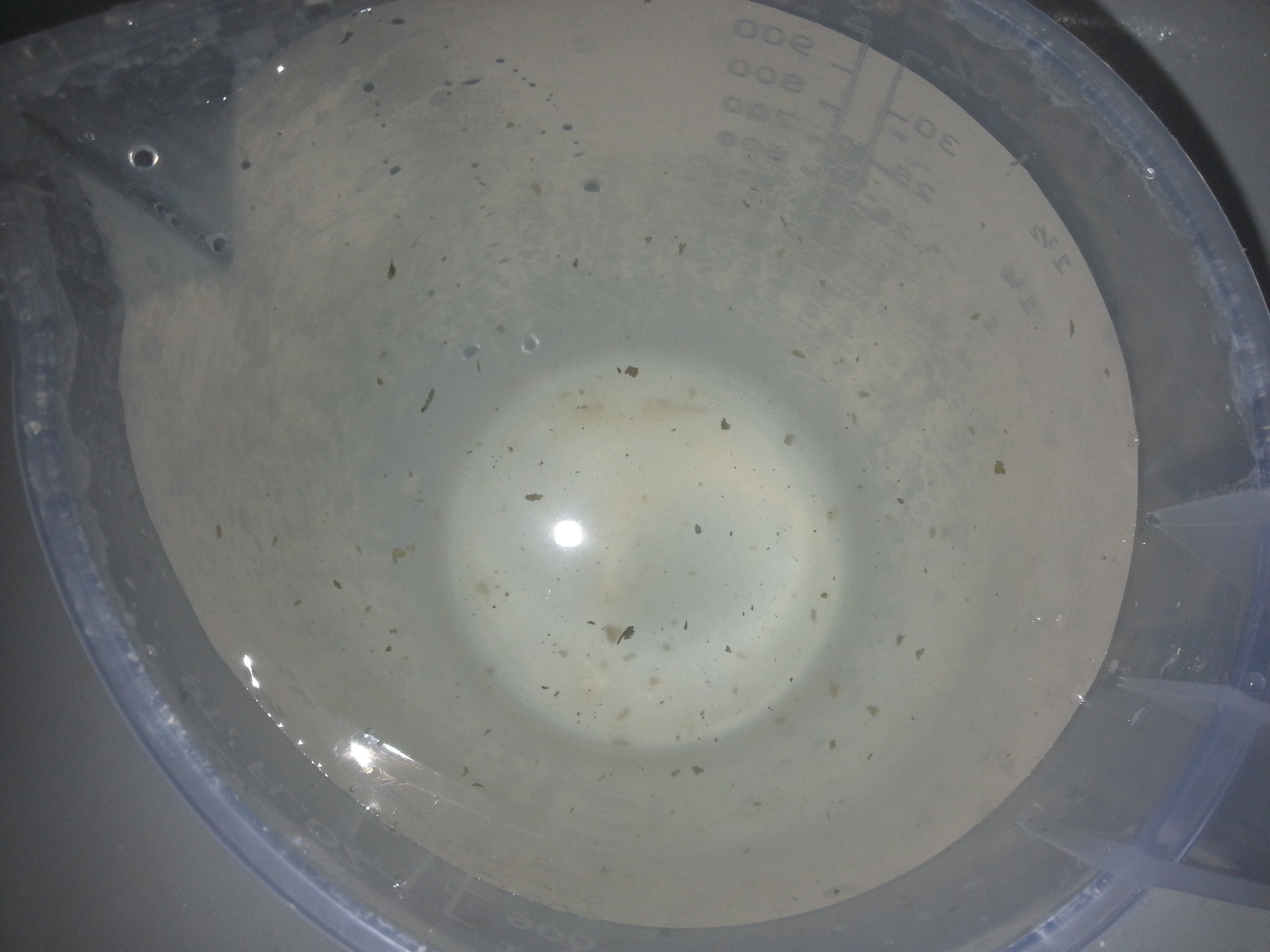

Hi all, I have a standard condensing boiler fitted in 2013, BG 330+ I think.
Trouble is dirty water is coming out of taps in bathroom. Small little black flecks.
Also since this boiler was installed I've become disabled and also looking to get it changed to a combi for instant hot water what sort of cost can I expect?. Any ideas as to the black specs in water? it's very bad!

Ok, just checked again, the bath is fitted with a mixer/shower unit and it appears that the black stuff is coming out (a lot!) when it is turned to cold. The hand basin doesn't seem to be affected.

Sounds like it might be coming from your cold water tank if you have a copper cylinder

What I would say is, (if it makes any difference), I fitted this bath in, in 2004, it is a Jacuzzi type bath and it has the taps mounted centrally on on one of the longer sides of it, therefore I had to fit two of those long flexible metal braided pipes from the copper ones (which are located in the old end of bath position). Also as the mixer had very little pressure, it has only been used about 20 times in all those years as we use the shower downstairs, however, now my disability means I now need use of the bath. Hope that makes sense.
If it hasn’t been used that much. It is probably stagnant water in the pipes that have formed a mould on the pipework. Can you flush the pipework properly?

Yep, just open the cold water tap and let it run, see what happens.
Then why is it not effecting the basin tap?
Basin taps are normally fed from mains for brushing your teeth etc
