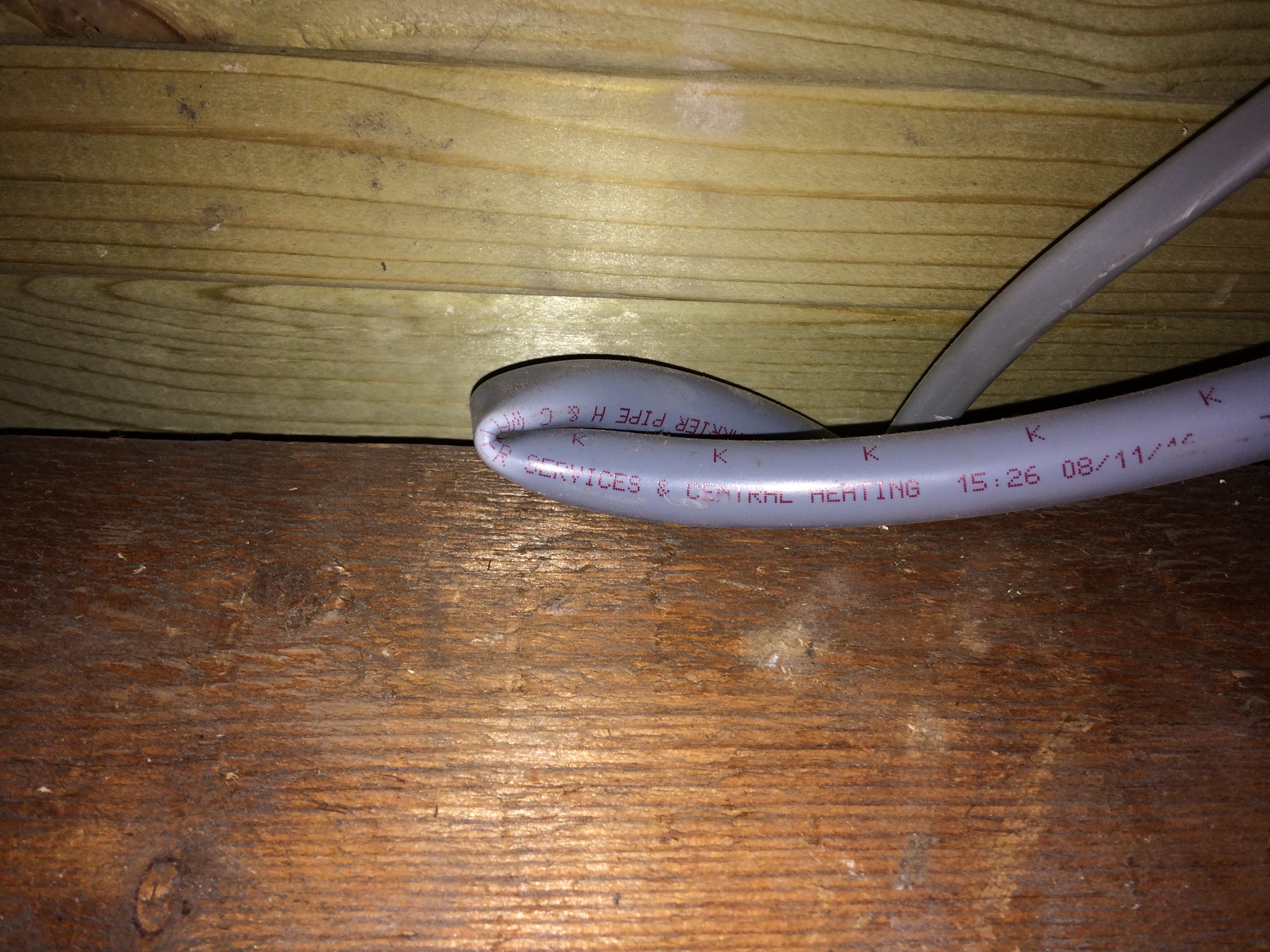

Thanks for advice. Found the issue. After taking floor boards up and knocking quite a few holes in the ceiling of the bathroom below I eventually found this...
(Kink in pipe). But it's not the plumber who installed pipework and radiators' fault apparently.
Wow! Whose fault is it then?
Only person who could have done that to the pipe was the person who pulled the end of the pipe into position.
Typical builders 'plumber' work
Glad you found the fault
I would replace the damaged part and not just to straighten it as it could burst later on
My thoughts exactly Best. Was going to cut pipe and fit straight coupler (with couple of inserts). Am I ok cutting the plastic pipe with a 'copper pipe' cutter?
no wont work needs to be a plastic cutter are worse case hacksaw and a file
