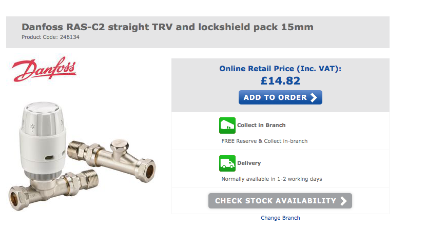

    Looking at the last set of pics Carlton, I am fairly sure that the pipe you labelled 'Heating valve' is not for the Heating. I suspect it is a cold feed to something. I may be wrong because I'm going off photographs.
    You need to look in the loft for an isolation from the F+E tank or, drain the heating after you have turned the mains water off.
    It is - as everyone is saying - a very easy job for a Plumber and you would be best advised to employ one. However, if you would rather try it yourself, that's fair enough.

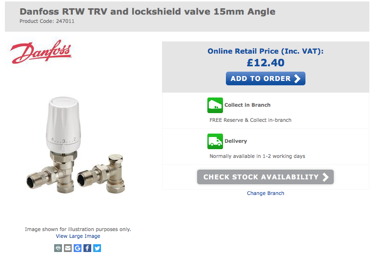

    I was going to go with these valves as a replacement although I know 'Last plumber' recommended another brand, I haven't looked into those yet but will do in a min.
    What do you guys rec?
    They are £10 for a pack including lock shield.
    Altech Angled TRV with L/S Valve 15mm White Pk 2 - Radiator Valves & Accessories | Graham
    The only reservation I have with these is that they only work from 7 degrees upwards. Although none seem to work below 0 degrees. I guess it's no big deal as you would rarely set your rads to below 10 anyway right?
    Also do you have any better recommendations for TRV packs off the top of your head?
    And lastly (sorry) the adjustable side on the radiator I pictured is on the right hand side, which seems a little odd and annoying since it puts it into a corner, which would mean its ability to read a room temp accurately will be greatly diminished. Can I swap the sides over? (I'm going to assume the answer is no and bring about some merriment from ppl who know even the basics of pluming, which I clearly don't lol).
    Thanks in advance.
