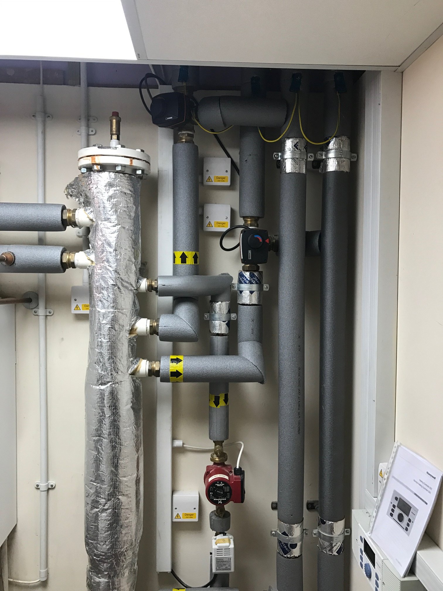

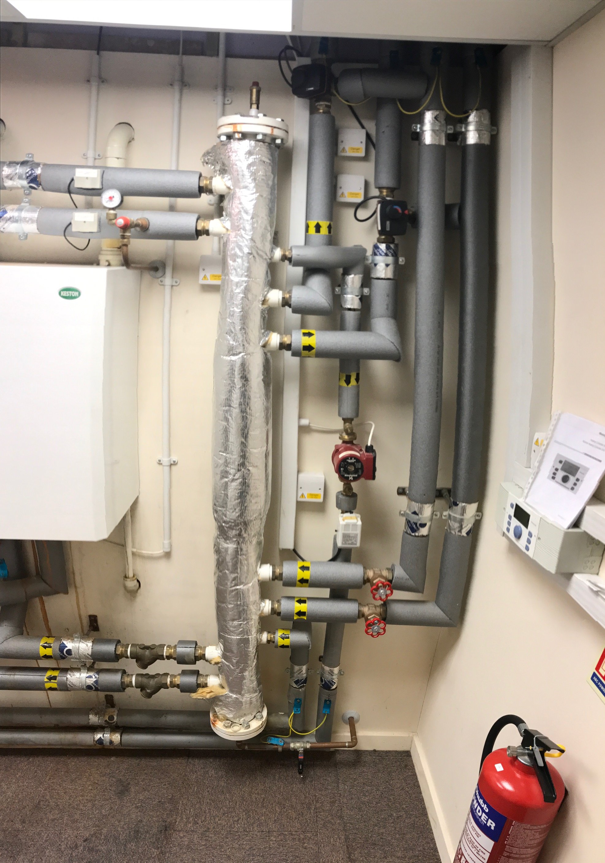

In my opinion. It sounds cheap. Have you checked the output of those heating circuits?

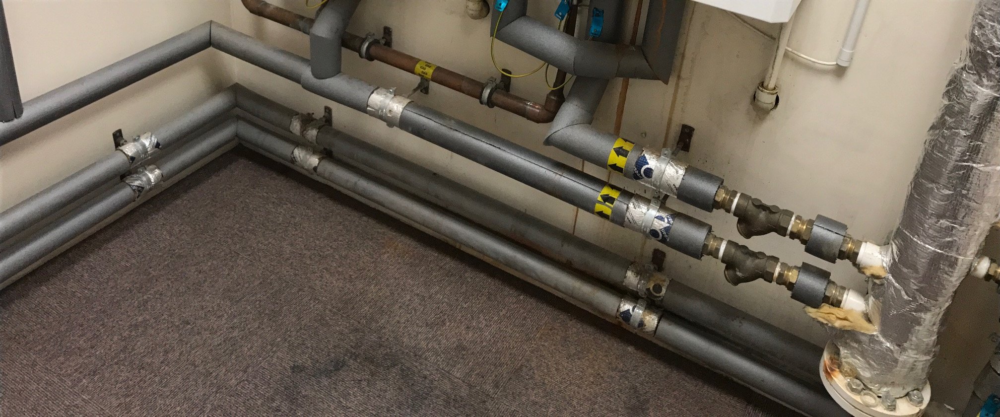

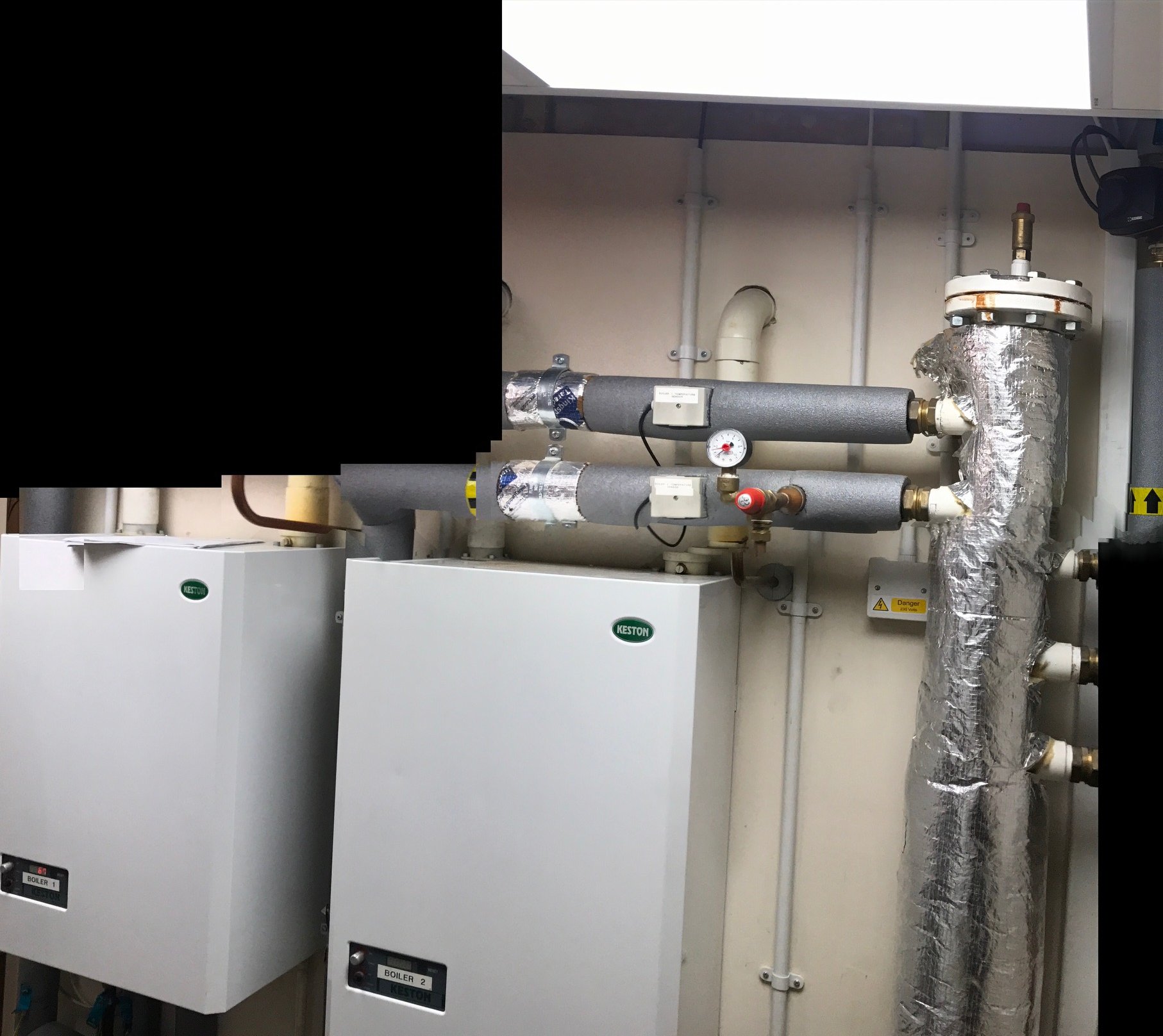

Obviously I'm only looking at the photos ( not seen job in real life), but the boilers sound too big for that pipework I can see on the header.
I think the boilers you're talking of will be 1 1/4 inch at least but I'm also questioning the heating circuit size.
What size are they ( look like 28 on photo?)
If it were me pricing that, I'd want more info on sizes before I did the job !

The existing boilers have 42mm flow and returns which is actually the same as the new boilers. Existing ones are 55KW Kestons and new would be 65KW WBs.
Secondary circuits (2x heating) are in 42mm as well with mixing valve to control circuit temperature. There is also a HW Circuit to a 300L twin coil cylinder with solar also attached.

That llh looks like it's leaking or has at some point. Have you considered it might need new gaskets?
What are the walls like? How long to core two new flues?

Have you allowed for shunts ? or are those the pumps you mentioned? I don't use Worcester Bosch so I don't know if they come with shunt pumps built in.
Is that existing header large enough for the two new boilers?
Have you thought of controls?
Have you allowed for a non return valve on each Boiler?

hi croft sorry about getting here late
few questions
wheres the pumps for the circuits (not the shunt pumps) ?
i wouldn't freeze it, as its going to be a pita with a llh (always moving)
close the two red gate valves, they should work good yorkshire valves, cylinder in the same room? by the looks it is maybe
pop the heads off the actuators (marking which one is which) and turn them to bypass (return)turn the pump valves off
open the bottom lever valve on the llh (drain) should be drain but might be expansion vessel, also at this time replace llh top and bottom flange gaskets
you should be fine now and fit lever valve straight onto the llh flow and lockshield gate valves on llh return

Will you need an etra flue bend on each to get 600mm apart?
30cm if there both inline eg same height or 1.5m if above
I have always had to fit commercial boilers with 600mm between flues for the clean air act. Vaillant insist on it when they comission
isnt that for anything over 70kw, im 80% the instructions say 300mm

Circuit pumps are all on the right hand side of that wall, should be on the photos.

Cylinder is in the same room yes, basically a domestic hot water circuit in 22mm off the LLH.
Curious why you would use press fit? Just to avoid setting off fire alarms and needing hot work permit??

cant see any pumps in the pic other than the one for they cylinder
if you mean the pumps are the black boxes no there control valves / actuators
and thats good
yes as you will need to stay an hour after you finish and fill in the hot works permit
and tbh its faster and less hassle doesnt matter if theres water in
Sorry mate just checked the pictures again. 2x heating pumps can't be seen on the pics but they are at high level just out of sight above the boilers. Definitely in the room, remember seeing them!
