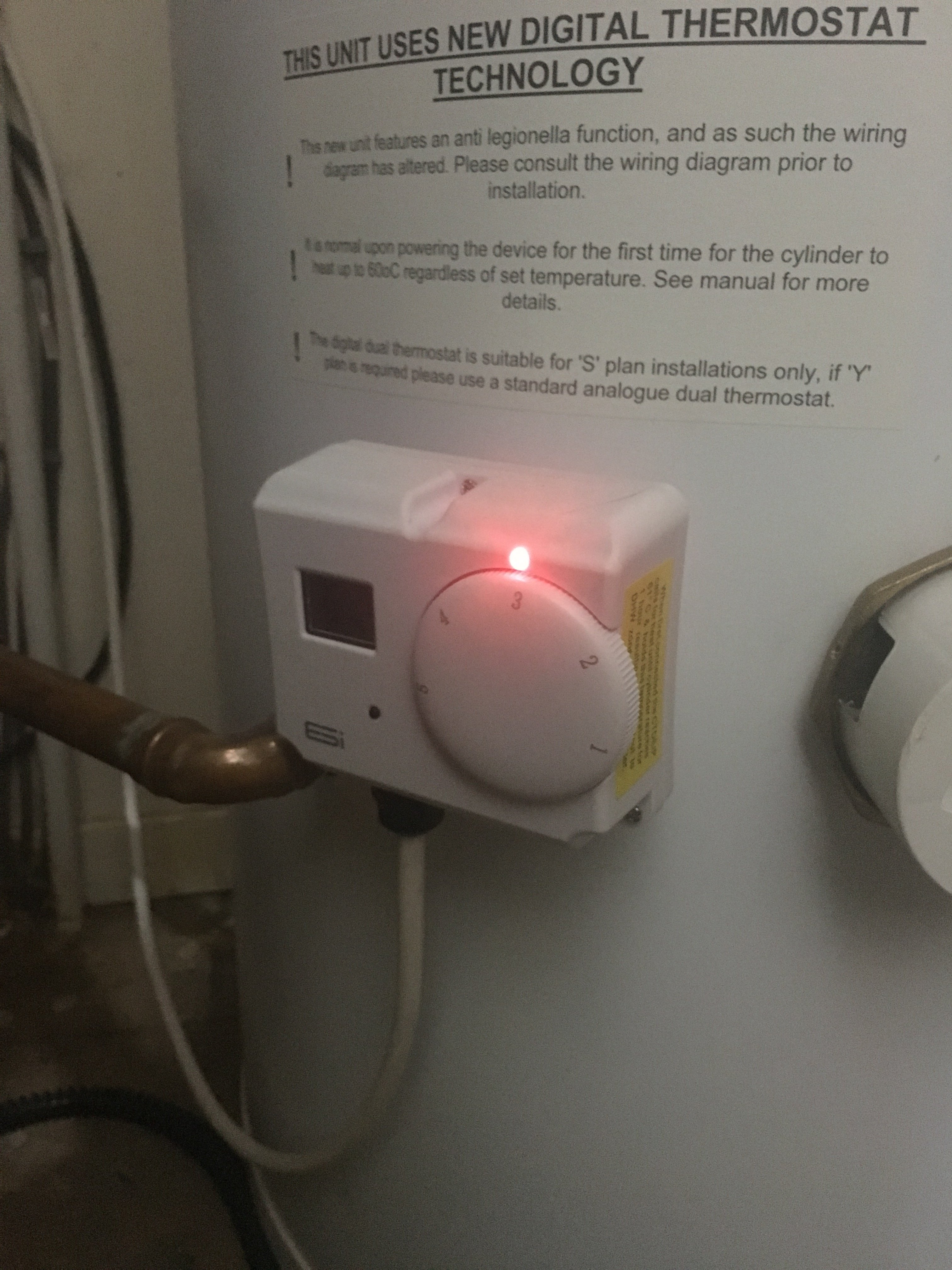

Also, it may be my imagination but the little thermostat looking thing on my water tank (image also attached) now has a red light on it all the time - I don’t think it did before... what is it??

Will the pump take any harm being on constantly for the next week or so until I can get it looked at? Also should I be concerned that the cylinder thermostat’s red light is always on? Reading the manual that means it’s constantly calling for hot water, which doesn’t seem right?

I had missed the photo of the 'stat. Normally, the red light is a "calling" indicator, as you suggest. So it may be that which is the problem. But it should not be getting power in the first place, unless the programmer is calling.
Is the water hotter than normal? If the system is continually running in response to a faulty (continual on) HW stat, then the water would eventually reach the same temp as the boiler setting, which is HOT. If the water is np hotter than previously, then there could be an electrical fault,back feeding to the neon.
If you look at the label above, it says the digital stat (which you have) is NOT suitable for a 3 port valve - which you have. I don't, TBH, immediately know why that is the case, but it may be (as you implied is possible) that the light has always been on, and that is because of the basic mismatch of the controls.

it may be the wrong stat read the bottom line above th ethermostat it says digital stat for s plan only if y plan used standard stat your system is a y plan
