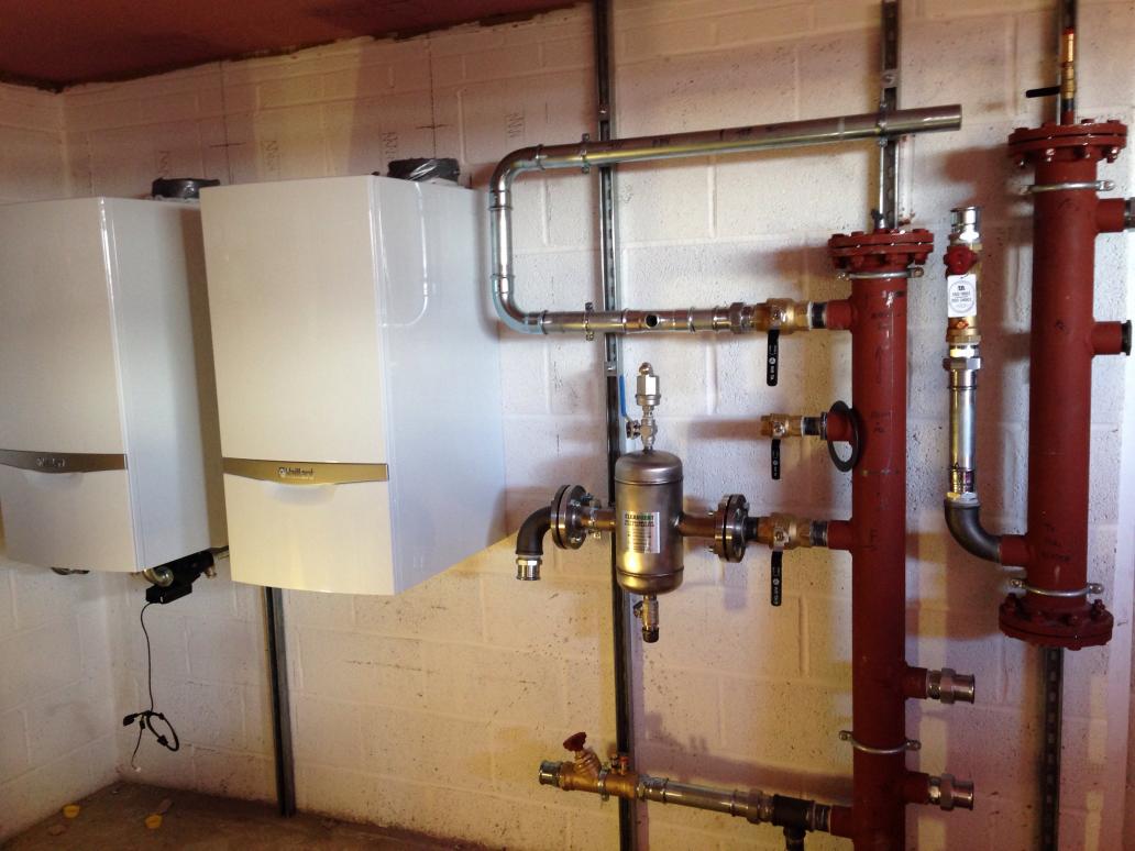

What size is that gas line Si?
Could be the angle but it looks more than 2"!
It is only 2". I've had all my 4" welded. And there's nothing in between.

I cant work out from the pictures what going on with the gauges? are they pressure? what else is tee'd into it?
Dont forget to paint your black fittings.
They are monometers. And they are tee'd in to a dp switch to prove pump flow
Ah, just spotted it on the wall, thought it was going into another pipe.
Not sure if you fitted the pumps, looks like the threaded bar is set into the concrete base? so they wouldnt be removable?
No. If a pump fails you would replace the head not the body IMO
Yes they are set in concrete
That would be the sensible way:wink_smile:

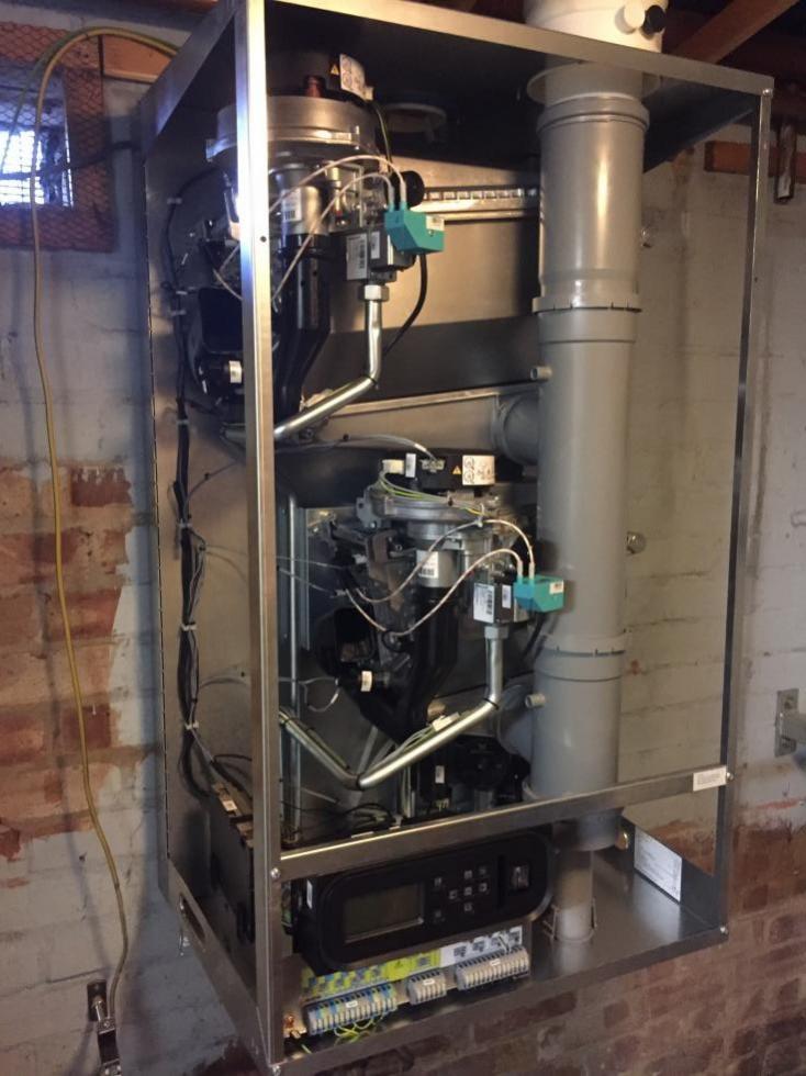

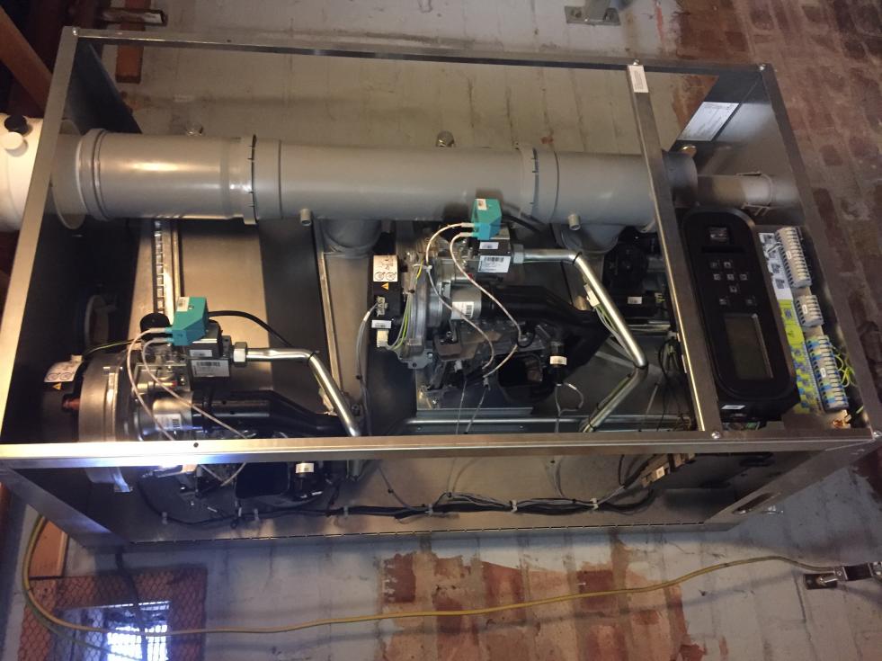

They are 3x Strebel 500 boilers, 2x CT pump sets, 1xVT pump set with 3 port valve and Enwamatic.
You can see pictures of the header in the background on the last page:smug:
