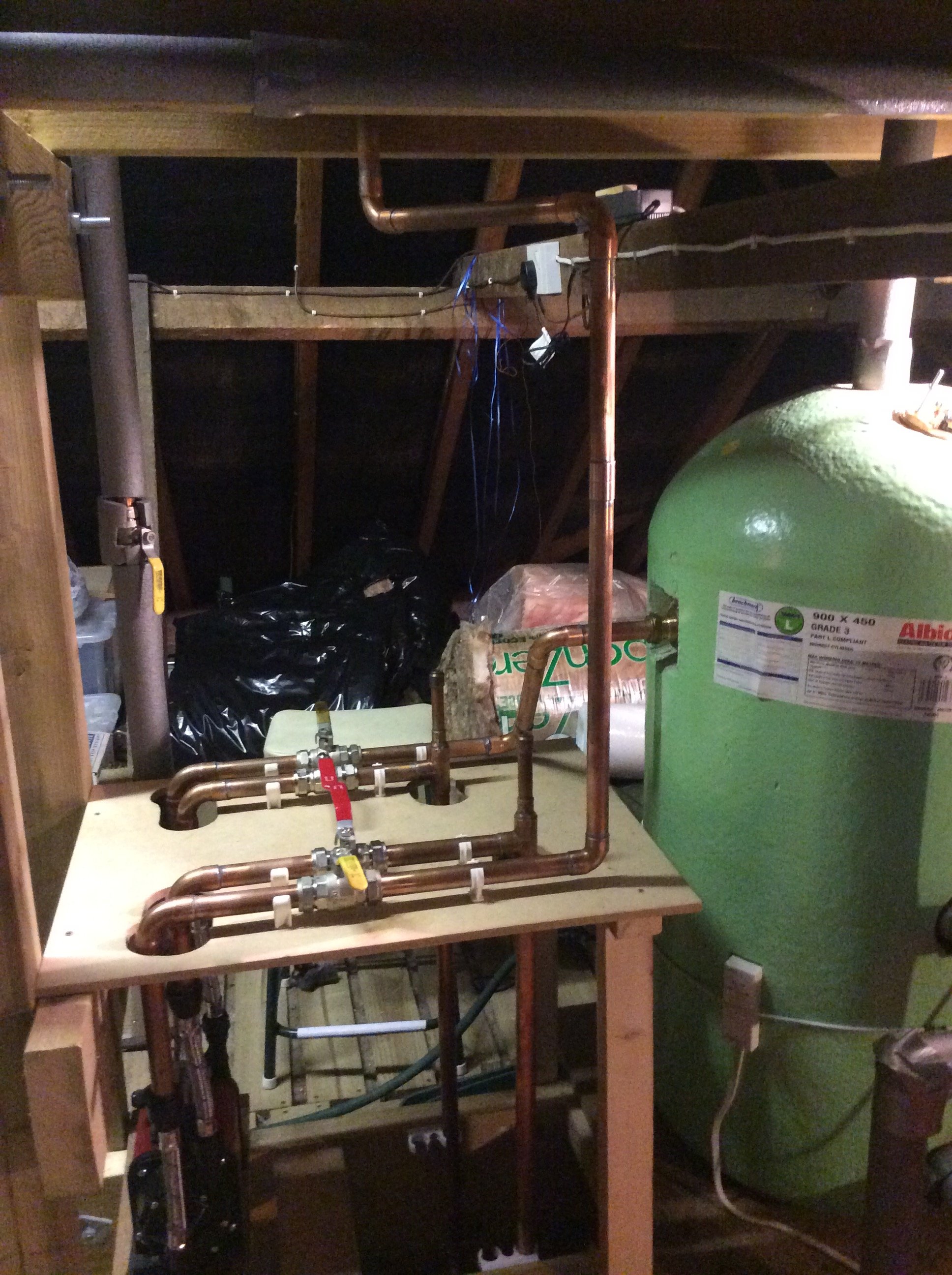

After all this time have installed the Essex Flange. New immersion heater, and new shower pump. Revised all associated plumbing and hey presto....it all works. Shower is really good and even better no leaks. I still keep checking even though it’s been done over a week ago. Should have more faith in my ability!!!!!
Looks good, you sure your not a plumber :)
Also if it hasn't leaked by now it won't
