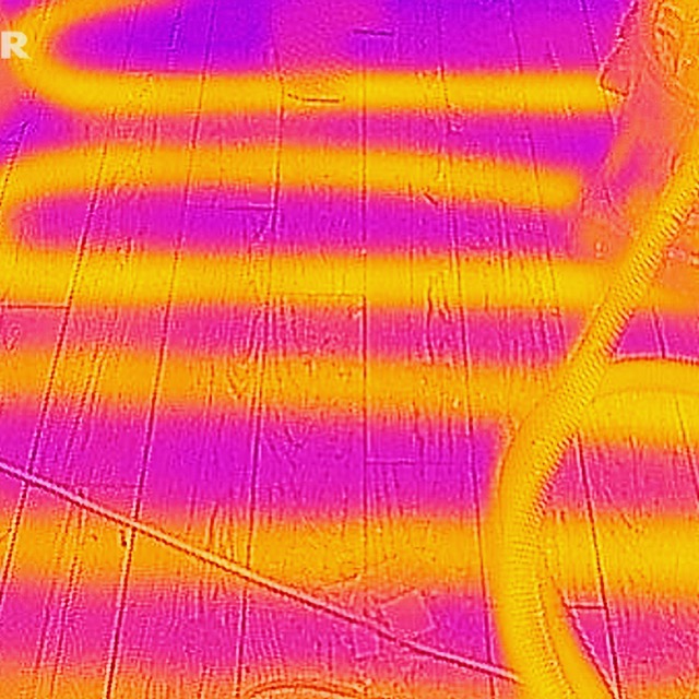

    Not every engineer has thermal imagery to hand.

    You could switch on UFH and use your elbow, it's quite sensitive.. or is that for babies' baths?
