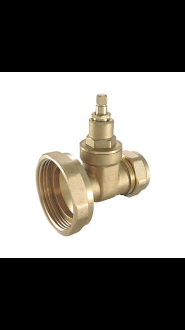

Well that’s the new pump and gate valves in.
These are the valves
Pegler Pump Valves 22mm x 1½
Should they just be turned 90 deg?
Or open them until they stop?
Many thanks!

I spun them both ways quite a bit, will this cause any concern?
Those are the best pump valves you can get. They will always close fully, and won't seize, or weep.
I have used them and keep some as spares.
They are basically identical to full flow lever valves, only top quality.
The ball will not be damaged if turned lots and the seal is hard ptfe.
Only one drawback of them is the large pump nut cannot be removed or replaced, like with ordinary pump gate valves.
The spindle should be flat side parallel with valve.

I will use them from now on sounds like they are awesome. Never even seen them before.
I've seen spherical pump valves before. Seized solid, mind you this was at a house I lived in in 1995, so perhaps the new ones will be better?
You can also get similar pump valves that have stubby handles on (they look like the valves that are on mag filters)
I think Williams supplied them and Ray had put a link on this forum about same
Most are absolute garbage and ALWAYS leak when turned.
However, Pegler are quality. When I did installs, I always used Pegler valves (at least 4 to 5 times more expensive than the others), but not 1/4 turn PV's - simply because I never thought of them. They should be good - thet are £14 a pair from Screwfix
When I installed a Fernox Boiler Buddy filter for my brother, I made sure I fitted those Pegler pump valves. Boiler Buddies fit between two gate valves the same as a pump would.
I knew I would be relying on those valves regularly to isolate so that the BB can be removed for cleaning. They turn easily (1/4 turn), and have never wept or seized since fitted.
Not cheap, but grief free.
