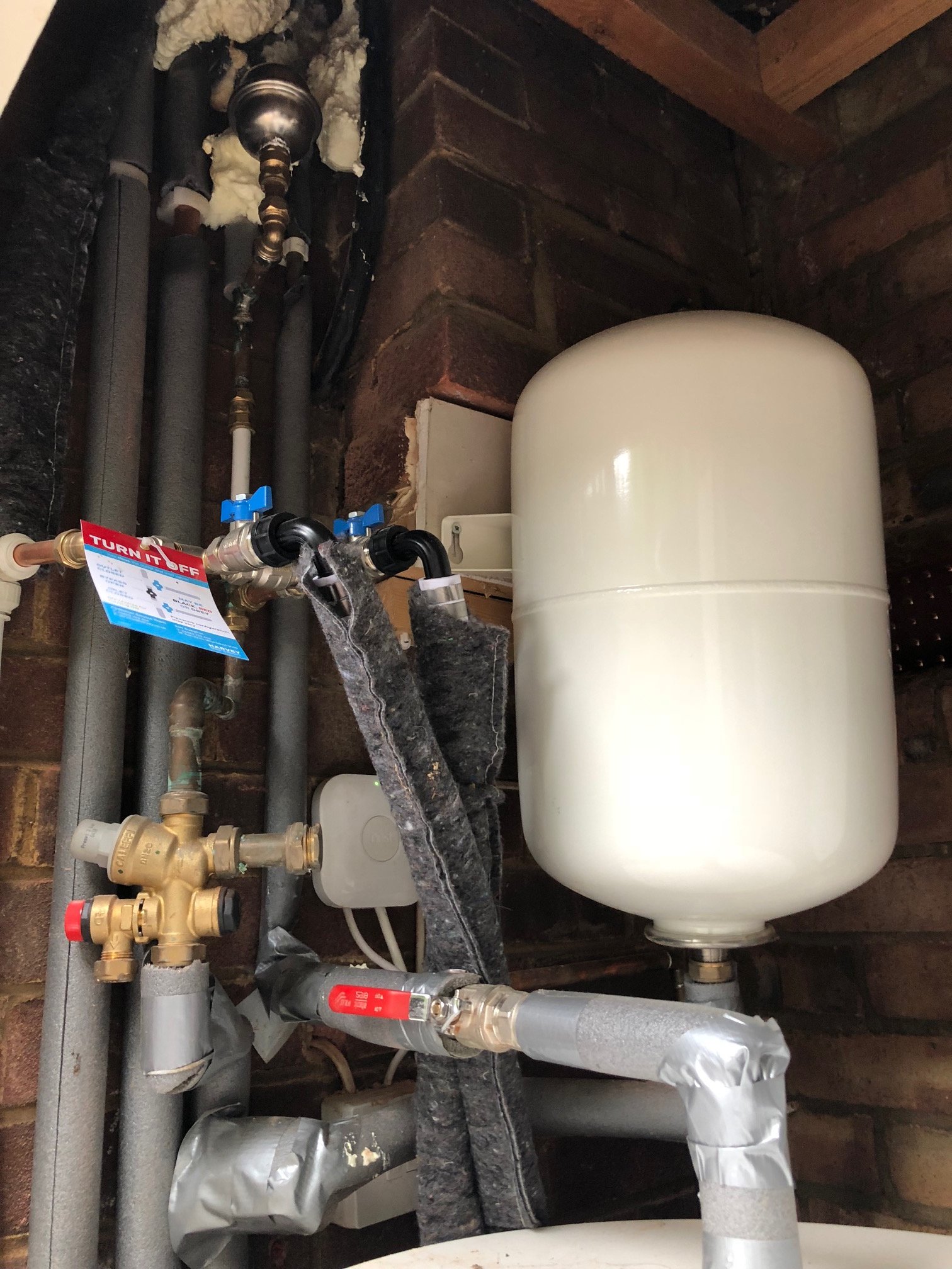

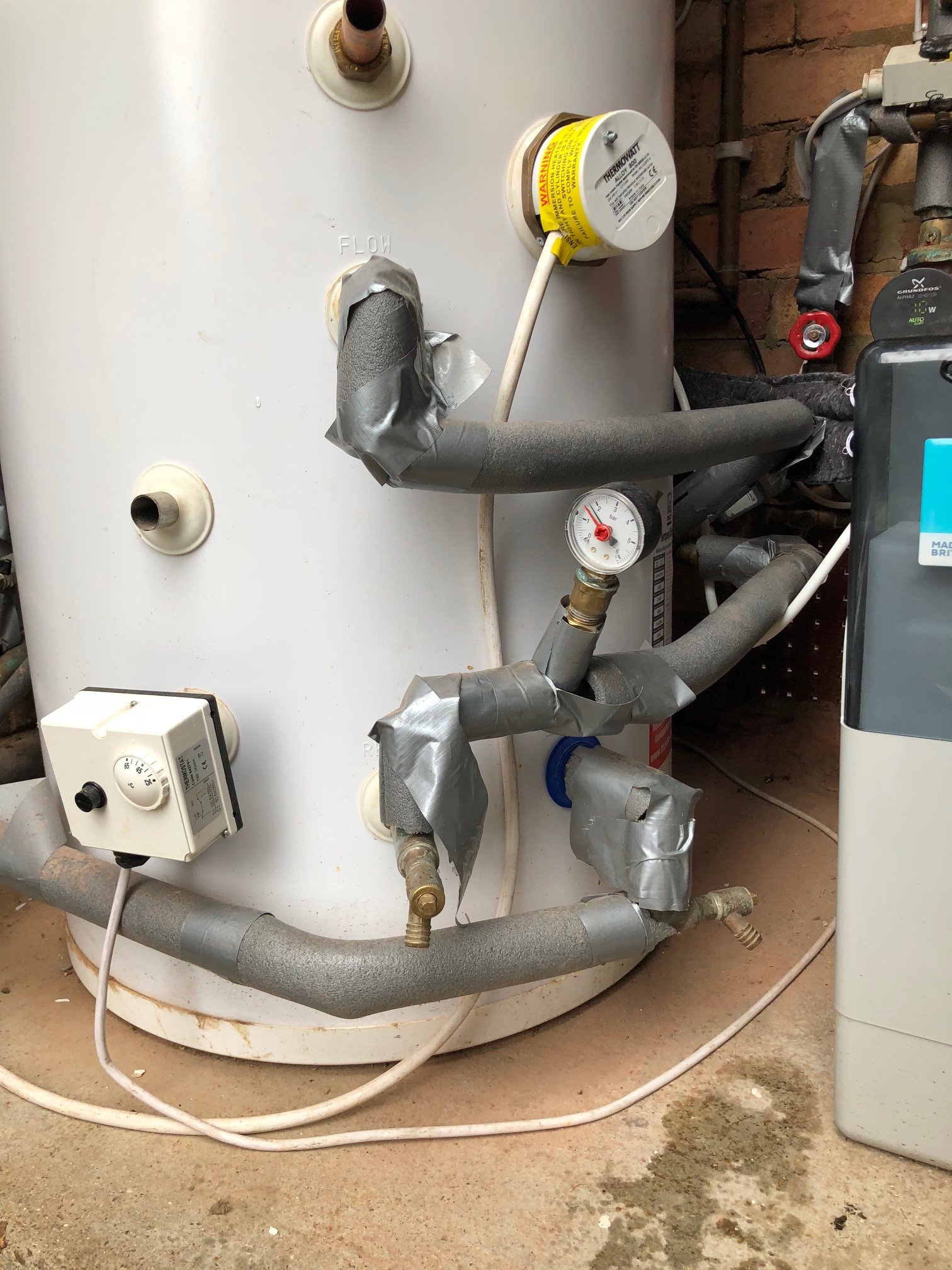

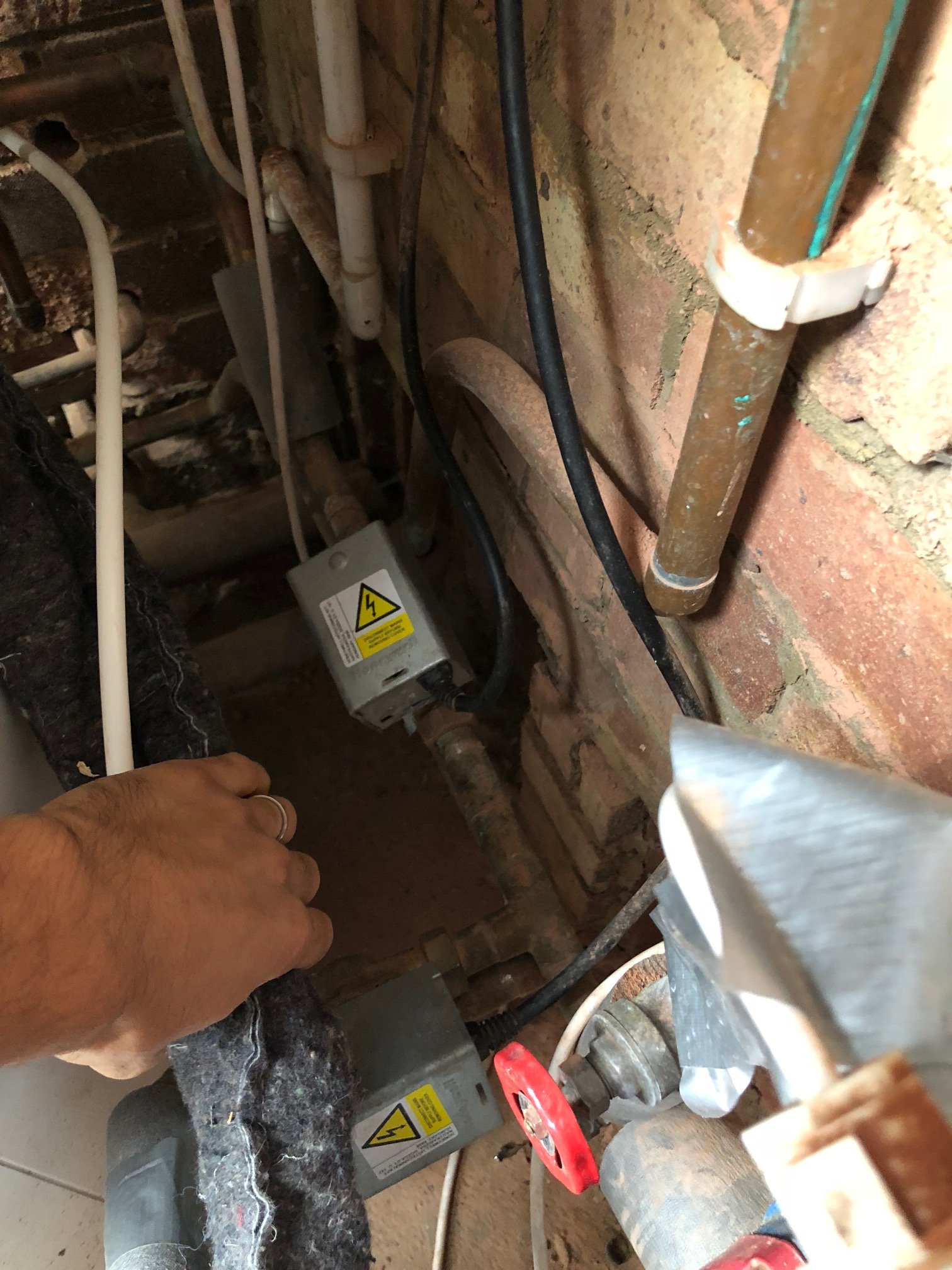

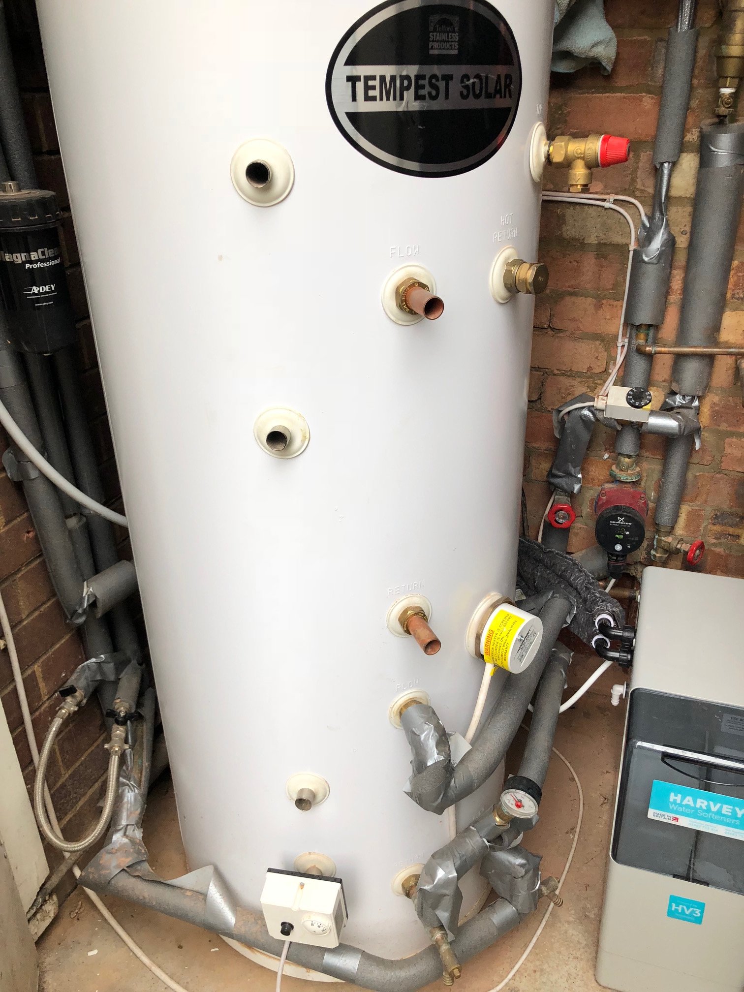

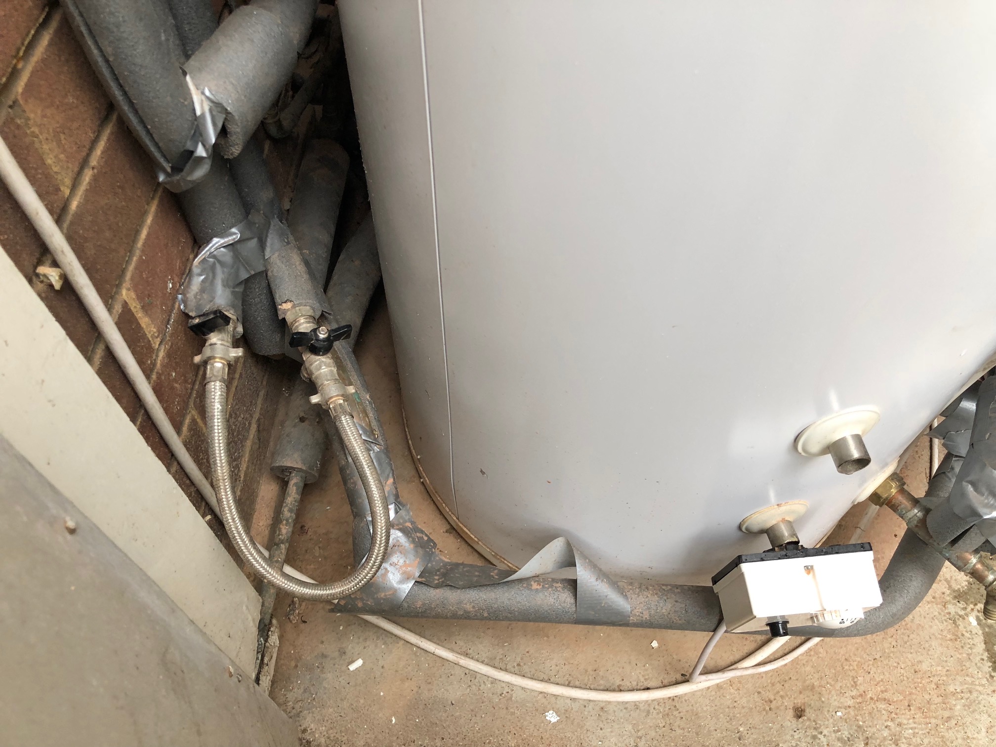

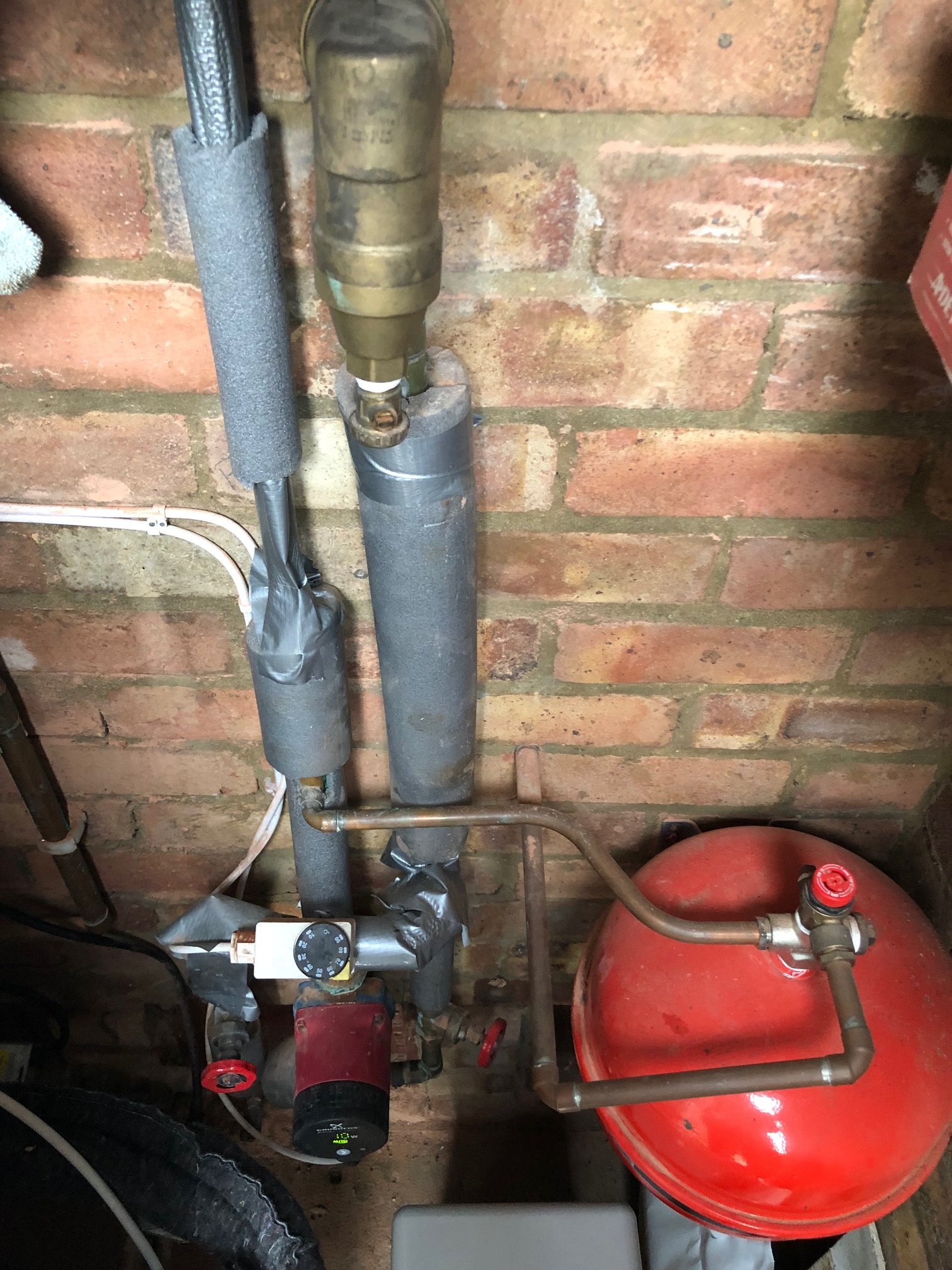

Images attached,
You are going to need a voltage tester to make sure 240V is getting the the valve when it should, it could simply be a loose connection or an intermittent motor fault on the valve, without a tester you will be guessing
not very good install non of the safety pipes are installed
best get a g3 and gas safe engy to have a look over the system

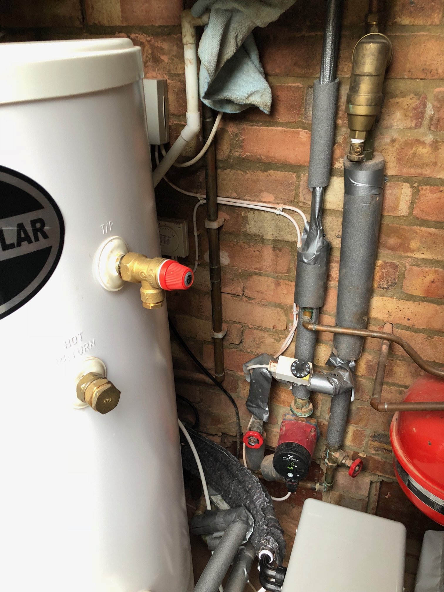

TBH, i cannot really see much from the pics, dont appear to be able to blow them up. the PRV, (red thing near the big logo) should go somewhere so pics of that would be useful. Cannot see Gassafe being interested in a faulty cylinder install but if the guy cannot install a cylinder its possible he cannot install a boiler
I looks like a dozen different people have fitted bits and made alterations with what ever materials they had lying around.

The safety valve aka pressure relief valve appears to be there (red thing) but if it does in fact relieve itself it will discharge water directly into your house roughly south of the red valve. It is supposed to discharge water outside (in a safe manner, i.e. so not to scold anyone ), also there is supposed to be a device below the red thing so you can visually check for evidence of discharge. Your property is currently at risk from water damage as is.
yea is that prv just open ended or IS IT CAPPED OFF ? I worry
both are wrong capped off is really bad
That is a bloody good point!
I think looking at the last photo that the P&T relief valve has the internal compression nut showing and hopefully it is not a 1/2” blanking plug. :eek:
It's not blanked off it's a nut and olive but the nut is externally threaded
eeekkk, best op take a blow up of the PRV for us to muster. Never seen a blanked off PRV (whats the point) ,so it would be a first..
I have seen one brand new unvented install that the plumber screwed a small lever valve directly into the pressure relief of the combination valve (which was also installed near base of cylinder). He also joined the D2 at tundish to 15mm copper and just run it out through wall at first floor level. Bizarre.
I think I read somewhere that unvented units sold in U.K. must come from factory with their P&T relief valve already fitted on cylinder. I suppose this is to ensure they are safe from exploding to make them idiot proof.
