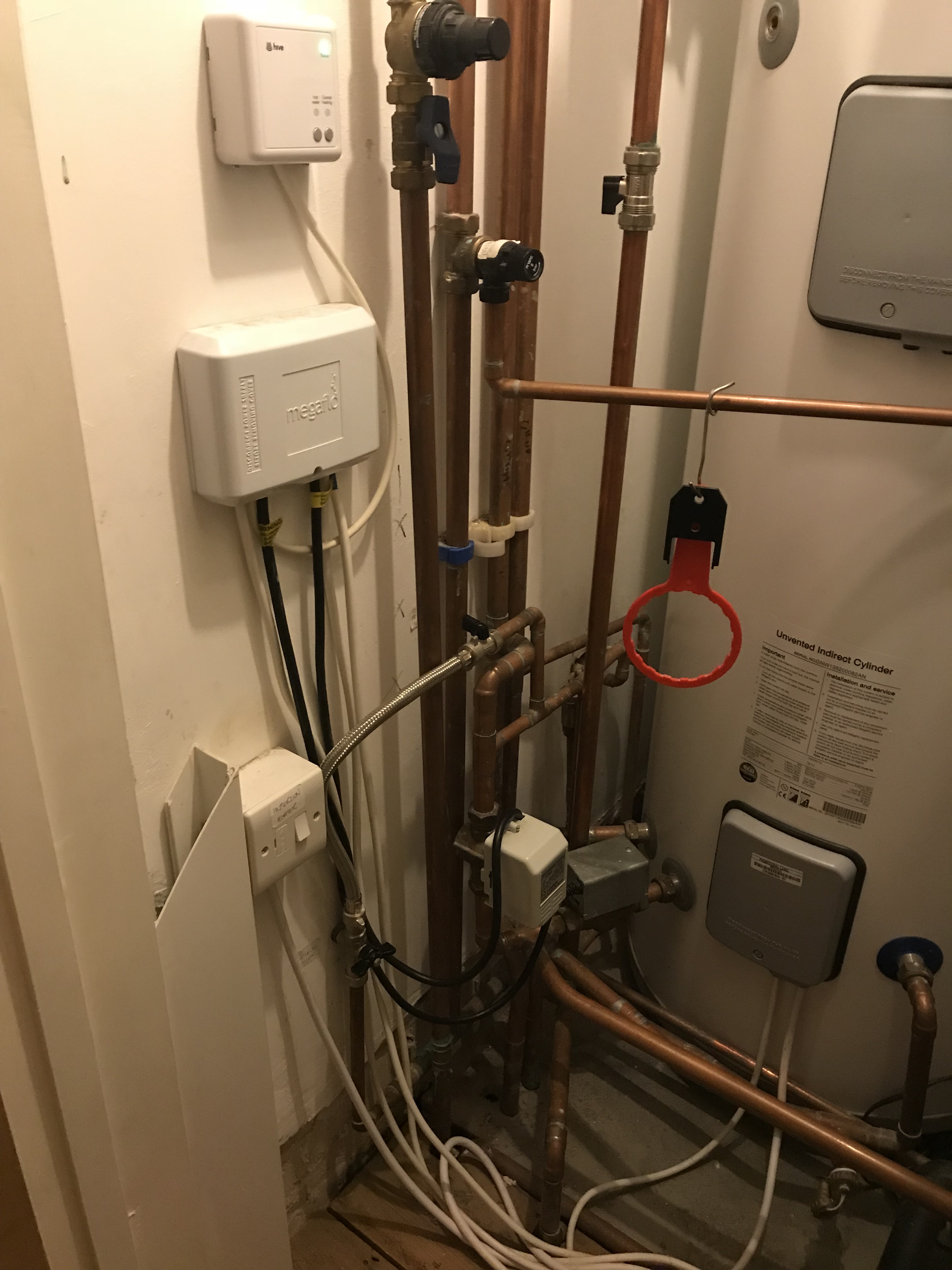

Please see photo... Yes the water pressure in taps seems ok. I did notice about a week ago though in middle of night when getting some water, there was very little water coming from the kitchen tap....not sure if it was Thames Water working on system

Make sure that the stop tap is opened correctly and make sure that there is not a stop tap in the cupboard that has been turned off.

I just checked system and can see boiler was on. Pressure is now registering 3.1 bar in use?!
Not sure what is going on
It will be what shaun said. There will be muck stuck in the system that needs cleaning out.
dont fire the boiler up
have you got a small container if you have bleed a rad via the air bleed screw until you get it around 1-1.5 bar cold or 2-2.5 bar if the system is warm
Pressure sensor will still need sorting though Shaun. Get an engineer out to sort t for you. Otherwise it will do not again.
yes but to get her by for now, least she will have heating and hot water
I have turned boiler back on and bled rads - think I got it 2.6 bar whilst running, bled some more about 2 -3 cups and then it went 2.7. Can't trust what it is so have turned it off....don't want to damage boiler or megaflo
I had to turn boiler on to see pressure on system...otherwise you are bleeding rads and don't know what pressure is. It's a bit stupid you have to have boiler on to read pressure. Valliant must have a few perplexed customers because of this
Plumb base do a filling loop with built in pressure gauge, handy to have a gauge near to where you fill system or else you need two people one on filling loop and one watching pressure on boiler
