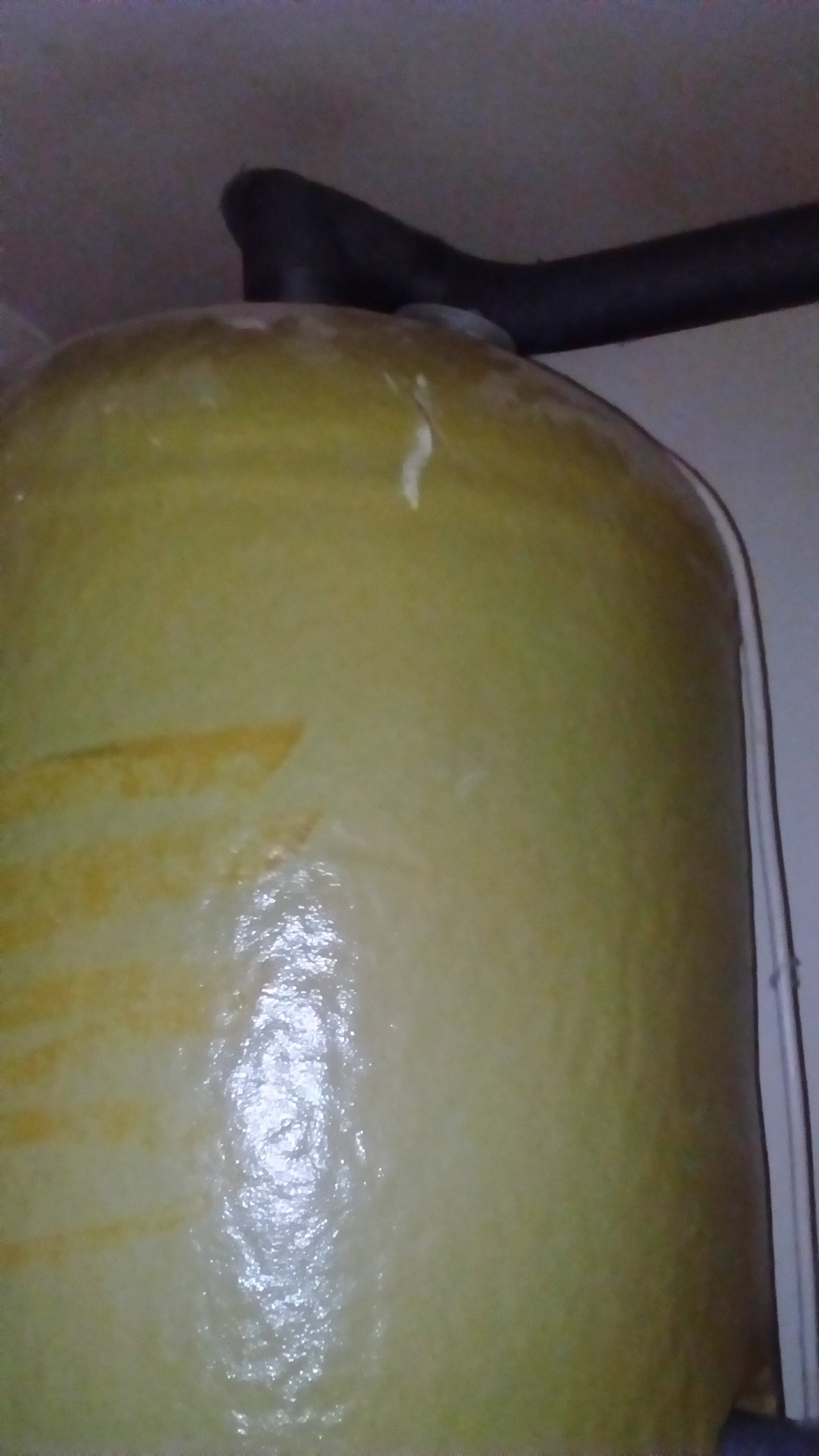

Do you have immersion heaters in the cylinder?
Post a pic if poss
Yes but never have it on
