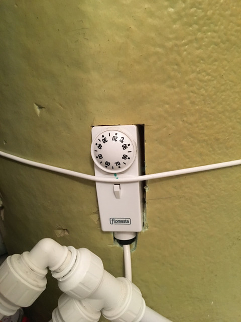

Had a new cylinder stat fitted. Flomasta thing
Open vented system, newish boiler, no problems with that or heating now after work done
Set at 65 as recommended
Hot water on at controller for over an hour this morning and from cold the cylinder only got to 25ish
Had it on since 6 tonight and stat only clicking off at 45ish yet boiler has been off for a while. Hot water from the taps and shower is bloody hot though!
Have I got a problem or is it just taking a while to heat?
Where on the cylinder is the stat located? If the water feels 'bloody hot' and the stat is detecting around 45 then something sounds wrong. Any chance of a photo?
I can't see it properly. They should be around a third of the way up from the bottom. If it is too low it will give you the problem you describe.
Fit it where I said and set it to 60 deg c.
