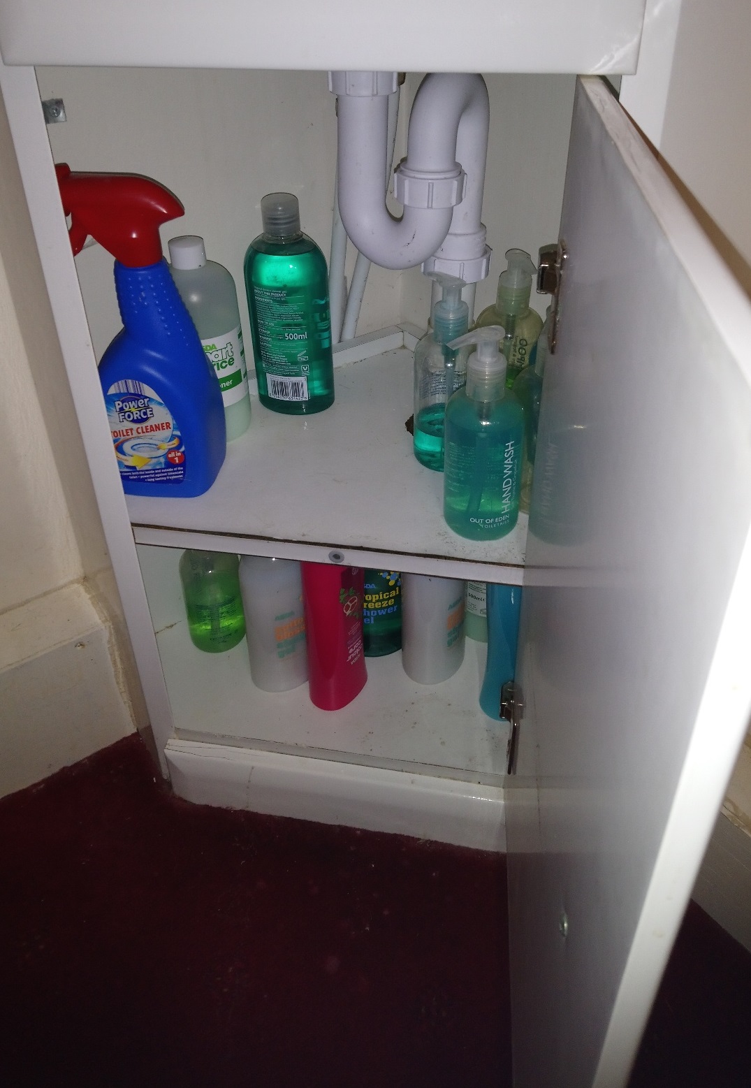

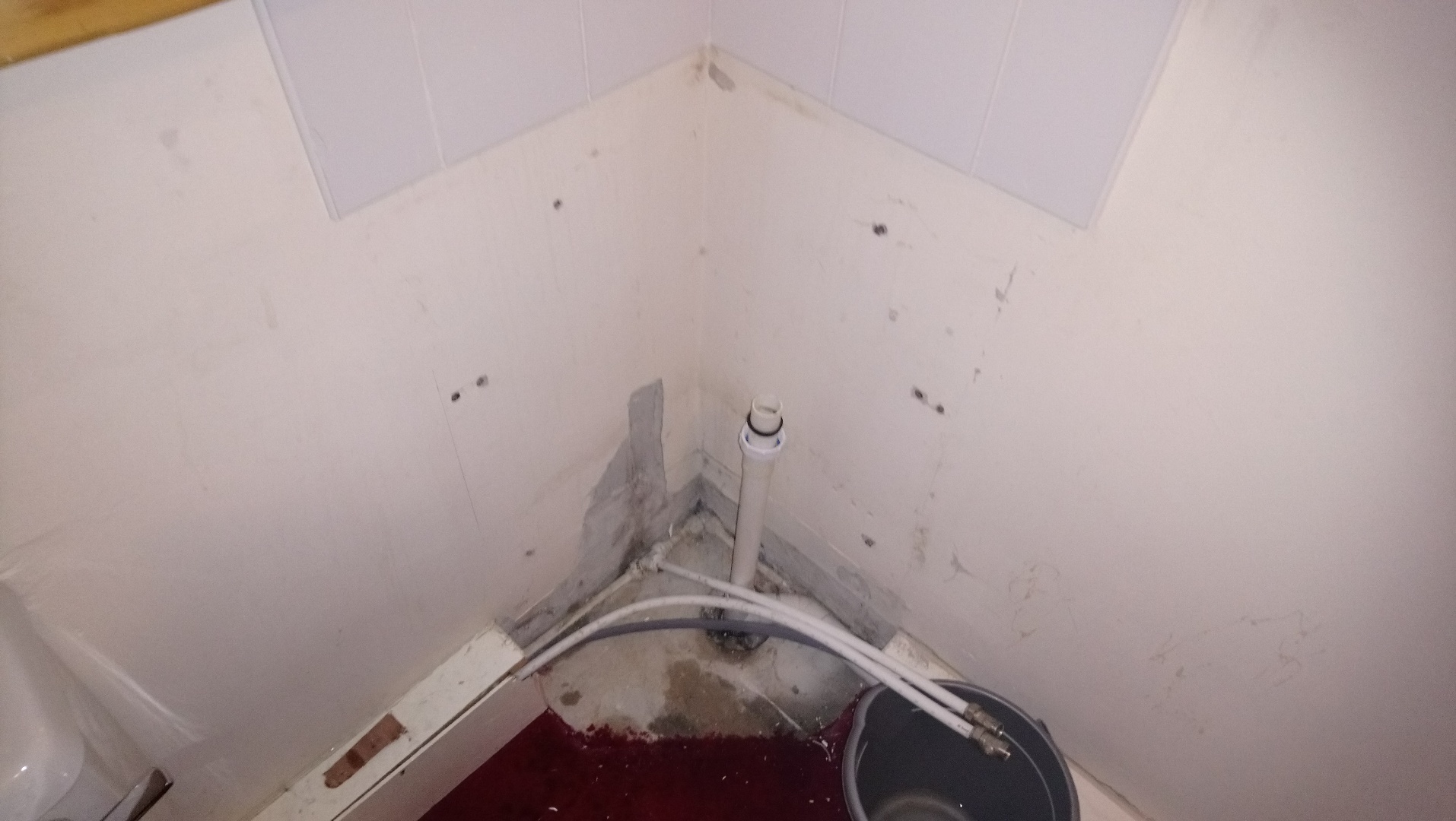

I've managed to hoik out the old basin and cabinet. I thought that's all it was but it was like shifting the Empire State Building. Perseverance won out. Here's what I have now...
The waste pipe is gummed togther with solvent and it's rock solid. The O/D is 37mm.

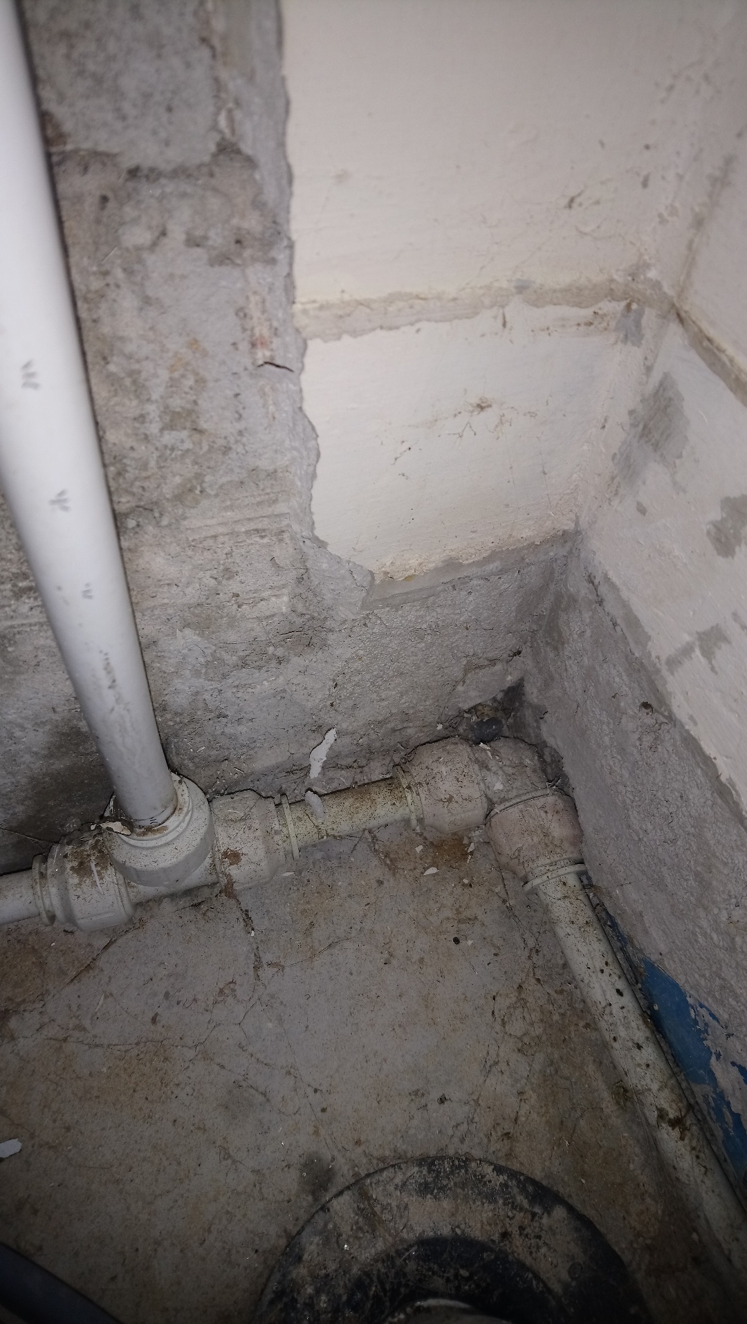

Closer look...
The R.H. pipe ambles off down the pipe box to the electric shower so it must be the cold. The hot comes in from the left and is attached to a copper feed pipe.
