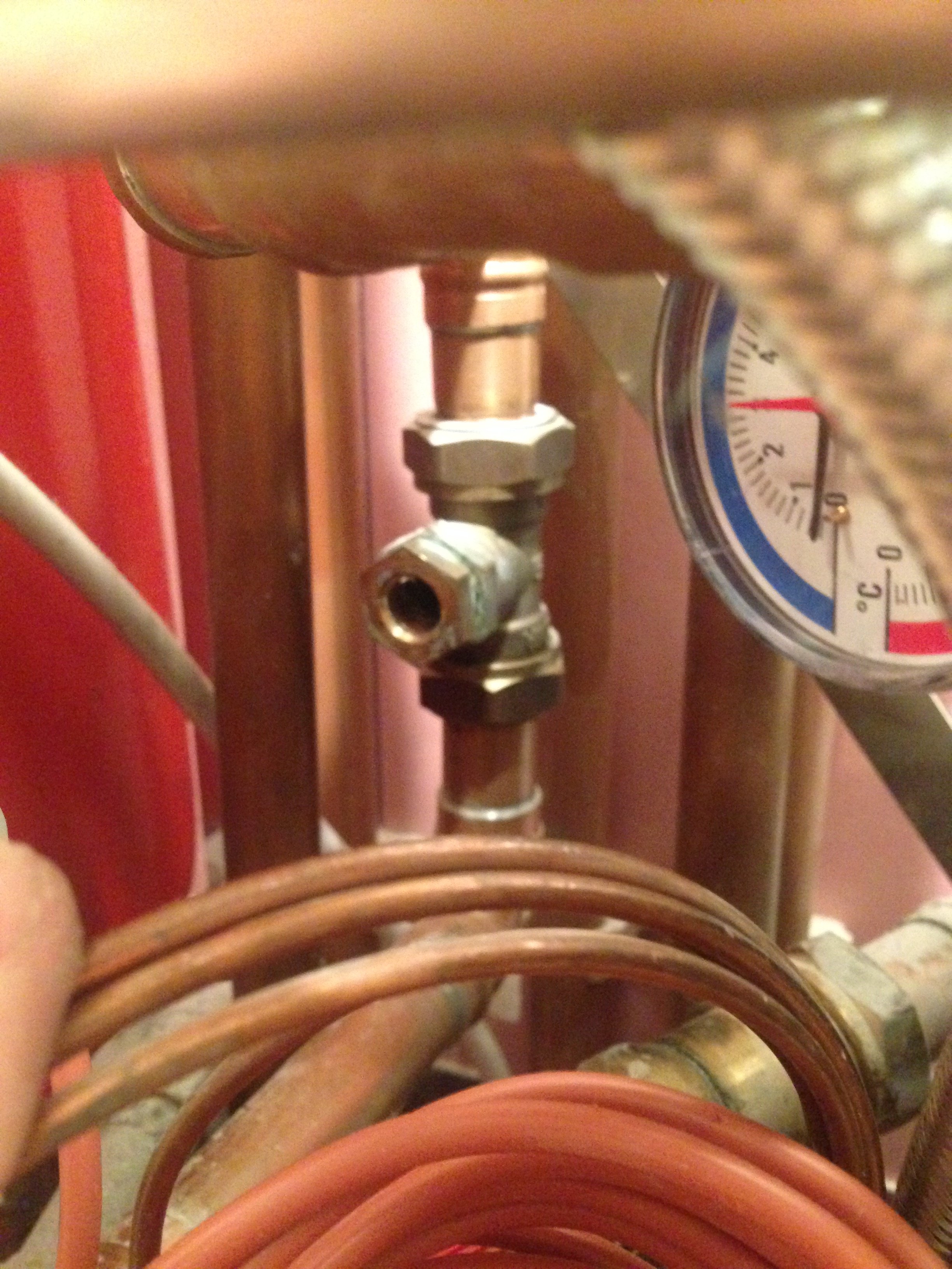

hi guys my customer broke a part which is a dry temperature pocket on a 22 mm compression T
Where can I get that today ?
No where round me temporary use a 1/2 cap end as it looks like a 22-1/2 t
I know, if I cannot get the pocket I'll need to cap that off with a 1/2" stop end
Any local bss or trecra to you that's the only place I can think of

take the temp of the flow or return or what ever you want
its called a dry pocket thermostat housing
Ahh cheers, so you open it and pop a probe in the dry hollow brass rod part?
yes like this into something like a female iron t or coupling etc

This is a separate device that measures flow. It is nothing to do with the gauge or fitting you showed us? How was we to know that the flow meter was fitted from your pictures?
I have never mentioned that I replaced the part Shaun has showed you?
I did mentioned from her very beginning as wel as pictures. I did tell that I will be a dry pocket for the sensus sensor
