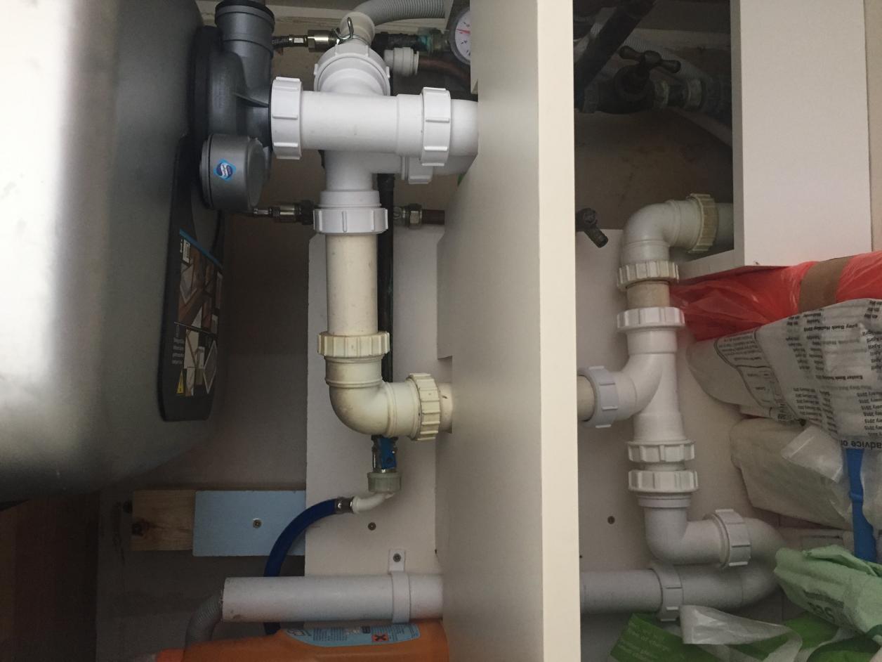

Help! I need some plumbing advice. 2 weeks ago our kitchen sink filled up with dishwasher water and wouldn't go down. After plunging (did not work, and broke the seal of the plug) and removing the pipes under the sink and putting a 6ft snake/spring (no blockage found) it was draining again. Then a few days a go it filled up again, not with dishwasher water, along with the downstairs toilet sink. I released the pipes and it drained again. Everything was working again until this morning and both sinks were not draining. Released the pipe below the bathroom sink and they both drained (no blockage). Any ideas how to fix it?
Moved into the house 3 years ago, redone kitchen in February (not much change to pipe work, done by brother in law) only just start having this problem. Advice gratefully received!
I have no idea what that is, but here is a picture of the pipes under the kitchen sink.
And the sink isn't draining.
Lift the pipe from washing machine U bend to ensure 1:40 fall along pipework, in direction of flow. From photo there appears to be a backfall , and this will be source of airlock at elbow.
(The fitting to right of photo, immediately before waste disappears vertically from sight).

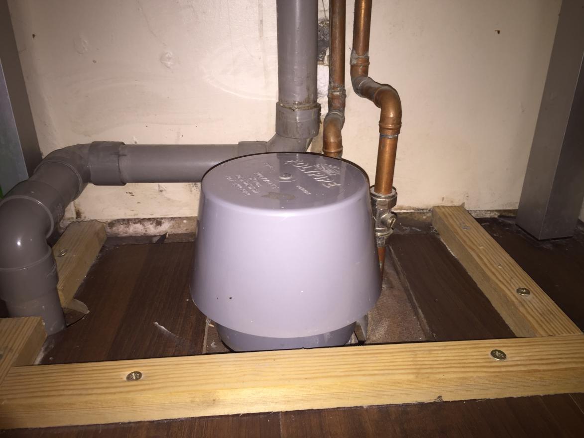

I have tried to get it off but can't. It is just above ground level. About the size of a side plate.
Photo shows AAV. Should be higher than sink, not at floor level, so needs extending upwards and boxing in. Top should lift out of pipe. If drainage OK with AAV removed then clean and ensure internals free to move before replacement.
I think this air vent is for downstairs. I don't think the sink above is connected to it (this sink has no drainage problems), only the downstairs ones. I'm still trying to work out the pipe work, 3 years later! The house was only built 1995.
