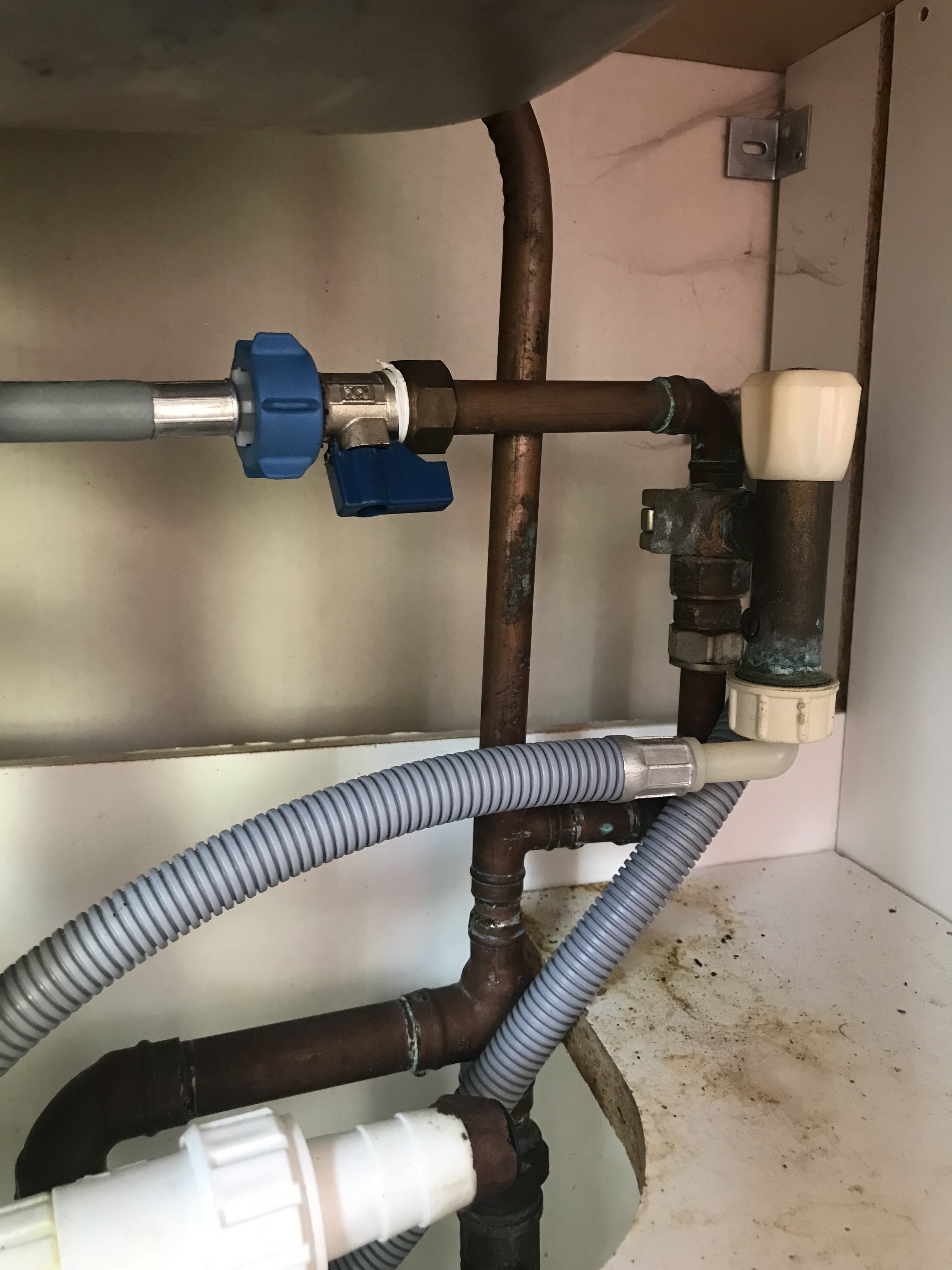

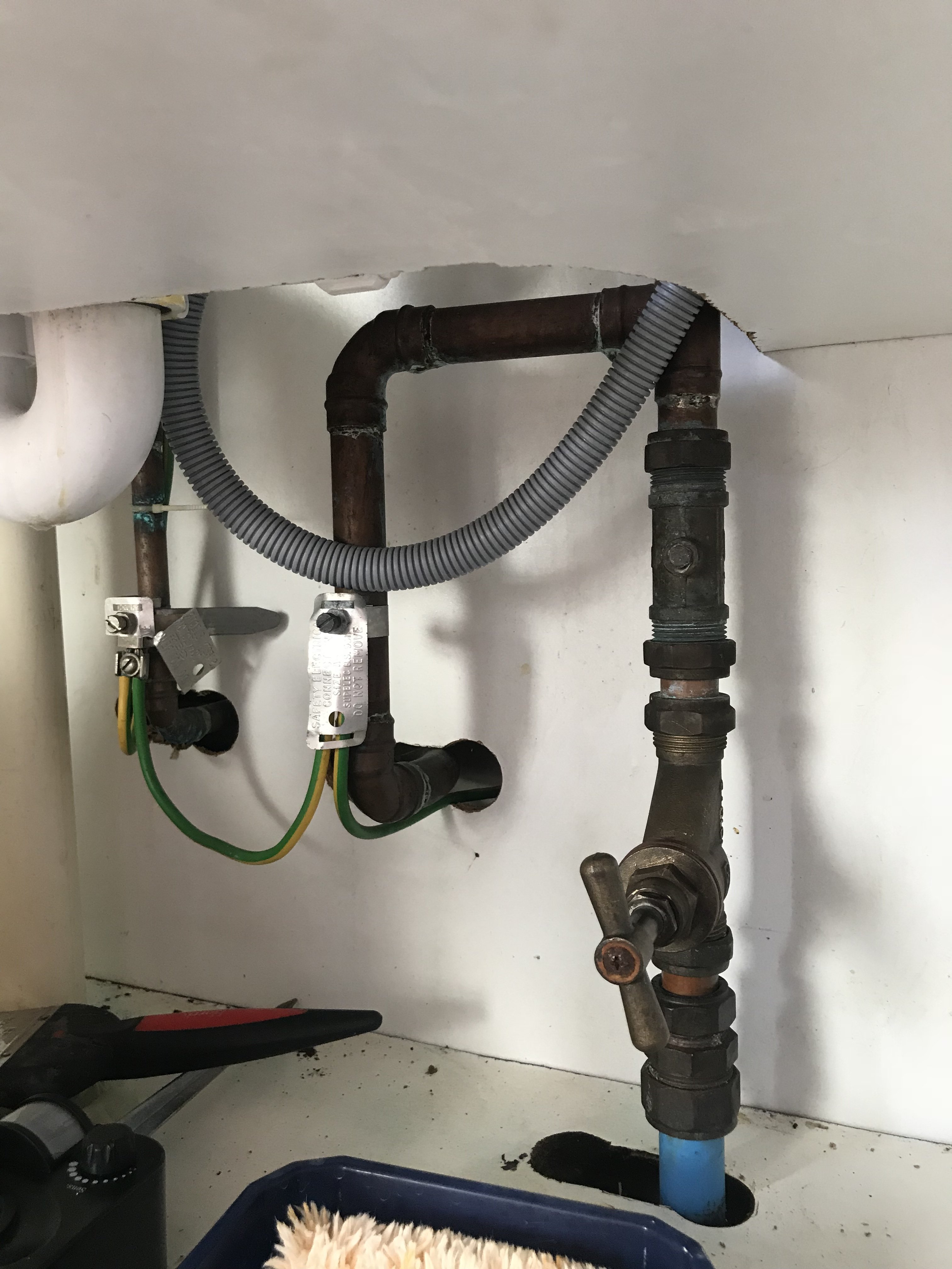

That’s a few pics uploaded of under the sink, and there is a check valve above the stopcock as you will see
If I was to replace the stopcock and check valve to try and eliminate the problem, would there be enough room in between the pipes to remove and re fit? Just think it looks a tight fit that there would be no room to remove check valve and stopcock once nuts loosened without having to pull on some pipes? Thanks
Hi mate there will be enough play on the pipework to change both the NRV and Stopcock you can get them from any screwfix branch . Cheers kop
Remove the check valve and hammer the internals out of it then refit. This will help eliminate the valve as your problem and can be properly replaced at a later date.
