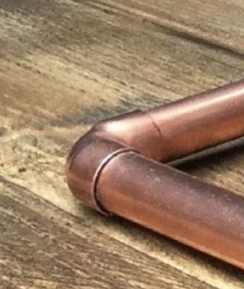

    Hi plumbers, I am popping here today to ask how do I solder a clean join? For example I am currently in the process of creating a lamp for my living room out of copper pipe. I started to solder today and realised I'm crap :smile5:. I cleaned the pipe and the elbows and fluxed, but no matter how hard I tried the solder went everywhere and I ended up with proper messy pipe joins.

    Use the flux sparingly and only a small amount of solder, you only need to hold it together it's not water tight you're after is it !
    Use propane, lead free solder warm the fitting and tube, allow the heat of the metal to melt the solder, NOT THE FLAME.

  6. Electronurd
    Electronurd Member
    Here is a sample join:
    I'm not embarrassed, would just love my joins to look better than the above.
    I'm using a butane gas torch.. cheap. Lead free solder and flux with some pipe cleaning paper.

    Sounds like you need to heat the fitting more as the solder should suck into the fitting
    Clean and flux both (pipe and fittings) once assembled wipe excesse flux off
    Heat from front add solder from the back about 1mm (length) of solder should do

    It does suck into the joint. I can see it doing that, but I'm also using 3mm diameter solder is that too much?

  10. ShaunCorbs
    Yes doesn't need to be much as its not holding anything just a physical connection

    Finally see the guys video. He seems to use tons of flux and just barely touches with the solder wire. I think that's where I'm kinda going wrong as I'm leaving the solder wire on till I see it coming out.

  24. Last Plumber
    Last Plumber Plumber GSR
    Once it's at the right temperature you only need to touch it and you'll see it flow.
    The reason I said use flux sparingly was because you do not want to allow solder to run on the pipe outside the fitting. If I were doing your task I would flux inside the fitting with a flux brush and put just enough on the pipe to cover the length of the full socket.
    If poss, try to solder with gravity on your side !

  35. Electronurd
    Electronurd Member
    Well no matter how much I try I still get a slodge of solder somewhere on a join... without fail. Can solder sledges be wiped off?
    Here is a picture of what I mean... there's always a splodge. The join is fine... but the slodge is annoying.
