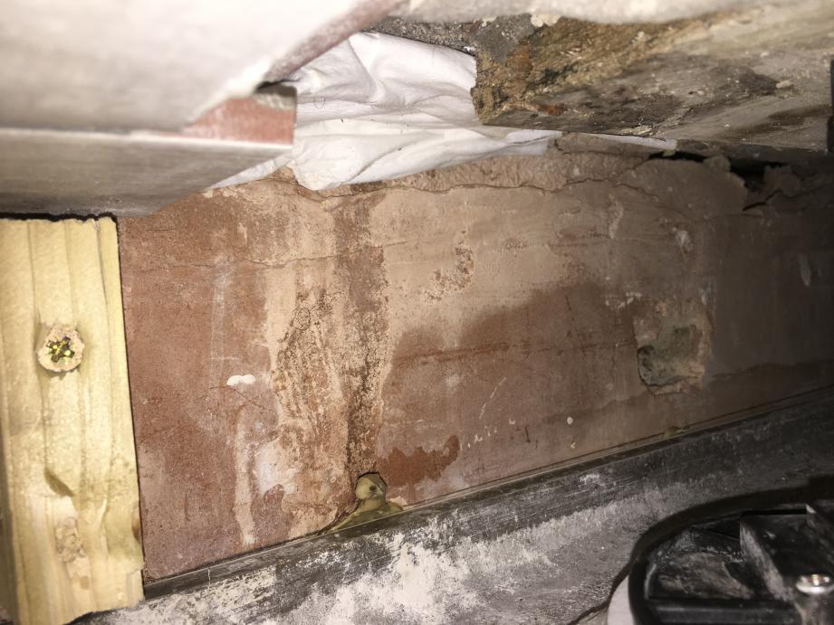

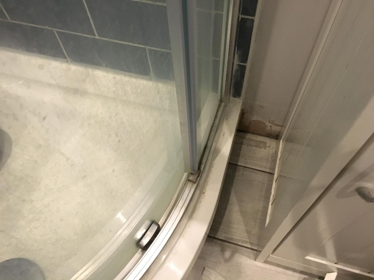

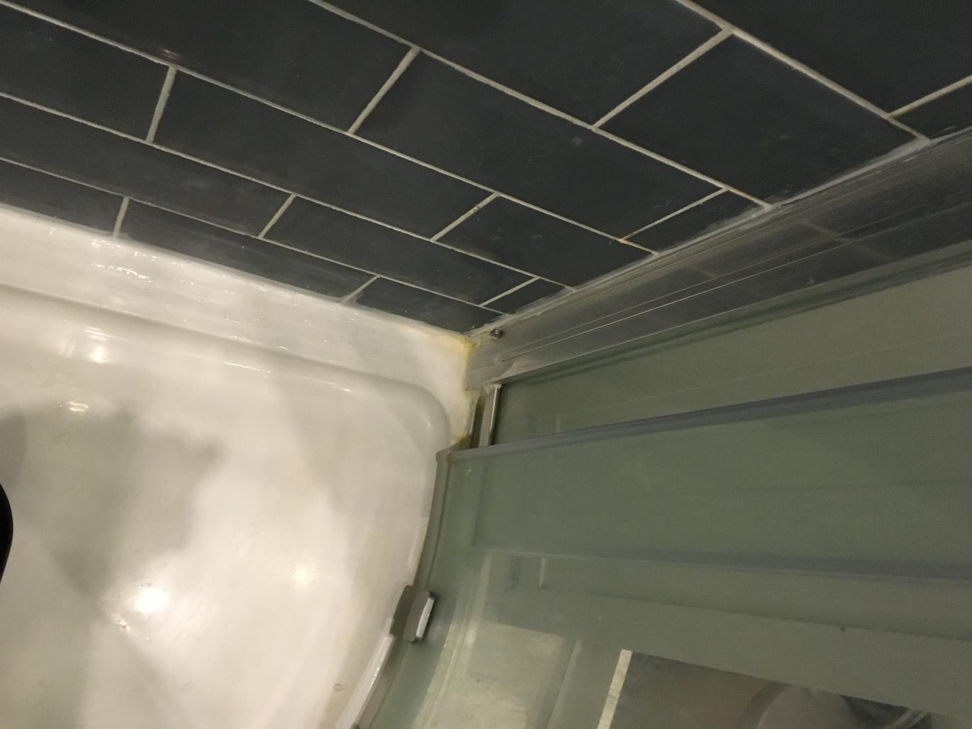

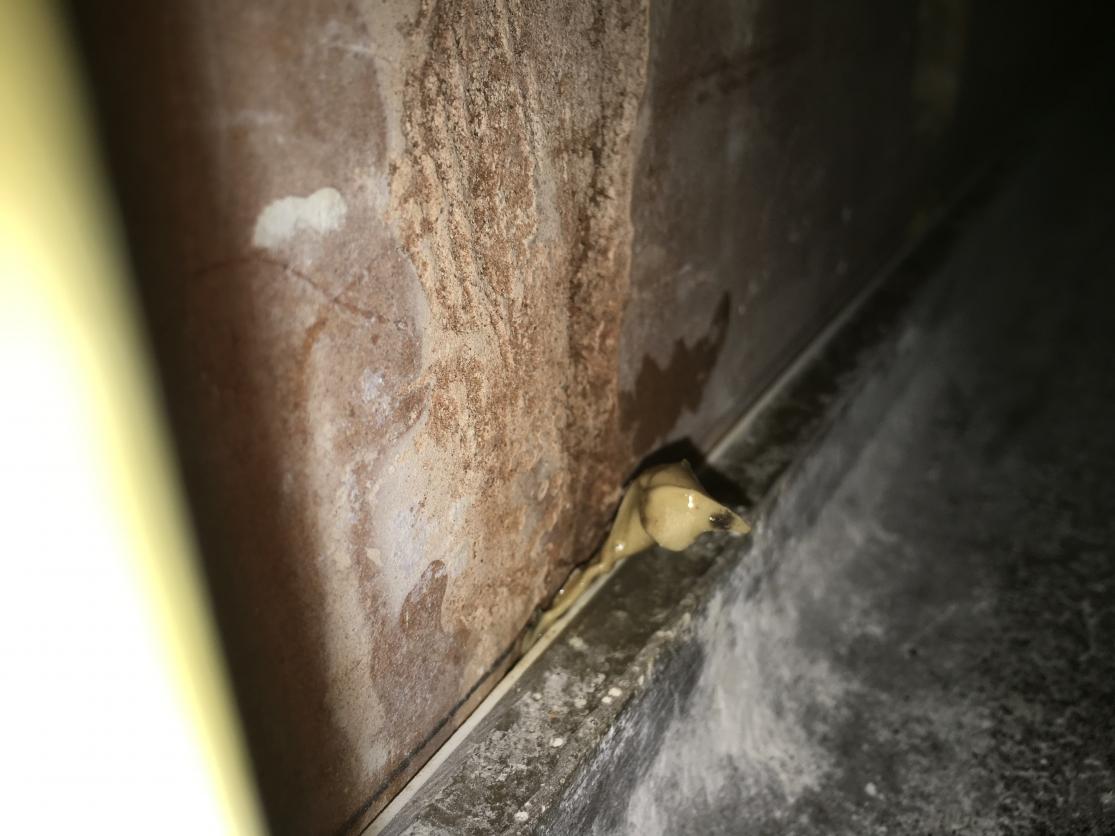

Hello, I had a new bathroom installed 18months ago, I have since discovered a leak under the shower tray. We are getting over half a pint of water from it per week.
Its very weird because it appears to all be sealed, and the drip is coming from a bit of filler between the tray and tiles.
I'm going to attempt to add photos to illustrate what I mean.
We have recently resealed the titles and its still leaking, so any help or advice would be gratefully appreciated.

I can't understand from your wording where the water appears from, but a few things to note, - shower doors are generally supposed to be not sealed on the inside along the tray. They are a basic frame and water will enter the frame to some extent and needs to get out again. If it all has been sealed up then the water can build up and get to the outside. The profile against the wall is always critical to be sealed on the tray to tiles horizontal part.
Usually doors MIs say seal on outside to tray and inside vertical profiles plus 150mm from tray vertical outside.
Also watch that the tray isn't moving down from the silicone seal when you stand in it to have a shower. The silicone can be stuck to tray but releases from tiles if tray not supported well.

I'd check that the tray has been sealed behind the frame, I've had a few instances where people have sealed the tray and frame at the same time so you end up with an unsealed gap that you can't see behind the frame
poorly installed tray relying on one silicone bead is the normal issue, no upstand on tray is the commonest reason for leaks, I always use an aqua seal tape if there isnt a tiling upstand nowadays
Pic 2 seems to show tray edge poorly supported by timber offcut. I would say possibly not installed iaw M.I's.
Also as mentioned if the tray is poorly seal & poorly supported then best to take out and do properly.
Have had quite a few jobs recently where shower tray was poorly installed/sealed so straight away not a good start.

IME most leaks are through gaps in tiles. The gaps in question may only be 0.1mm wide but because there are invariably 3/4 linear meters of them they total up to a substantial hole.
Tap the tiles with your knuckles. A well stuck tile with simply 'thud' - the best place to get that sound it up the top normally. As you come down the wall, you will invariably find the sounds changes to a 'clack' instead. This is because there is a gap behind the tile where they have lost their adhesion to the substrate meaning they are held in only by their grout.
When you get a 'clack', the ONLY remedy is to remove the tiles up to the point where there is no more black mould, (normally about 1-1.2m), strengthen the wall so it flexes less (for example replace plasterboard with 12mm TBB), treat with some form of surface prep and re-tile or reboard.
There are NO short cuts if you want it NOT to leak again.
