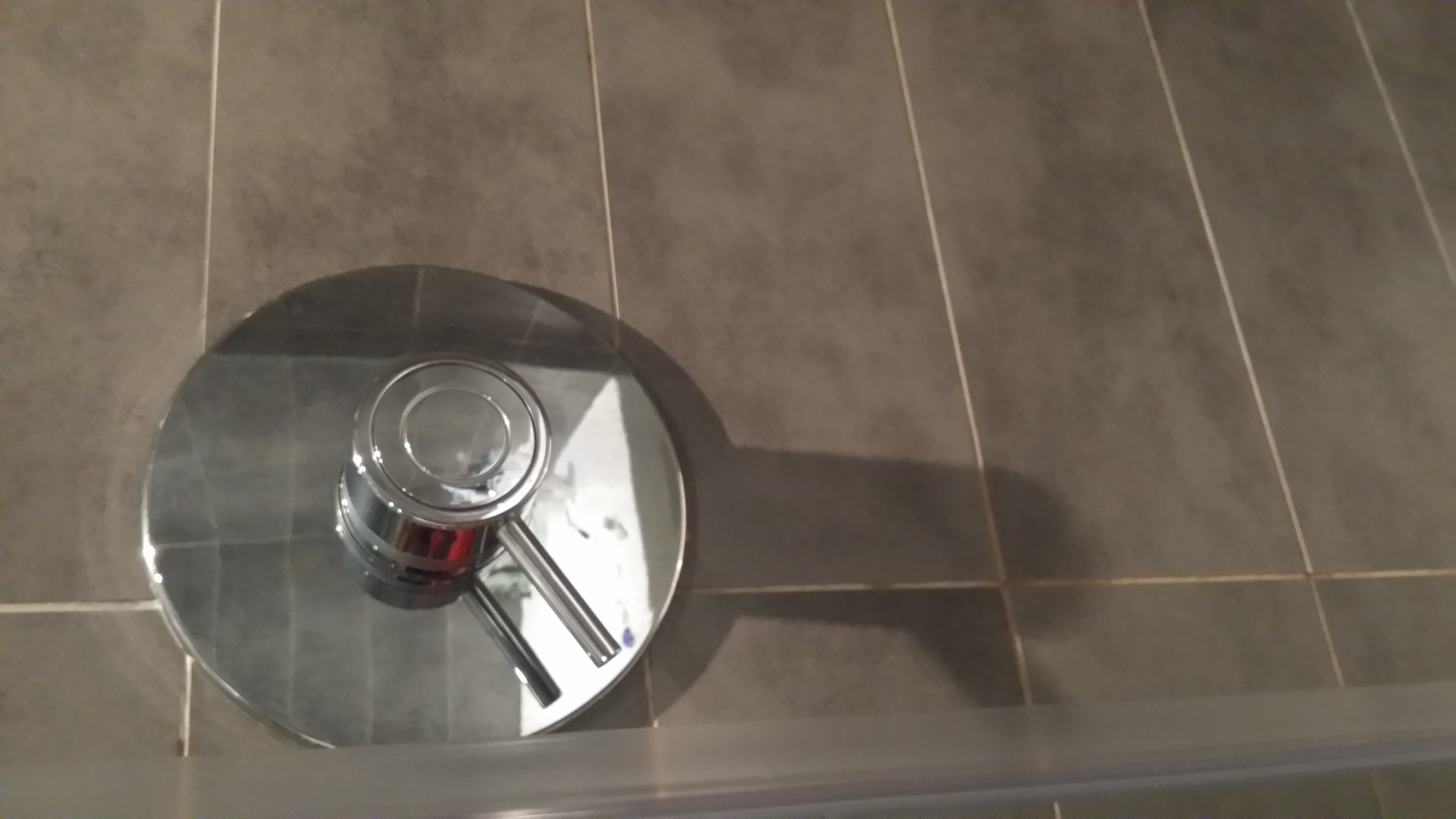

  12. ShaunCorbs
    on the boiler you can adjust the water temp just a thought it may be set low?
    any chance you could take a pic of the boiler?
  13. scott_d
    scott_d Plumber GSR
    Any pictures of the boiler?
    Is water hot at other taps?
  14. Barbara
    Barbara Member
  15. Barbara
    Barbara Member
    After boiler was first installed I had to get plumber back to increase temp. Couldn't have a hot bath. That he did but flow reduced.
    I'm wondering if something as simple as turning stop cock more open if possible might make a difference.
