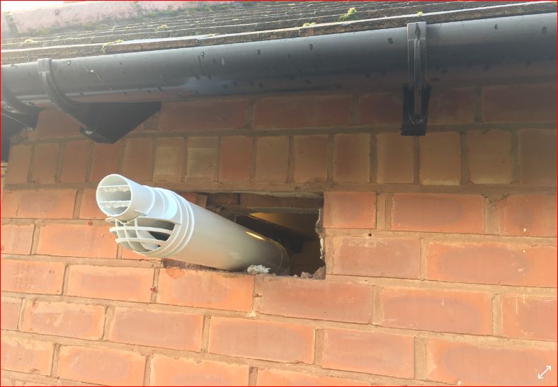

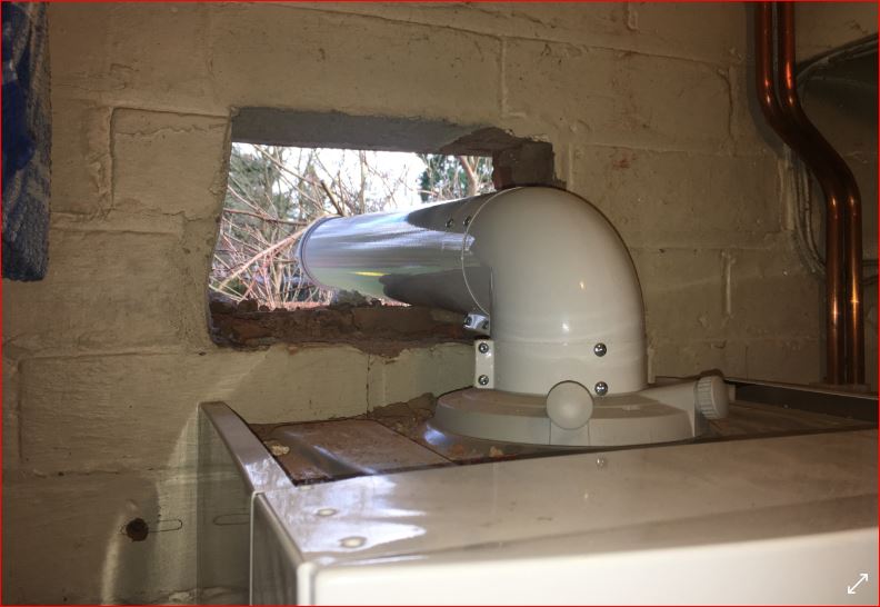

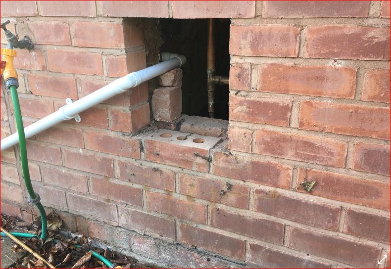

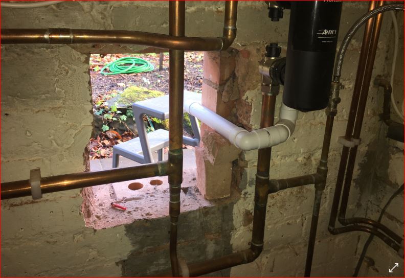

Mother-in-law, in late 60's had a new boiler fitted replacing 1970's one.
generally seems a good install, but where old boiler fle existed at knee height there is now a big hole, with the condensate pipe running through it balanced on a few bricks. Also there was a metal vent high up, (previously air into old boiler?) which the new flu runs out of.
see attached photos.
when i had a very brief call to plumber he said wasn't in his quote and we needed to get a builder in to brick up both holes.
1) is this normal - not making good after a new install. (would you not even mention it?
2) is it actually against the regs as couldn't the flu gases come straight back into the house?
Thoughts and comments please.

no defo not right and its upto him to sort as atm the boiler is dangerous as in point 2
No this is not the norm in fact it is dangerous this needs making good asap. You will recieve a card in with your gas safe certificate when it arrives if you tick the box on this card you are entitled to a free vist by gas safe to check the install i think this installer needs a wake up call tick that box and send it back they will vist the property and go through the install with fine tooth comb , the pipework needs insulating aswell. Cheers kop
Is the boiler actually up and running and been commissioned? Because no GSR would turn it on left in that state, It is dangerous and needs bricking up before it can be used. They should have left the gas and electric to it isolated and an uncommissioned notice placed on it until the brickwork has been finished. If it is turned on and in use then turn it off immediately & phone Gas safe up. They will inspect it for free and any faults will be reported back to your engineer who must rectify all or face loosing his licence. But phone the engineer back and give them a chance to sort it out saying that you will be talking to Gas Safe if they do not sort it out. You have paid for a new boiler install and that includes any makin good unless they mentioned beforehand that you need to get in a bricky at extra cost before they can commission it and turn it on.
Seriously! Give gas safe a call. This clown needs a kick up the a****. No wonder the industry has a reputation if people like that are on the register.
It is immediately dangerous and needs turning off until that upper hole is bricked up. It’s totally shocking.
I’d say if this isn’t a joke then report it. Boiler cannot be commissioned

the holes are currently covered by chip board - the kitchen fitter there at the moment felt sorry for us and did it.
The plumber said he was on holiday, but would come round to discuss the issues later this week. (i had a list of 10 things i want to go through with him!)

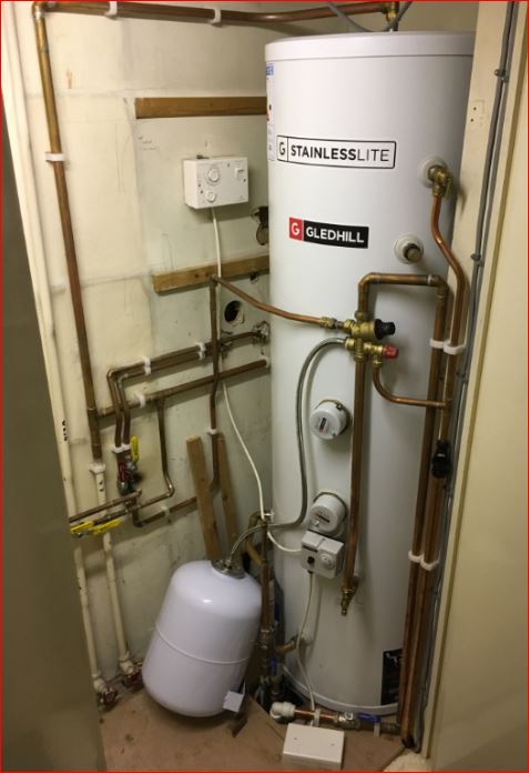

A) well can you confirm the hot water expansion tank also needs securely attaching to something and in the correct orientation? (the walls around tank are plasterboard, but i guess a frame could be made to fix it to?)

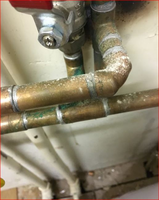

D) is it bad that some of the solder joints seem to have the flux left around them - some are turning the pipe work green already. from a basic point of view it doesn't look nice and anything touching it will get dirty.
I've ask him to visit to discuss how to remedy all these issues and i'll go from there - I'm hoping he'll sort the free of charge.
Correct and if on plaster board walls it needs a piece of 18mm chipboard between the timbers

Phone gas safe up and explain you've had a new boiler fitted and your not happy with the installer as he's left a big hole round the flue etc
Yes and no most don't wipe the joints after soldering warm water and a cloth or sotch bright pad and your golden (cloth will be ready for the bin afterwards)

A. Yes

D. Joints should be wiped clean yes

Rich, if the guy had no intention of bricking up these holes and making good afterwards, this should have been made 100% clear to your m-i-l from the off and be noted on his quote or else the guy is seriously remiss.
If he hasn't, I would say that he is responsible for this and I think he could even be 'obliged' to cover the cost.
When someone gets a quote for such a major job, they expect it completed and ready for use - unless agreed beforehand. So unless he made it clear that he wouldn't be doing the 'making good', I suspect he is legally liable; as the folks above have explained, this install is not ready for use until these holes are blocked as it's potentially dangerous.
So, even if his quote or explanation for the job did mention "sealing and making good around the flue and condensate pipe etc to be completed by others" the guy should have left the boiler capped off/disabled and informed you he'd be back after this work had been done.
If your m-i-l wants to sharpen this guy's responses, perhaps she could leave him a message saying "I've had awful headaches since the boiler has been fitted and am feeling a wee bit sleepy... I've been told I should call someone called Mr Gus Safe..."

the plumber came back without any hesitation to fix most things i'd asked for (including, mounting expansion tank and insulating pipes, etc).
He didn't brick up the holes though. However after another phone call he has agreed to brick it up (hopefully it'll be a decent job)
