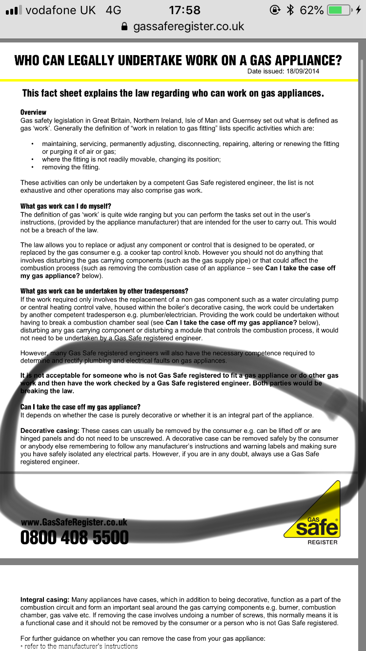

Sorry to disagree with you Gasmk1 but there are instances that are stated on the GAS SAFE REGISTER that specifically state, and I quote,
'What Gas work can be undertaken by other tradespersons'
If the work required only involves the replacement of a non gas component such as a water circulating pump or central heating control valve, housed within the boilers casing, the work can be undertaken by another competent tradesperson eg plumber/electrician providing the work can be done without breaking a combustion seal...'
As I am a qualified electrician and we have checked this with gas safe (see link) I am allowed to do certain jobs...
https://www.User PlumbersForums.net...legally-work-on-a-gas-appliance-factsheet.pdf

So the question is; Does removing the casing mean you are breaking a combustion seal on a Potterton Performa 28?
No, check the link and it states what it is plus I and my plumber have checked on this, they call it decorative casing and it is not a combustion seal... the Gas safe have said to us that I can change parts on the board and a pump, which I have...
A decorative cover is a front panel only. The internal panel you are not allowed to remove. The pump and pcb you mentioned are indeed behind the decorative panel. (So I believe) however as the stats are there for SAFETY you are not allowed to change them and need a qualified Gas Safe Engineer.
Down Tiger, I have that link on cut & paste so no need to read it.
My point was does it apply to your boiler and for the record I don`t do Potterton`s so I don`t know ok?
But they don't regulate the gas side so if the work does not involve 'disturbing any gas carrying component or disturbing a module that controls the combustion process', then we could argue that, from a gas point of view, the OP is fine. Whether he may fall foul of some other law is another matter.

1- The key is in the name, A SAFETY DEVICE
2- He also had to loosen the 2 x screws holding the outer case in place. He then lifted the outer case off the boiler. I wasn’t going to be picky about this as he hadn’t removed the inner case.
but they do regulate the gas side the thermistor through the PCB modulates the gas valve and the overheat thermostat shuts of the boiler and as pointed out they are safety devices.
The point about screws was an example, not an absolute. The critical point is whether the casing ' forms a part of the combustion circuit' or not. So a Main heat only boiler has a decorative casing from a gas point of view, but it is an electrical enclosure.

The key is in the pdf who is allowed to and the part about non pressurised areas...
I do keep on this issue as the outer casing is not screwed (it slides up and away) nor does it make a seal and there is no internal panel.
As we have checked in the past with Gas Safe as per the regs in regarding my particular boiler and been given the okay on electrical and non gas seal (pressure) areas as per the examples shown on the Gas Safe pdf (I have tested and repaired the PCB in the past) I'm not even sure why this debate on the guide lines is persisting, it clearly states . With that okay from Gas Safe, and they pointed me in the direction of the pdf guidelines, as a qualified electrical engineer I am allowed to do certain jobs not involving gas seals.
