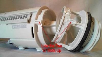

    Second, if it's only a 1/3 or 1/4 turn then I'll have a go at that. I did play around with various amounts and didn't quite find a point that it would release. I did find this image and was wondering if I needed to line up the "tabs" to release it and I can't get them to line up because I can't turn it sufficiently..

  8. rpm
    Thinking the tabs line up when it's in the fixed postion.
    See that cut out below the tab on the Base section that's the postion to twist the top section to.

    Thanks, I'll try rotating it again and see if I can find a position it will release...
