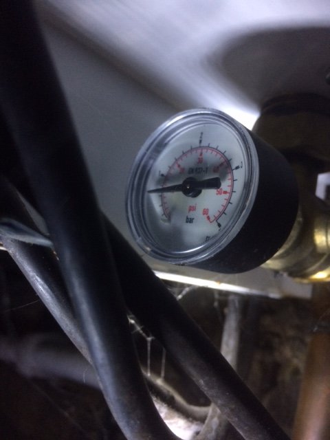

Over the past few weeks we have noticed that our hotwater hasn't been red hot, instead only luke warm. Additionally the radiators would turn on and off intermittently.
Today we've woken up and found an F1 error code on our iMINI 24 combi boiler. I have looked up the meaning of this code, and it suggests that the boiler has low pressure. I have checked and confirmed that this is the case, the boiler has pressure under 1.

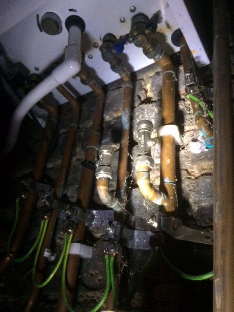

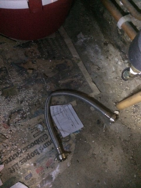

I have read that what I now need to do is to re-pressure the boiler, and to do this I should use the filling loop. The problem here is that the filling loop on my boiler is not attached to any pipes at either end.
I have attached some images to this post, would anyone be able to assist me with the steps i need to take to attach the filling loop and re pressure the boiler? I've never done this before so any help would be appreciated on this cold cold morning.

Take the two top nuts off and put the filling loop nuts in their place. The ends of the loop push into the ends of the two valves. Open black lever quarter turn and close when the black needle reaches 1 ish, bit over won’t hurt, sat 1.2 bar.
Disconnect loop, replace nuts/ caps, (if that’s what they are),
Don't forget to tighten the filling loop nuts onto the valves
Hand tight will be fine
Thanks both. I'm struggling to get the nuts/caps off at the moment, I assume if I find the correct socket wrench head size it should suffice?
Use an adjustable key/spanner.
Hold back with something else like a pair of pump pliers
Thanks all, I have re pressured the boiler which has fixed the hot water issue. Your help is very much appreciated.
