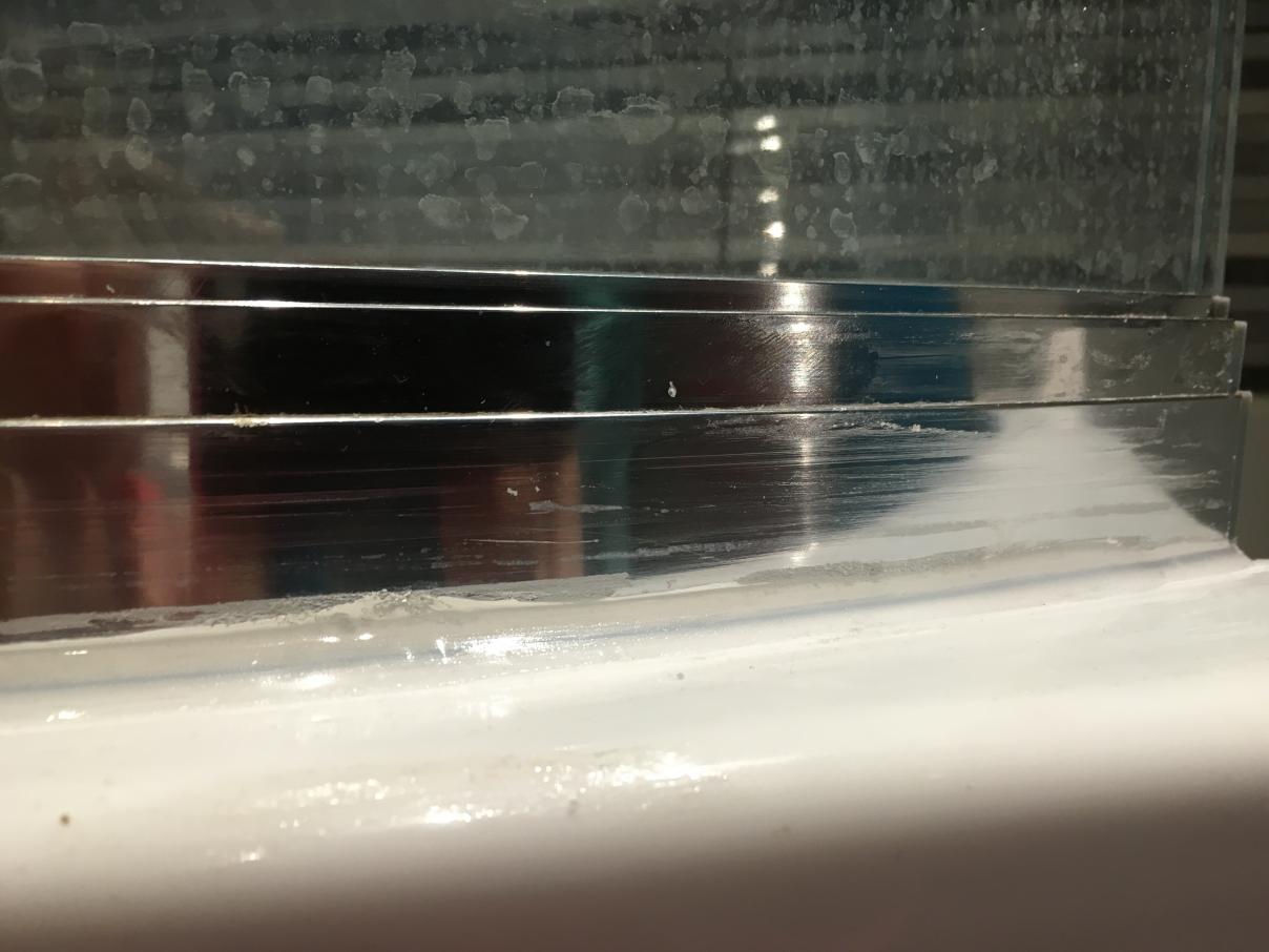

Quite a lot of silicon around!
In pic 2 bottom left it looks like old scale/leak discolour. Pic 2 top right ish looks like the chrome enclosure isn't new.
There is a lot of silicone but imo £1400 isn't a lot of money. He's spent half that in silicone ! Only joking
Back to the point, the tray & enclosure aren't new.
What the plumber saying then?
Look at that flexi it's bent 90 right on the fitting

The op supplied larger items - as I said to me from the pics supplied they don't look new.

How do you explain the rusty colour stain on the bottom left of pic 2. That's a stain that won't occur overnight.

The point that Rocket was making was pertinent. The photos look like they are of quite an old installation. Has this dispute been going on for a long time?
I don't like slagging people off, but that's **** poor work
That flexi looks like a 1/2" x 15mm comp, with the parralel thread of the comp end being used as 1/2" MI
From what you've shown, I doubt I would pay either
If the tiles are loose as well, it would be better to strip it all out and start again
Work started on the 7th December this year the last visit was on the 21st December when the second leak started.
I'm worried your thinking/seeing these as used or old parts, everything is brand new.
