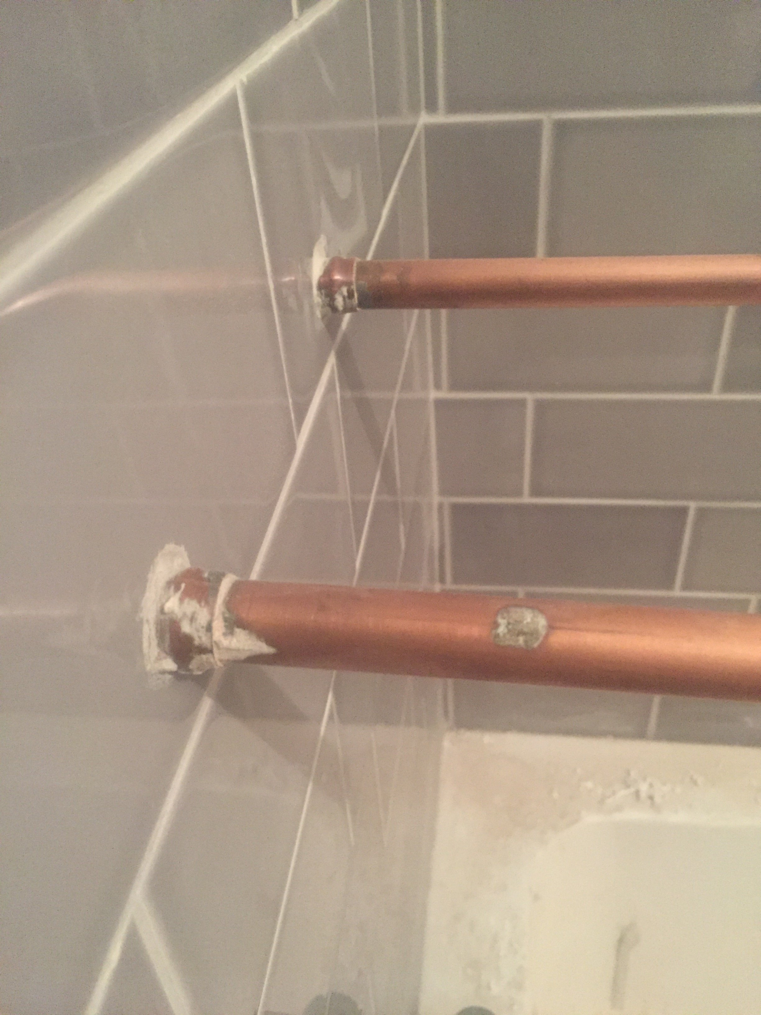

Had a plumber run some pipes for a bar shower, I’ve since plastered over them and tiled the bathroom. When he’s returned he can’t fit the shower because the 15mm elbows are protruding from the face of the tile.
I’m looking for a suitable shower fixing kit, if available, that will help us get round the problem so I don’t have to knock the tiles off and chase the wall.

guess the copper pipe in the wall is touching the back of the tiles?
Gutted!
Just sitting proud of the finished plaster ever so slightly, had to chase the back of tile over vertical part of elbow. Didn’t think it would be a problem as didn’t really know how the shower fitted to pipework.
Cheers for getting back to me.
Will I be able to just chase the brickwork above the bath and ‘tease’ the pipes back? Surely I won’t have to remove the bath?

No don't think you will have to remove the bath and yes the pipes need to be level with the brick so that the elbow isn't going past the back of the tile

However if you know an engineer who could use a lathe or milling machine it would only want a small amount of brass removing to the depth of the fitting.

You can get them from all plumbers merchants, a conical cutter wouldnt work , if you know one its a very easy job for an engineer
