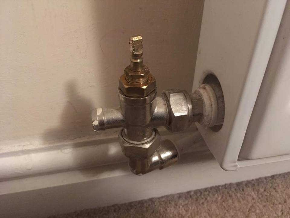

    This is the check valve on the bedroom rad... It wont move at all trying to turn the flattened shaft at the top.
    On a separate question.. how do I drain the system using the drain cock on the side without it pouring all over the carpet? Theres a square valve inside the drain. how do I unscrew that, if theres a hose connected to the outlet?

    Is there a valve on the opposite end ,I hate and dread those micro bore systems havent seen one in years or know any plumber that fits them now as far as I remember that is not a drain off it was a return someone here will recognise that valve more good luck

    Get an adjustable spanner on the spindle sticking up in the air. Clockwise is off/closed and anti clockwise is on/open. It is called a drain off lockshield valve. If you turn that valve off and the valve/thermostatic radiator valve on the other end off, then put a small tray/bowl underneath and remove the square screw from the drain off part with a radiator bleed/vent key (a little water will come out so do it slowly so that you know the valves are holding) then attach a hose pipe to the valve and to a drain outside. Open both valves back up and the water will drain from the system if the drain is downstairs.

    The other end of the radiator has the TRV fitted. This looks like a drain off, having the push on hose type fitting there. Every rad has the same thing, upstairs or downstairs. I guess the spindle is just seized. I'll try again with a little more effort.
    It makes sense now. Closing the valve will drop it below the level of the drain, allowing me to remove the plug from inside the drain. Opening the valve up will then let the water out.
