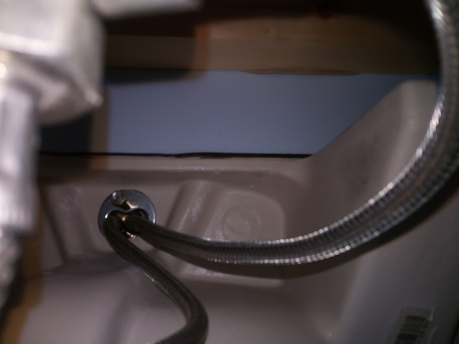

I've seen Deva NCT001 Non Concussive Pre-Set Basin Taps at £30 a pair, so actually over £100 less than the monobloc tap. I'll attach pics of the underside of the tap fitting,

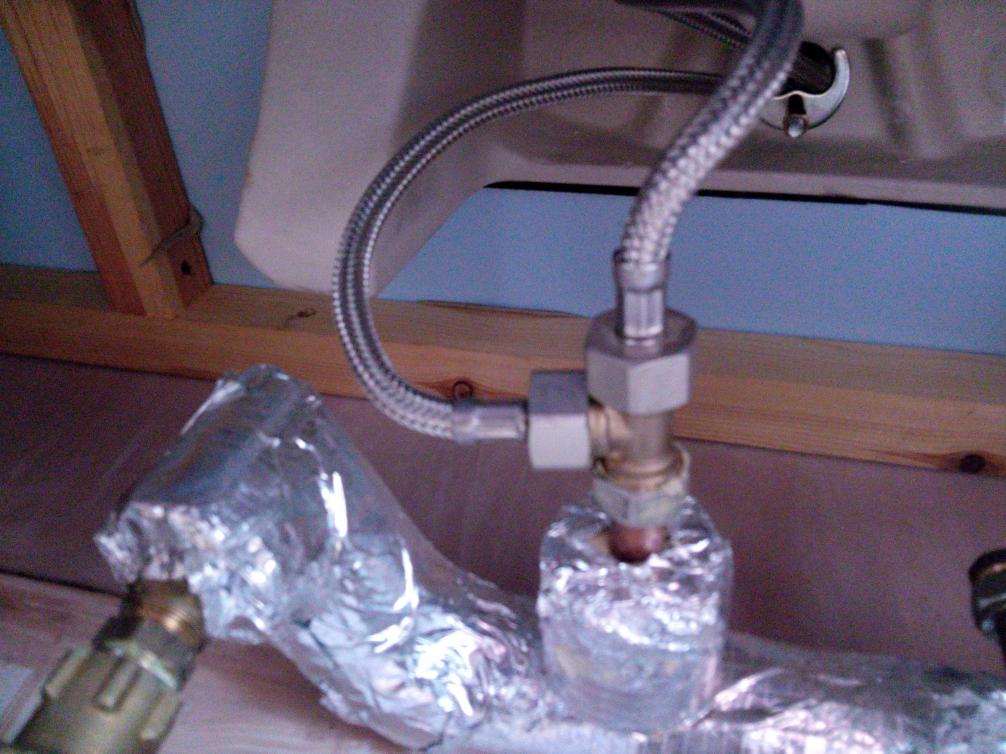

Then there's the T piece creating a twin feed to the mixer tap, from a pipe coming from the TMV

Hope that explains a little better?

I've included some pics in an above post, but these taps, as far as I understand are mixer taps, but are being fed (both hot and cold feed) by a TMV that is then split into two feeds from the same source (TMV)
Did that make sense?
