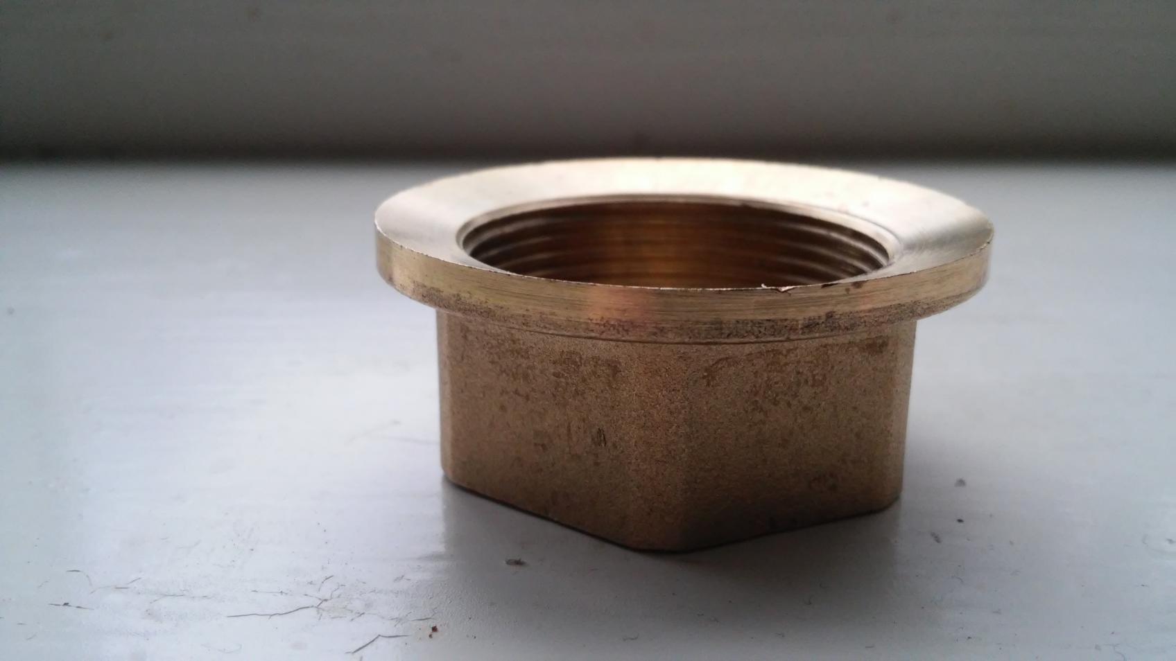

  2. The "mating" surface of the big brass nut is not flat, but rather slopes at about 15° from the outer circumference towards the inner. (Not easy to describe so I'm attaching a photo. BrassNut.jpg) Do you still advise the "poly washer"?

Forget galv steel it will rust. If necessary cut stiffener from brass push plate (door), also easy to cut hole in brass. Polythene washers obtainable from plumbers merchant or make own from side of 4 pint milk container. Principle of poly. washer, to stop rubber washer rotating during final tightening of brass nut. Smear of silicone between brass plate and SS sink will,once cured, add stability to base of tap by resisting rotation.

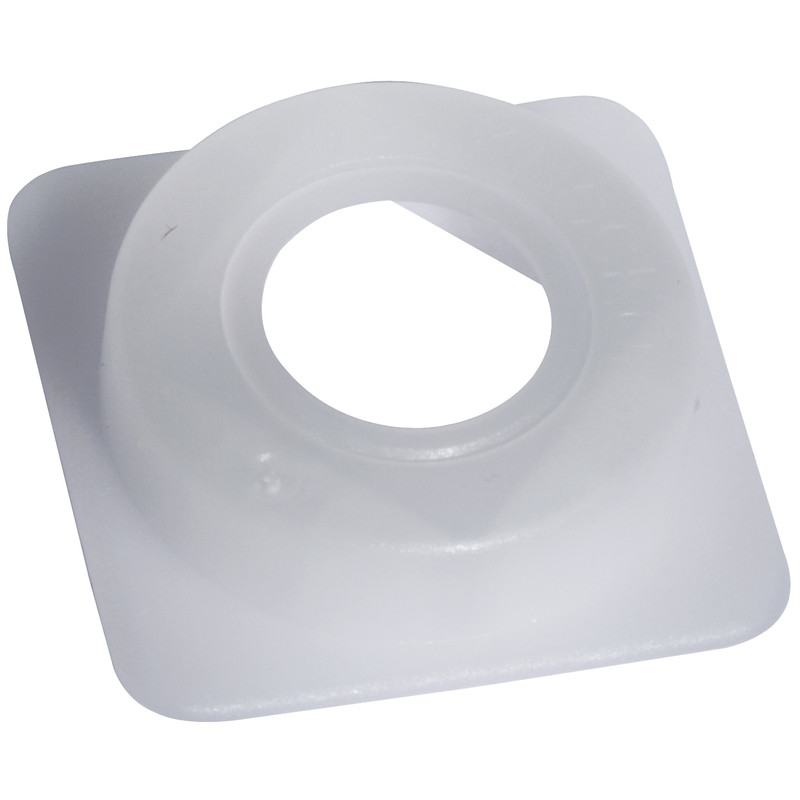

You can buy a plastic 'brace' that spreads the load over a greater area for this type of eventuality. Many decent tap suppliers supply them as sinks are like Fords now and made of tinfoil :eek:. I'll try and find a picture.
You mean the triangle support bracket / washer
