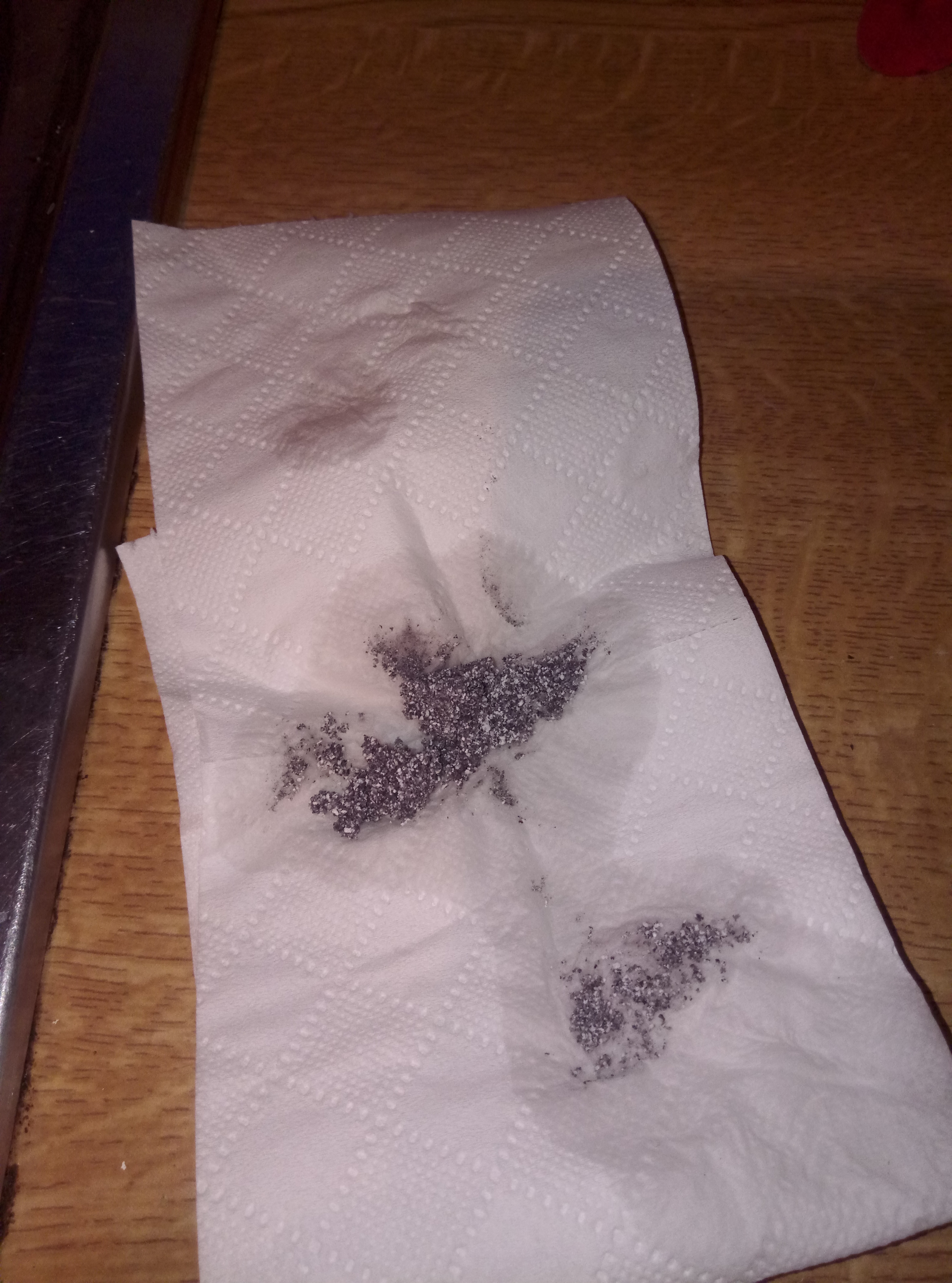

Was at a job where the guy reported that his boiler was making a loud vibrating noise when using the hot water, took a look at it and the boiler display was saying
Pump over run and
Fan post purge
Took the condensate trap out and found both the trap and the little rubber feed on top of the trap was full of silt. I emptied it out and cleaned it but i was wondering what would cause such a build up could it simply be due to lack of servicing? I suppose my main query is where would it come from, thanks in advance for any advice
In short there alu particles from the cast alu heat exchanger and boilers with alu heat exchangers need to be serviced every year
It's from the heat exchanger, nothing a good wash through won't hurt.

Its normal bud they need flushing through on the yearly service i use a pump plant spray stick 3-5 litres of clean water through the heat exchanger from the top , you can flush the sump through with it to then clean the condense trap job done.
