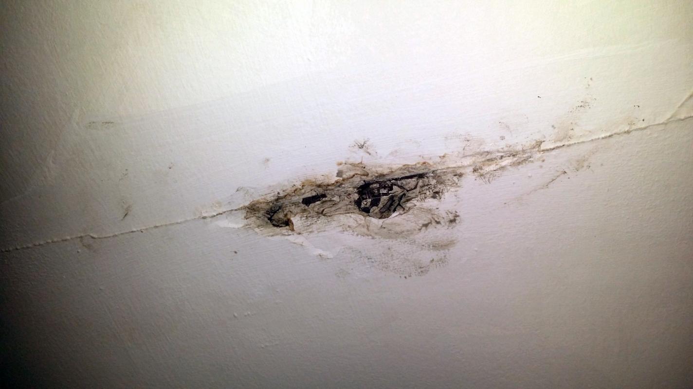

I've found this on my living room ceiling...
The scaggy black area is about a foot long, and is ringed by a very light brown stain about two feet in diameter. This has developed over three months or so. The central area is mushy but the surrounding area isn't squishy.
I first thought it was due to my having a small fridge upstairs, which may have been leaking in the past. However, there's no sign of leakage, and moving the fridge away for a week hasn't resulted in any apparent drying out.
There isn't anything in the waterworks department directly above the stain but I suspect it may be on a slightly low point - it's certainly on a join in the plasterboard.
Upstairs, there is a combi boiler around two feet from the stain. There's also an en suite bathroom, whose wall is five feet fron the stain. There's no evident leakage anywhere. Also, there seems to be no problem with boiler pressure. Now for the snags...

Floor will have to come up upstairs or cut a hole in the ceiling downstairs to find and fix what's leaking end of story. I would start by looking for the leak in the bathroom, removing panels, trims whatever. Has to be found and fixed properly.
is the silicone around the shower tray damaged/not sealed any longer? signs would be if its getting black patches, if the tray is against a stud wall and/or not sealed to it then the water will syphon down the side and onto the floor. If the tray is on a riser kit and you can see under neath then spray the head against the silicone and watch underneath
Leak from boiler condensate pipe or other pipework
Ceiling has had it now so I would just be proactive and cut out a section of the ceiling and investigate from there.
I wouldn't use a leak sealer in the central heating,
Remove the ceiling till, you find the leak, the ceilings had it and will eventually fall down anyway so save the mess and do it now with dust sheets down

I can rule out the shower tray because the shower is over the bath - and I know the bath is sealed, and using it doesn't make the wet patch worse. Ditto the condensate pipe. this is definitely sealed and passes outdoors immediately behind the boiler anyway.
My general plan is to take out the wet patch first, then progressively enlarge the hole until the leak source - or at least its direction of origin -becomes apparent.

There's an outcome, after all this time. The problem was found by my local heating engineer and it's now fixed.
It turned out that the monkeys who fitted a new boiler (under that government scheme thingy) had cocked up.
They'd attached a new pipe to the cold feed and in putting on a new Yorkshire fitting had 'started' the next one
down by overdoing the heating-up part.
It was just a teensy pin hole. Fortunately, the floor in the boiler cabinet and been carpeted with offcuts. The engineer
used his magic recipro saw to take out a foot of floorboard. Then he trimmed the pipes, formed a new bit and fitted it with
those plastic push-on connexions.
The ceiling's finally dried out and filling and stainblock should sort it out for a lick of paint.
Could've been worse and it was a very reasonably priced fix. You win some!
