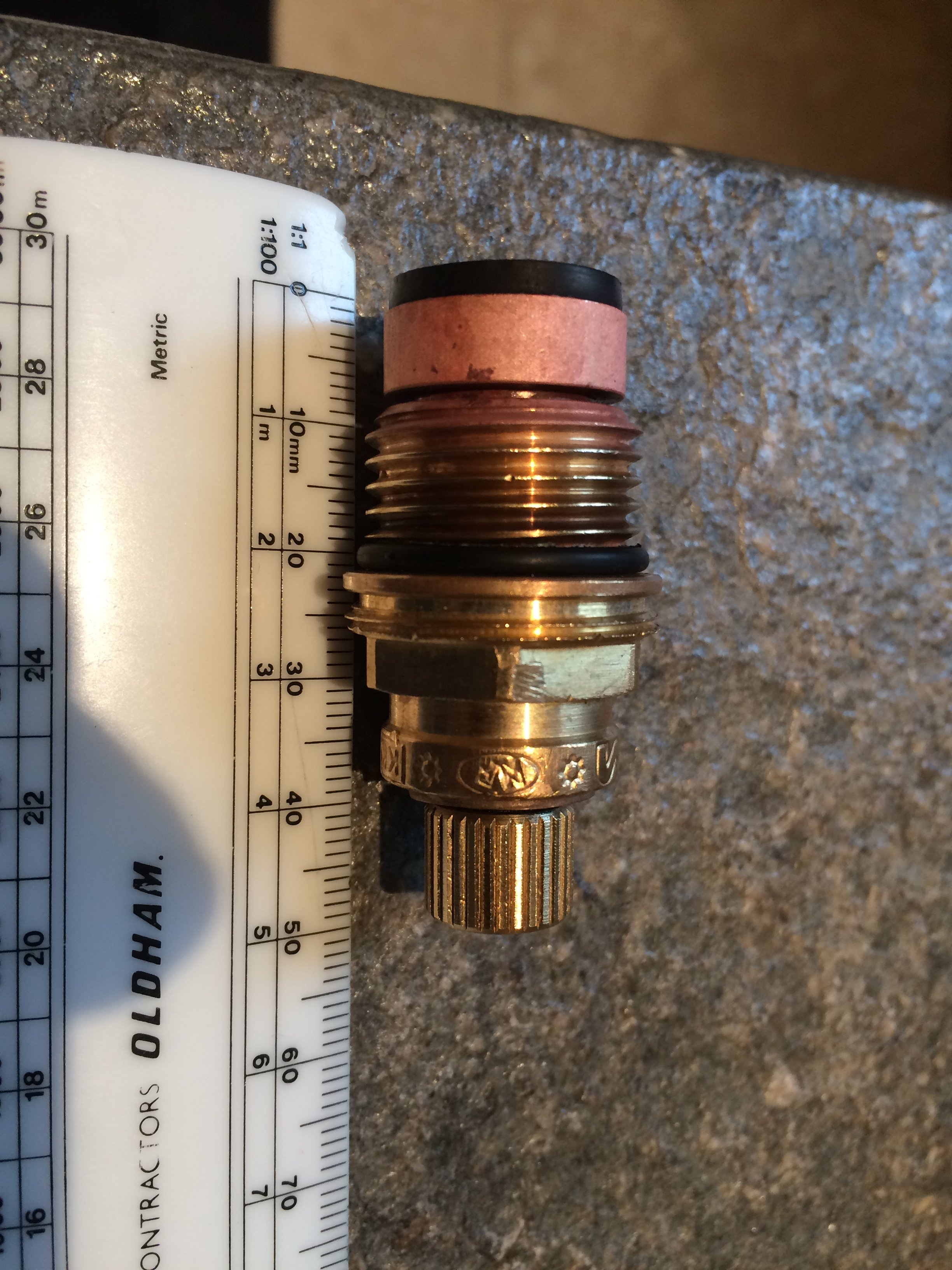

This shower valve has become very stiff recently until it would only move about a quarter turn and I couldn't get any water out of it. I've tried applying grease and vaseline to the moving parts and it's o.k. for a couple of weeks then the same problem comes back.
I would replace it but I can't find a valve the same size.
Any suggestions?
It's from a Porcelanosa/Noken NK system C shower installed in 2007.
1/2" BSP 18 spline

Did you try actually stripping the cartridge fully apart?
If no serious wear on the brass inside, it might just require cleaning and greasing. Any O ring at base of internal part can worn, just like with ordinary tap cartridges.
