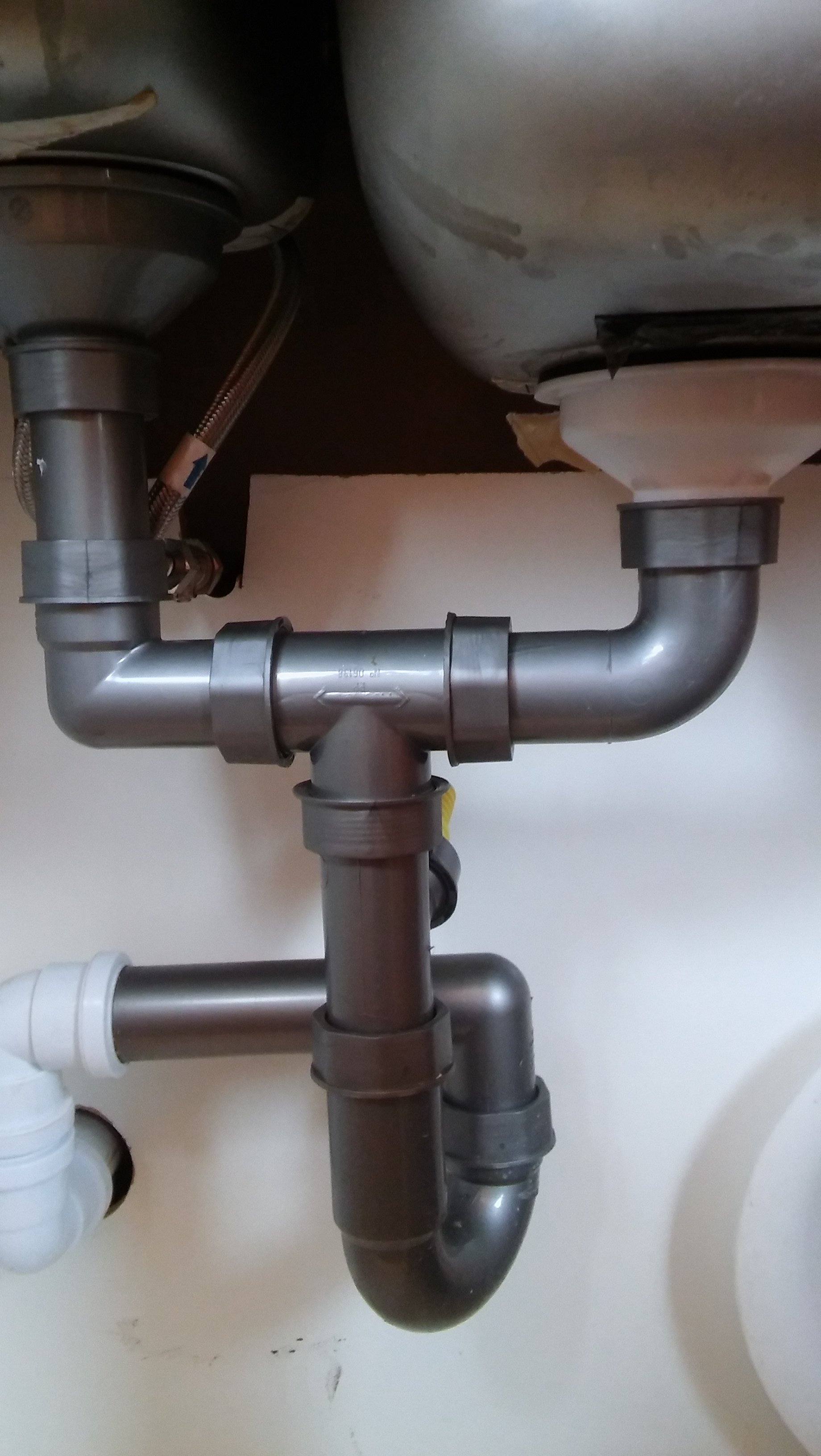

Any chance of a pic of the sink and underneath eg pipework in the utility room ?
I can get a pic of what I can see ie directly under the sink but there are a lot of pipes behind the kitchen/utility unit carcasses which without cutting them out cant be seen/accessed - Is this the new way of fitting out houses - block all the plumbing in!!! Same in my bathroom where I also had a leak through the ceiling, I have had to disrupt floor tiles and the whole of the side of the bath was tiled with no access to the pipes so have had to disrupt all the lovely mosaic tiling too - Grrrr .....

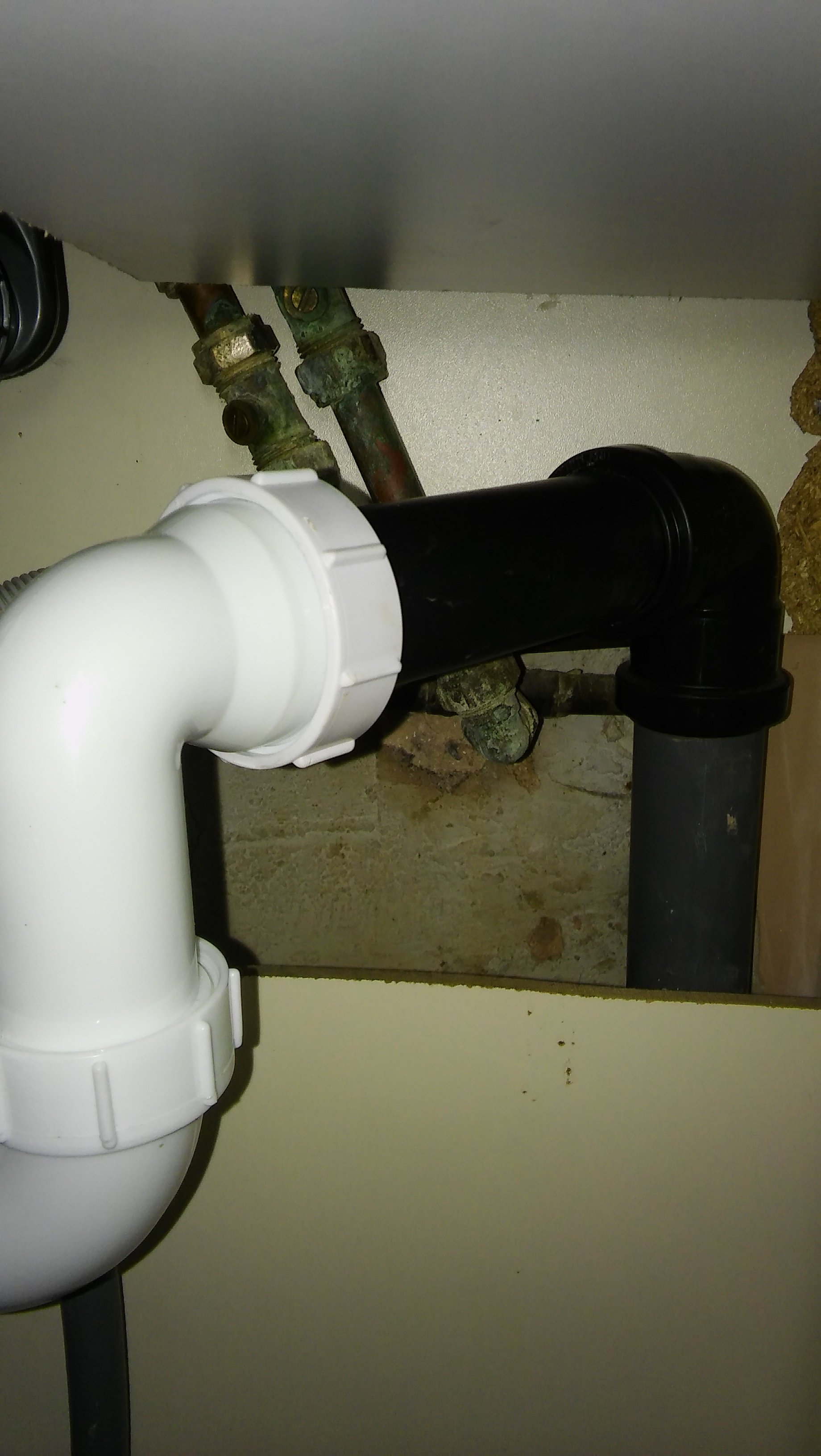

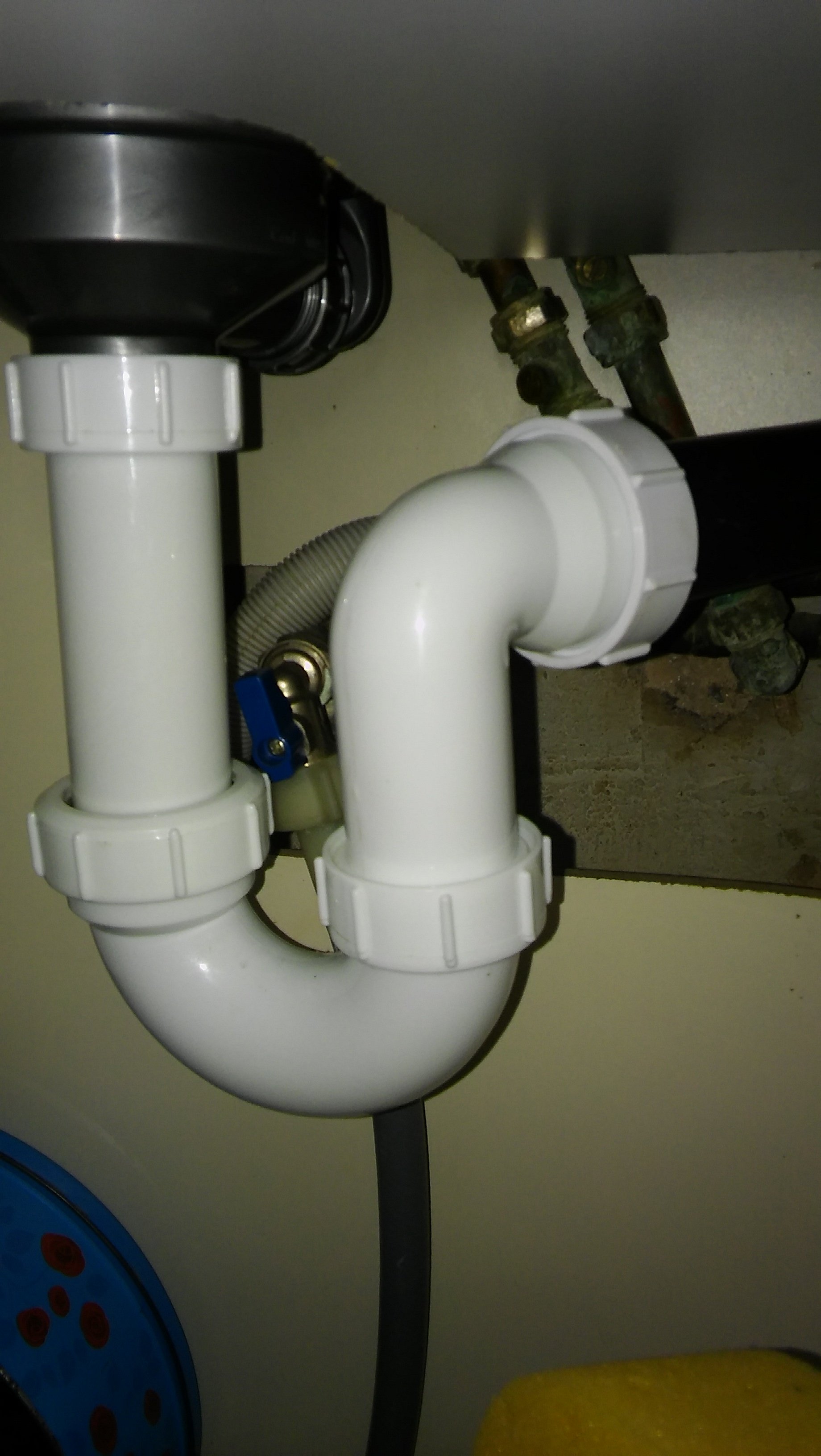

I am going to try and upload the photos now.... Hopefully you remember our comments above....the white pipes are the under the sink where the dishwasher is in the next cupboard and the grey pipes are in the utility room where the terrible smells are coming from.... also the soil pipe run up through the utility room to the upstairs toilet.....

On photograph 4, the convoluted grey pipe appears to be wet. Also there is evidence of corrosion on the compression fittings. Where is this water coming from?
