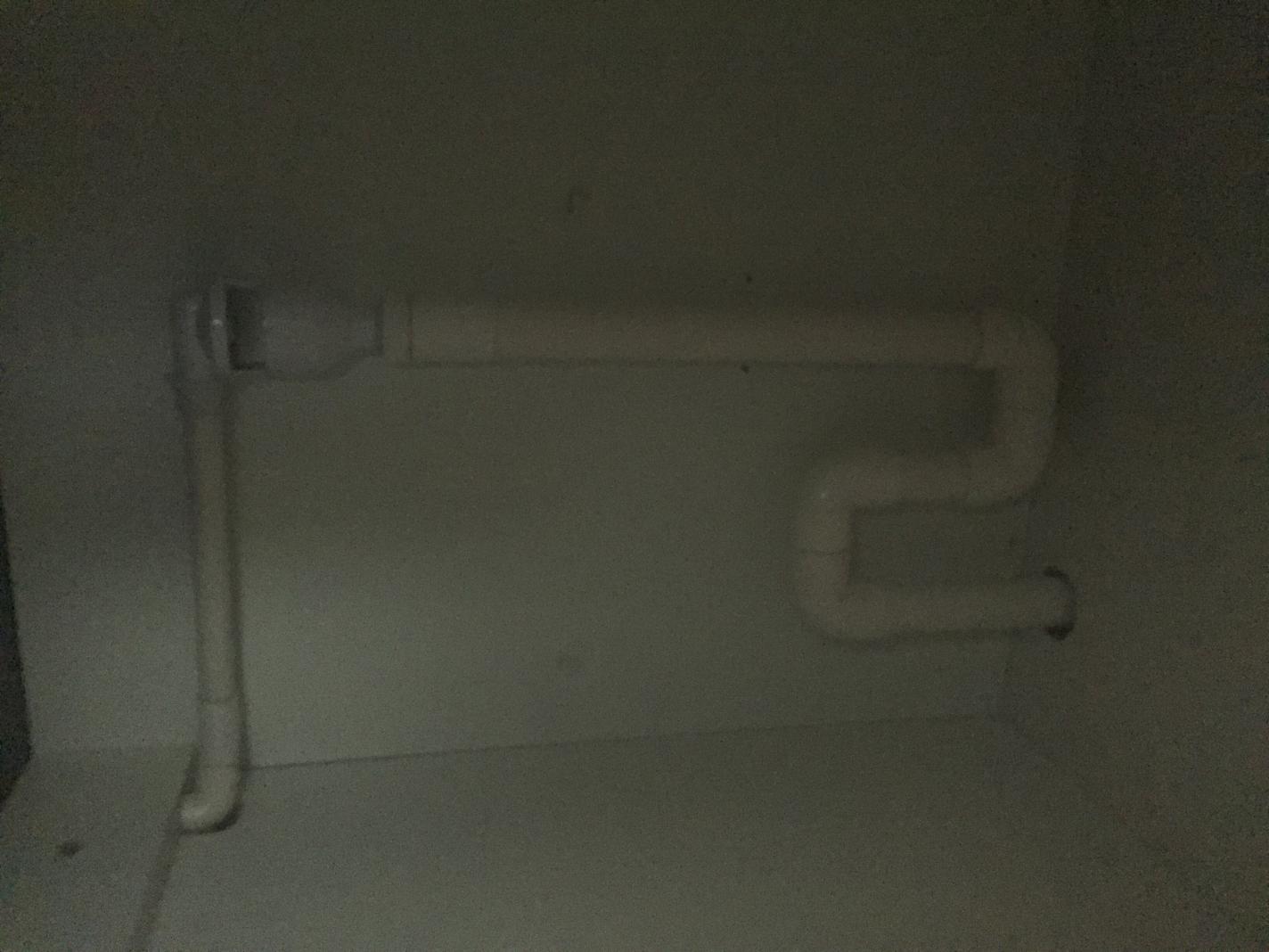

Below is a photo of the pipework that comes from below the boiler. The tundish is full to the brim with water.

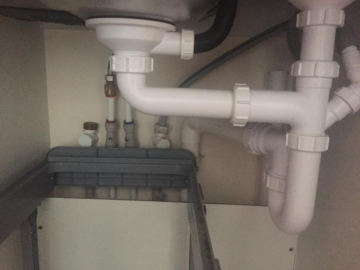

Then in the cupboard to the right of that is the sink and this is the pipework there.

The tundish takes the condensate from boiler and will join with other waste pipes in property. At some point there will be a U bend or trap to prevent smells coming from tundish. This trap needs clearing so condensate will flow away.
Just seen photo. Need to take plinth off below kitchen unit to trace pipework where it disappears from view. Temporary fix: Cut out pipework below tundish either side of U bend and catch condensate in large plastic bucket,empty daily. Cut square and 100mm clear of joints so 32mm pipework can be reconnected using two straight compression couplings. Also allows for checking blockage in bend but I suspect problem is further downstream.

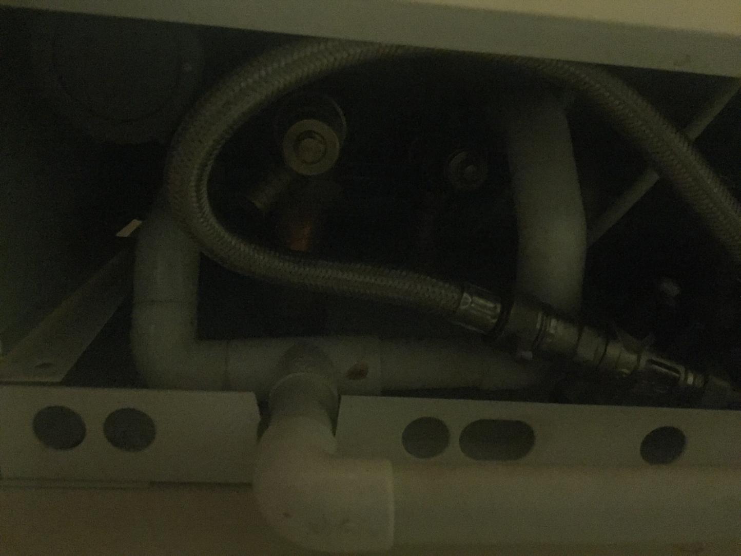

Your boiler should have its own condense trap, it looks like a clear trap hanging down from the bottom left of the boiler.
have you got a photo of this?

Ch4 - below is a photo of the bottom of my boiler, taken from below looking up. I hope this makes sense. There isn't anything hanging down from what I can see.
Looks like I will need to call the professionals in!

Cut out U bend 75mm up from where pipe disappears through bottom of cupboard and use spring drain rod,(Similar to net curtain spring), to attempt clearance of any down stream blockage. Remove plinth under cupboard and trace pipe run before removal of cupboards. Often pipe can be accessed from a more convenient point.
