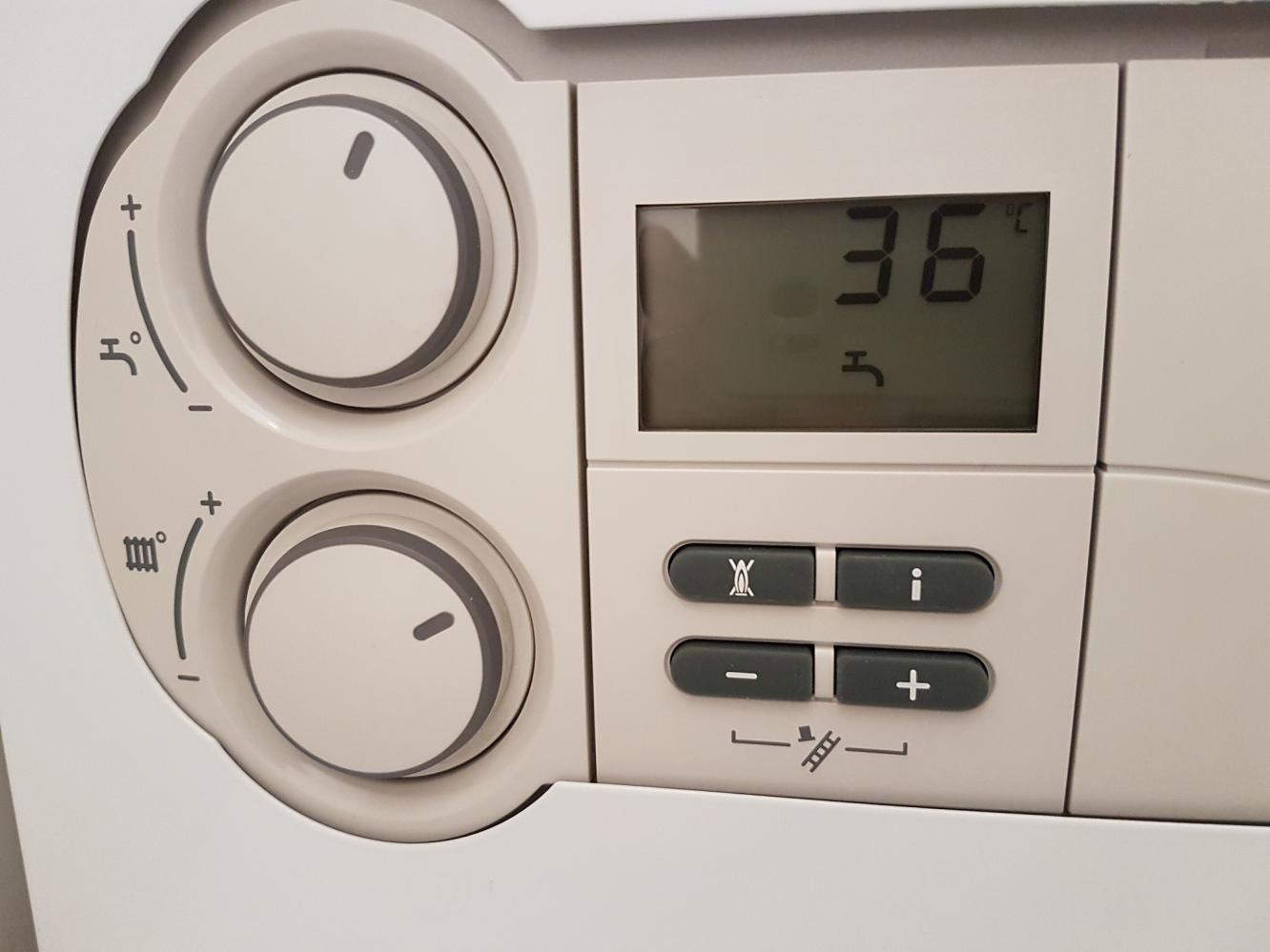

I have a Combi Boiler (Vaillant Ecotec Plus 428) and an Unvented Cylinder (Vaillant uniSTOR VIH GB 180s). Since yesterday we have no more hot water in the house, it comes out cold or luke warm. But the heating works fine.
When a hot water tap is fully opened, the boiler reads S.30 (no heating demand from external source). I have run the diagnostic, and the hot water flow sensor (D.36) reads 0 l/min as well.

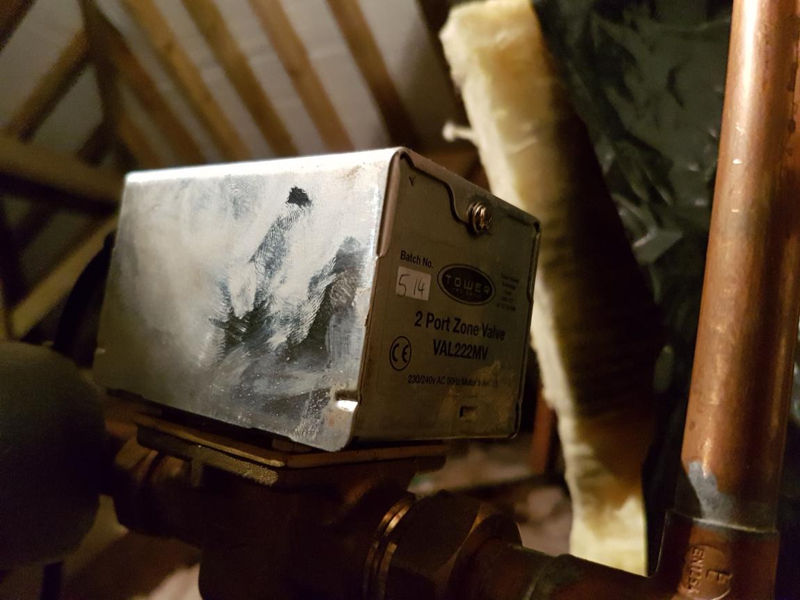

I've attached a picture of the actual valve.
Thank you,

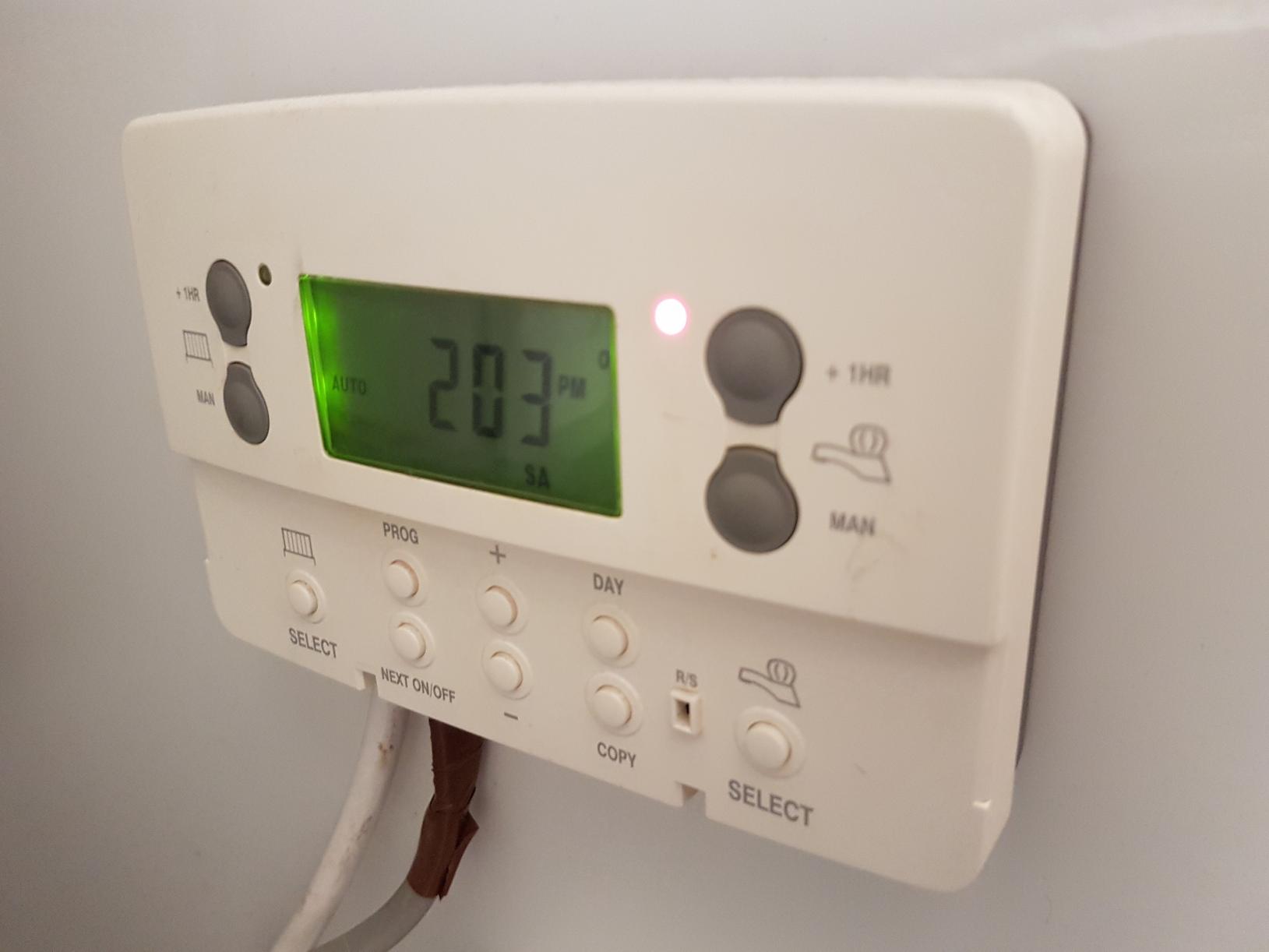

I confirm that when the programmer is on (from 6am to 8am) the boiler receives no heat demand (code S.30) so does not ignite.
But later today when I turned on the programmer, the boiler did ignite, I saw the zone valve opening and the pipe to the cylinder getting hot. But just for a couple of minutes, nothing after that.
Is the issue more likely with the programmer or the valve itself (Tower 2port VAL222MV)?

If heating is working, nothing wrong with boiler. G3 qualified needed. Suspect safety cutout on cylinder. Definitely not a DIY. Must not be bypassed.
Thanks for your reply. So does the cylinder cutout close the zone valve AND stop the boiler? That would explain why I saw the boiler stopped after few minutes.
I see there is a thermal cutout reset button, but I'll contact a G3 qualified. Thank you.
