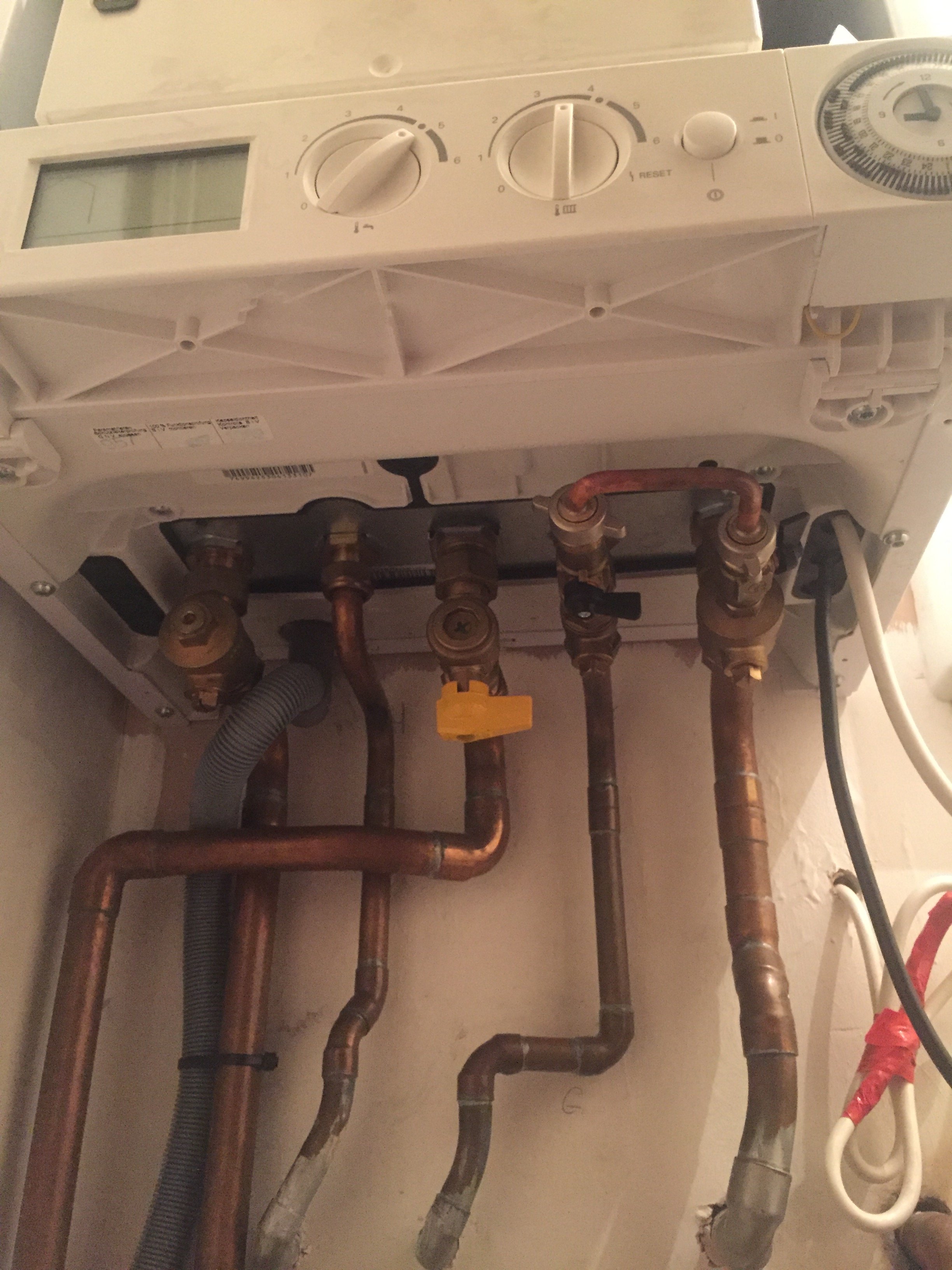

The attached photo shows the position that my valves/taps are in underneath the boiler. I stupidly didn't take a photo beforehand but I think they are in the position they started. I have not touched anything inside the boiler.

Gas is off turn the yellow valve 1/4 of a turn
Thank you very much Shaun. I misunderstood the markings on the tap.
Are the other valves in the right place?
Do I need to repressurise anything having let lots of water out? Boiler pressure is currently 2 bar.

Right you need to drain some pressure out of the boiler as it's too high nest way is a cup towel and a rad via the air bleed screw
Your looking for around the 1.25 bar cold or 2.5 bar hot (eg rads on or off)
All the valves look open just do as I've said above then you should be able to turn your boiler back on and check everything's working
