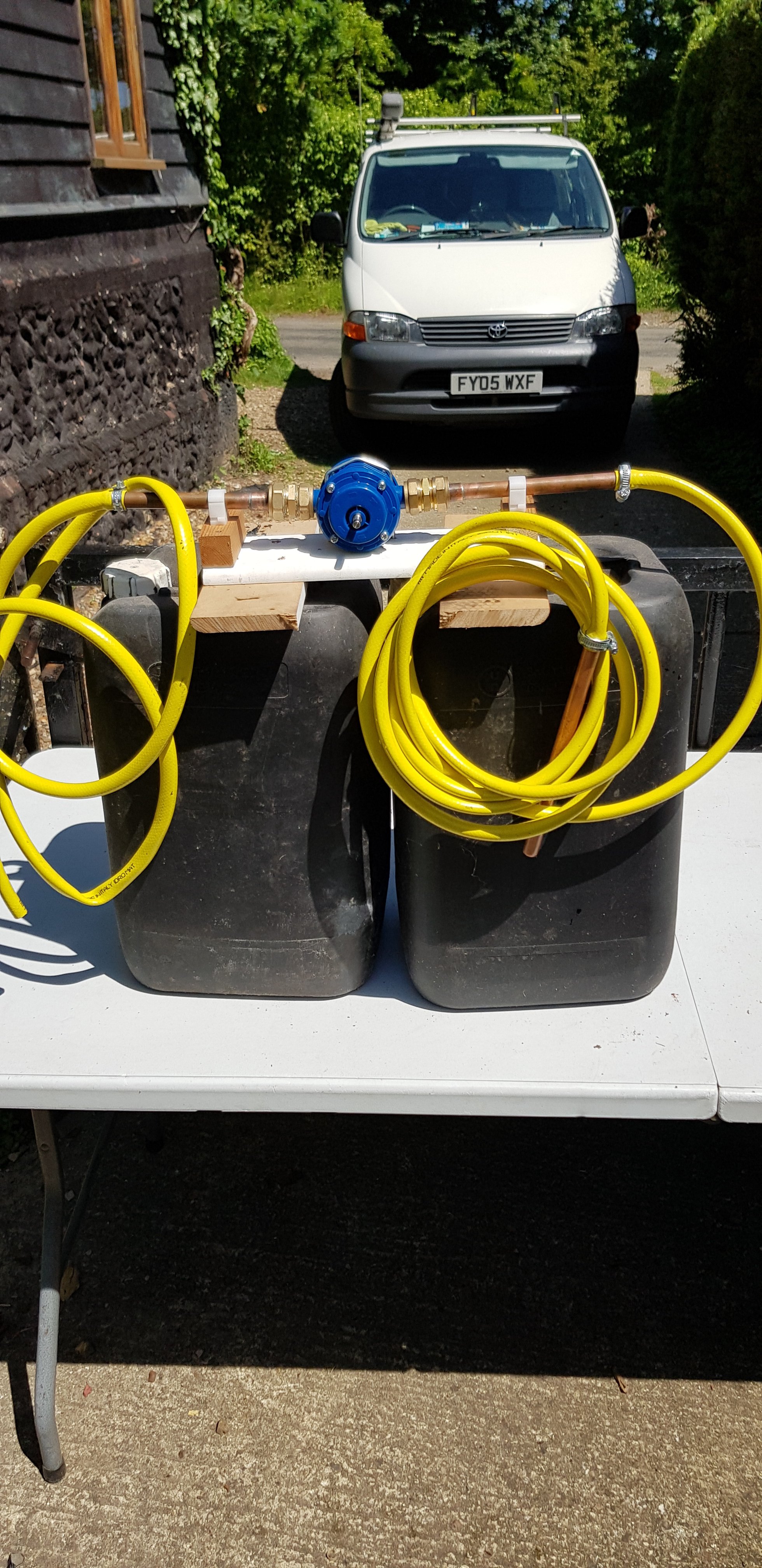

Ahh I can see it could be useful, I'll see how my little knock together works out in the morning and may well invest in one. :)
