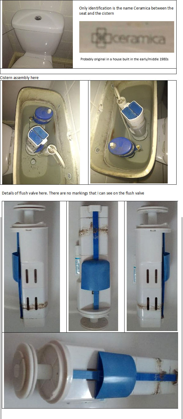

Well I spent a couple of hours pottering round various specialist plumbers shops in N London and all I got was "Hhhmmm - I've not seen one like that before".
So, anyone here recognise the make and /or suggest where I might get a flapper ? Or even a replacement flush valve?

are you / is the toilet in the uk?
very strange set up for the uk, you normally find that type of fill valve in other parts of the world eg usa etc
best option and quickest is get a plumber out / or if your capable to replace the internal parts, eg fill valve and flapper / siphon

Yeah. Seen them before . Cheap and nasty, probably came with a very budget toilet.
Normal for them to overflow while filling - that's what the tube from the fill valve to the top of the internal overflow upsatnd pipe is for. Instead of the dribble down the side of an equilibrium valve, the US market likes to run the dribble straight down the overflow for some I've never understood.
You probably won't find parts very easily but let me know if you do - I just replace these when they go wrong.

The ?silicone rubber seal on the outlet of that valve (I thought you had an actual flap valve) looks similar to the one fitted to the Wirquin Macdee 'Kayla' flush valve, which is also probably made in China and has UPC branding on the side. Try looking halfway up the white bit and I bet you'll find a UPC shield logo. May be the same size?
Ceramica is the brand of the ceramic bits, but most toilets don't have matching brand cistern components so you don't need to be that specific in your choice of replacement parts.

Logo: "Halfway up the white bit" under the lowest of the two slots is a logo. It has the letters ABS under a triangle with little arrows in the middle of each side
I just meant any make flush valve and fill valve would be fine, but on a close-coupled toilet like yours, you'd need to take the entire cistern off so may be a plumber job.
If you're wanting to just replace the rubber outlet seal underneath, then I don't mind checking the dimensions of that seal against those on a 'Kayla' valve for you? Thickness, outside diameter, and inside diameter of the washer please.

Yes: Reluctant to take cistern off!
ABS: Sounds likely
Dimensions of seal
Thickness 3mm
OS Diam 58.5mm
IS Diam of plastic clip that holds seal in place is 15.5mm
IS Diam (size of hole) of seal seems to be 16 mm (but probably 15.5!)
The Kayla seal is same ID, but edges only about 2.5mm thick (edges thicker than middle), and OD is greater. Pity about thickness, else you could have cut one down.
I do have a similar seal in reasonable condition 3mm thick all over, same ID but bigger OD. Again, could probably be cut down. I salvaged it out of a broken flush valve, but it's yours to try if you want to post me a S.A.E. ? PM me ('start a conversation') if so.
