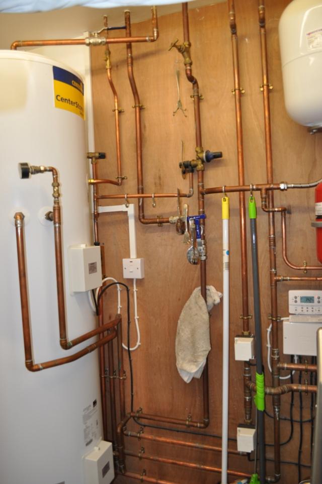

I am at my wits end. We have a Centre Store 300L solar tank. We have not fitted the solar yet, that is for the future. When it was installed, the plumber appears to have plumbed in all the secondary return but there is no pump, so I am assuming that it is not used. However, if we heat the tank of water in the morning and not switch on a single tap, by evening the water is cold. If I touch the copper pipes that go into the "primary return" and the "secondary return" they are both hot, so I have to assume that for some reason there is hot water going out into the pipes even though there is no water running?

Tank, with primary and secondary returns fitted and then a whole wall of plumbing 🙂
Needs that secondary return doing away with. Looks like you are getting a gravity circulation through the hot water feed back to the return.
Would also want the isolation valve taken out of the cold feed as it is after the expansion vessel. Also the one on the hot at top of cylinder.
Should all be insulated.
Be interesting to know if he was qualified to install and if you have received your certificates from local council.
Seems like it could be that the solar coil isn't piped in. Basically the top coil is only heating up the top of the cylinder, and the stat at the top is being satisfied and turning off the boiler whilst the water in the bottom of the tank still isn't hot. During the day the hot water at the top will slowly mix with the cold water at the bottom cooling down all of the water in the tank.
The secondary return probably isn't helping either as the hot water will be rising up that return pipe and going to nowhere.
I'd recommend capping the secondary return and plumbing in the bottom coil as well so the whole tank is being heated.

Looks like a half decent installation other than there is a lever valve between then expansion vessel and the cylinder that shouldn't be there, i cant see a bronze pump for the secondary return but i can see check valve which would normally go between the pump and cylinder.
I always pipe up the solar coil in paralell with primary coil until the solar is installed.
I don't like the expansion vessel on a flexi aswell, hard pipe it. Change the stopcock for a lever valve, keep the lever valve on the balanced cold but do away with the one on the cold feed inbetween combination valve and cylinder as this could potentially isolate the expansion vessel.
Also Yorkshire fittings look messy, and it needs lagging.
I think weve all seen far far worse though, and i agree both coils need connecting until solar thermal installed, that's the problem, not anything to do with a secondary return.
if the secondary is running on gravity id leave it but get it lagged obviously at some point it was thought to be necessary and if its working without a pump bonus
or there must be fresh water motorised valve available to control it

Most got the isolation valve on the cold feed to cylinder which can isolation the vessel but also the expansion relief safety valve.
No one mentioned the balanced cold being taken off without a single check valve after the tee to stop hot mixing with cold, cos that will then mean moving the expansion relief safety valve & the expansion vessel con to the cylinder side of the check valve.
Who sized the cylinder? that looks like a non solar storage of no more than 100 Litres of hot water, this is never going to do you for the whole day - your choice until the solar is installed & heats more hot water.
1. As others have said pipe the solar coil & have 300Litres of hot water with all those standing losses.
2. Set timer so that boiler heats the hot water two or three times a day before it is required, lots less heat loss as less volume.
Either way insulate all pipework around the cylinder which should have been done under Part L when it was installed this helps with the heat being lost from the cylinder up & from the copper pipes that connect to it. (All the flow & return pipework should have been insulated)
OP state that they did not really want a secondary return but then say how long it takes & that the water goes cold in pipes the reasons why a property of this size & type would need one. Water Regs state HW at 50deg C should reach furthest fittings within 30sec to stop waste of water & energy. There are secondary circulators that provide closer control than just having them on a timer.
Seems to be a valve on the secondary return. Could be a spring operated check valve.
It may or may not have a resistance high enough to prevent thermosyphoning.
If thermosyphoning is operating. Then you don't need a pump.
But perhaps a potable water valve that will shut it down at certain times.
Secondary return loops need thick 25mm wall armaflex insulation.
I notice Megaflow make no mention of fitting an nrv on the balanced cold take off.
That would be because there would be no point in installing one, what would it achieve?
(Check valve goes on the cold feed to stop HW going back up the balanced cold take off)
My apologies I thought you mean't fitted on the balanced cold take off.
Centerstores installation manual shows the cold water combination valve as a two piece assembly with the balanced take off T fitted between the prv and expansion relief valve which houses the nrv on the inlet side.
But you fit that T your self. The oso combination valve has the balanced take off incorporated in the valve.
