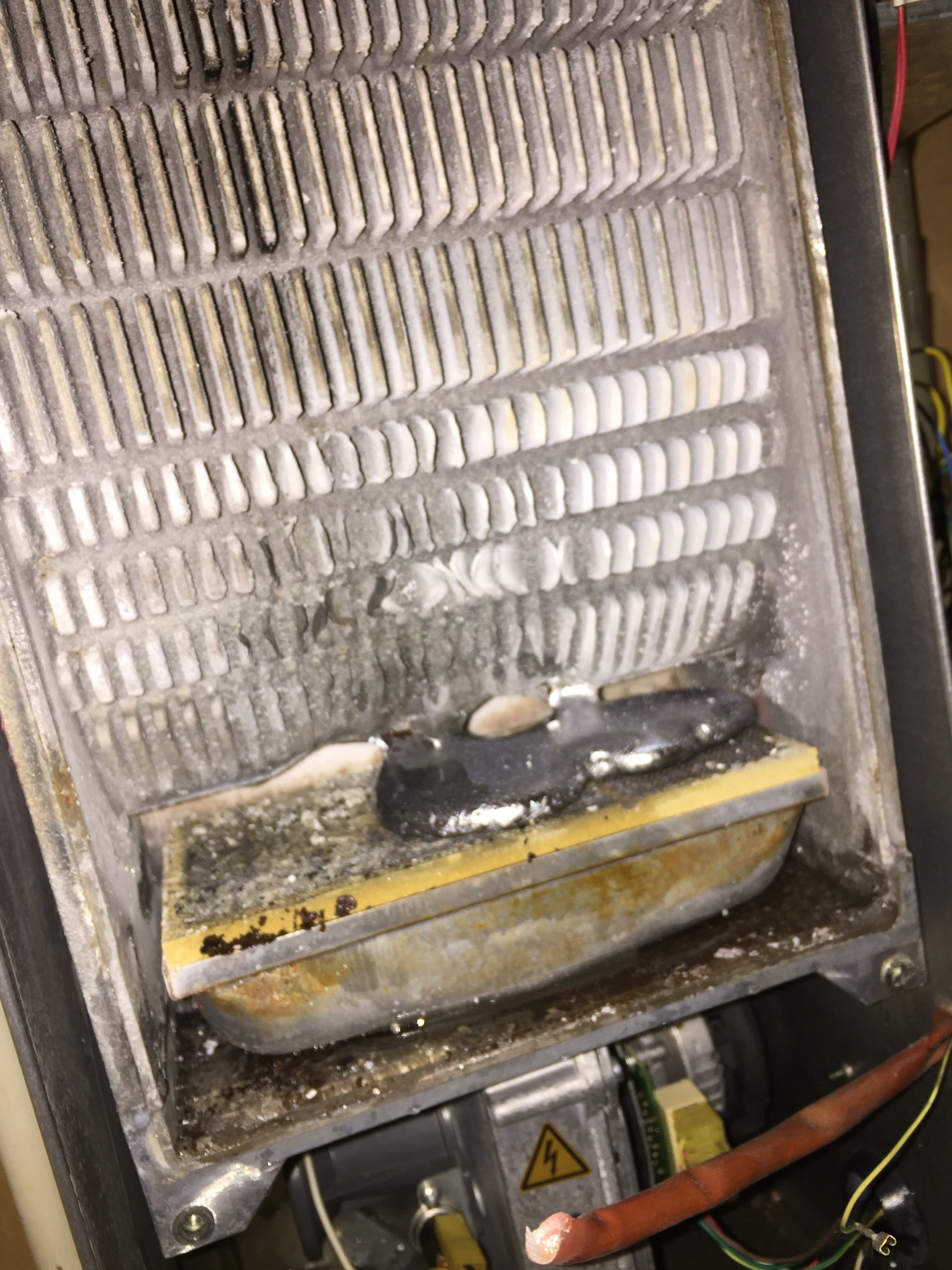

Thanks. I don’t know as he got someone else in to do this work. By the way there is more to the story. This only happened as a result of the existing Potterton boiler having a huge issue mid way through the work that was carried out, after a new hw tank was installed we couldn’t get the heating back on.
Next day he arrived and discovered this (bet you’re going to love this):
Yes, that is molten metal in the boiler. He’s installed the new system for free (I’ve had to pay for the boiler and pump/flue etc).

Boiler fires with no water in it, rookie mistake
Baxi or potterton solo
So it’s likely that was as a result of the works carried out here? Or a coincidence? It happened after they had installed a new hot water cylinder.
That's my biggest fear. In fact I'll probably have nightmares tonight.
It's why I am really pleased whenever I find a boiler with an isolator or an integral off switch so I can get the pump up and running first and make certain there's some water going round.

Or turn the boiler thermostat all the way down 😉
