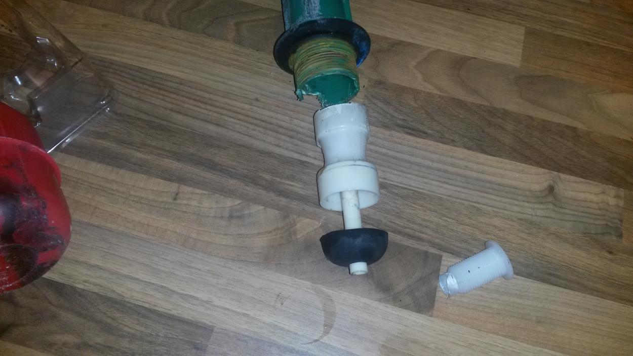

bomb.jpg also this is the old one but i dont see no thread on the bomb bit?
p.s thanks for pointing out rubber was upside down lol i most prob would have put it back in this way too ha
Yours must be just a push in bomb, but either type does.
yeah must be ill post a photo in a min and how i think its put together. then b and q tomorrow for a syphon 🙂 i might just try the old bomb with the crack on plastic first and fingers crossed it works
im guessing thats how it fits on and i just fit on toilet or should i push rubber right up into tube
