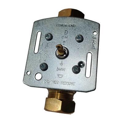

You could try making an offer
There are complete one's with the valve for a bit more
Or the valve separately:
You need to check these are the right model - I think they are but I'm not promising!
