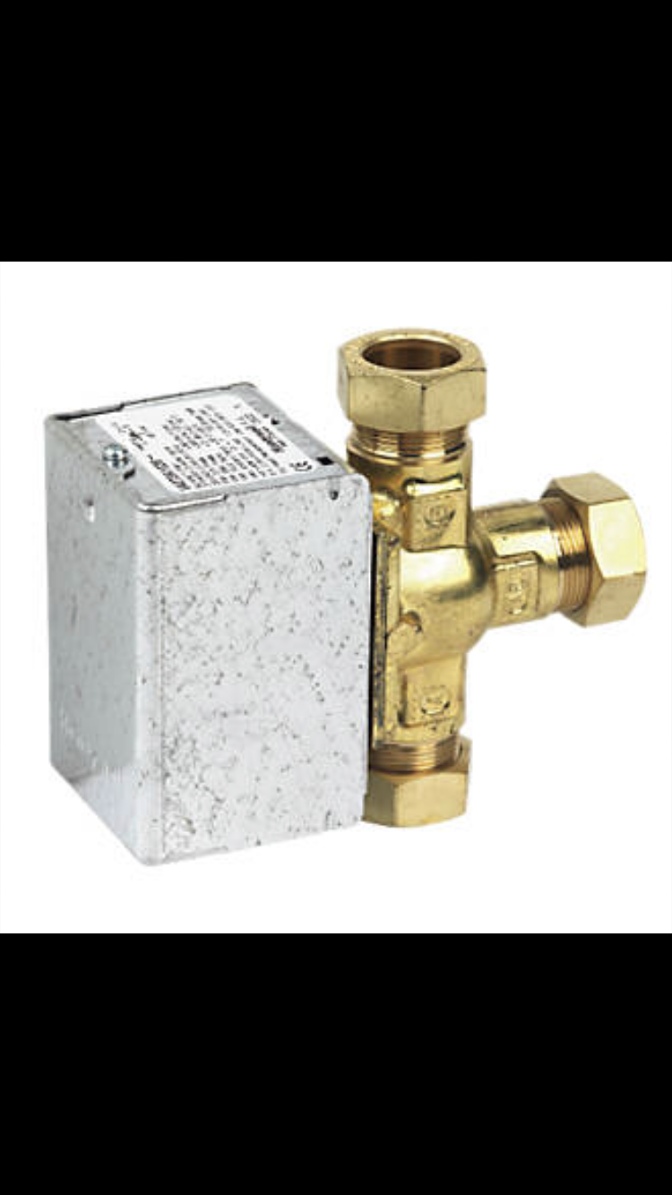

Can you post a pic of the valve to see if the head will come off? You cannot remove it on some. How old is the valve? I personally wouldn’t change the whole thing if it is only a couple of years old.
Here is a pic of the motorised valve, a Honeywell unit, and for some reason there is no label or serial/model number on the unit! We bought this place about 10 years ago, and I think the boiler is approx 12 years old.
I am reasonably happy to replace the head unit myself as the wiring seems fairly straightforward, but my question is this...
Once the head is off, what is an easy way to check if there is wear to the valve itself?
As if there is wear, I shall get a plumber to come out and replace the head and valve in one go, but I hear that these valves are pretty reliable.
Anyway, as usual, any advice much appreciated!
Cheers, Mark.
Looking at the location of the valve I would say it looks awkward. I would get someone in to change it for you.
