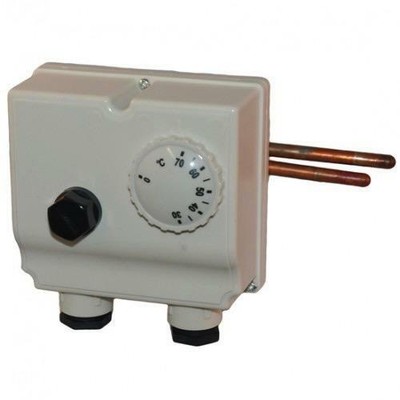

I have a Firebird 90S oil boiler, which was installed about 10yrs ago. It has a Cordice 542788 thermostat fitted, which has a range of 60-90c apparently. The water temperature tops out at 68c when the thermostat is on its lowest setting so either it is not working properly or there is too much leeway in the manufacturers settings.
The problem is that the hot water has damaged the shower pump. The easiest fix being a new thermostat which actually works and a better range.
I have found this on eBay which looks like it might do the job:
I've then had a look at the manufactures and found that the only one that they supply is for a hot water cylinder, although it looks like you can buy copper pockets for it, which I understand to be sensors on wires rather than a ridged spike that goes into the cylinder.
I have contacted Firebird who are of the opinion that the wiring is compatible, I'm just awaiting a reply from the eBay supplier to confirm the length and diameter of the pockets to ensure that they will fit into the boiler.
The industry standard for boilers appears to be 60c< and the for shower pumps its 60c> so there is a very fine line of tolerance. I do understand that stored water should be around 60c to prevent Andy bacteria forming. I'm guessing that Thermostats are juts not very accurate, so having a wider range of operation is surely an advantage to overcome this.

The Imit Stat is pretty much ident with what I've got. If the lowest setting is 60c and there is some leeway in the setting, then the water could got higher and I would be in the same position. If I get the Reliance unit, it affords more temperature control unto and around 60c.

It appears the only replacement thermostat is another firebird unit because of the length of wires to the probes:
My understanding is that most of these dual thermostat units have a leeway of +/- 0.5c so I would imagine fitting a new unit would solve the problem.......alas you have had experience of the boiler heating up the water faster than the thermostat can react to, so this fix might not work.

My understanding is that most of these dual thermostat units have a leeway of +/- 0.5c so I would imagine fitting a new unit would solve the problem.....alas you have had experience of the boiler heating up the water faster than the thermostat can react to, so this fix might not work.

Gents, thanks for all your advice, I've gone for a TMV as the solution rather than mess around with the boiler thermostat.
Having spoken to the Firebird, they declared that their thermostat (60-90c) usually worked at 65-78c with a +/- 3c tolerance. It's a bit like using pig iron on a job that requires titanium 🤷‍♂️ to that end, my thermostat might have been working 'correctly'.
