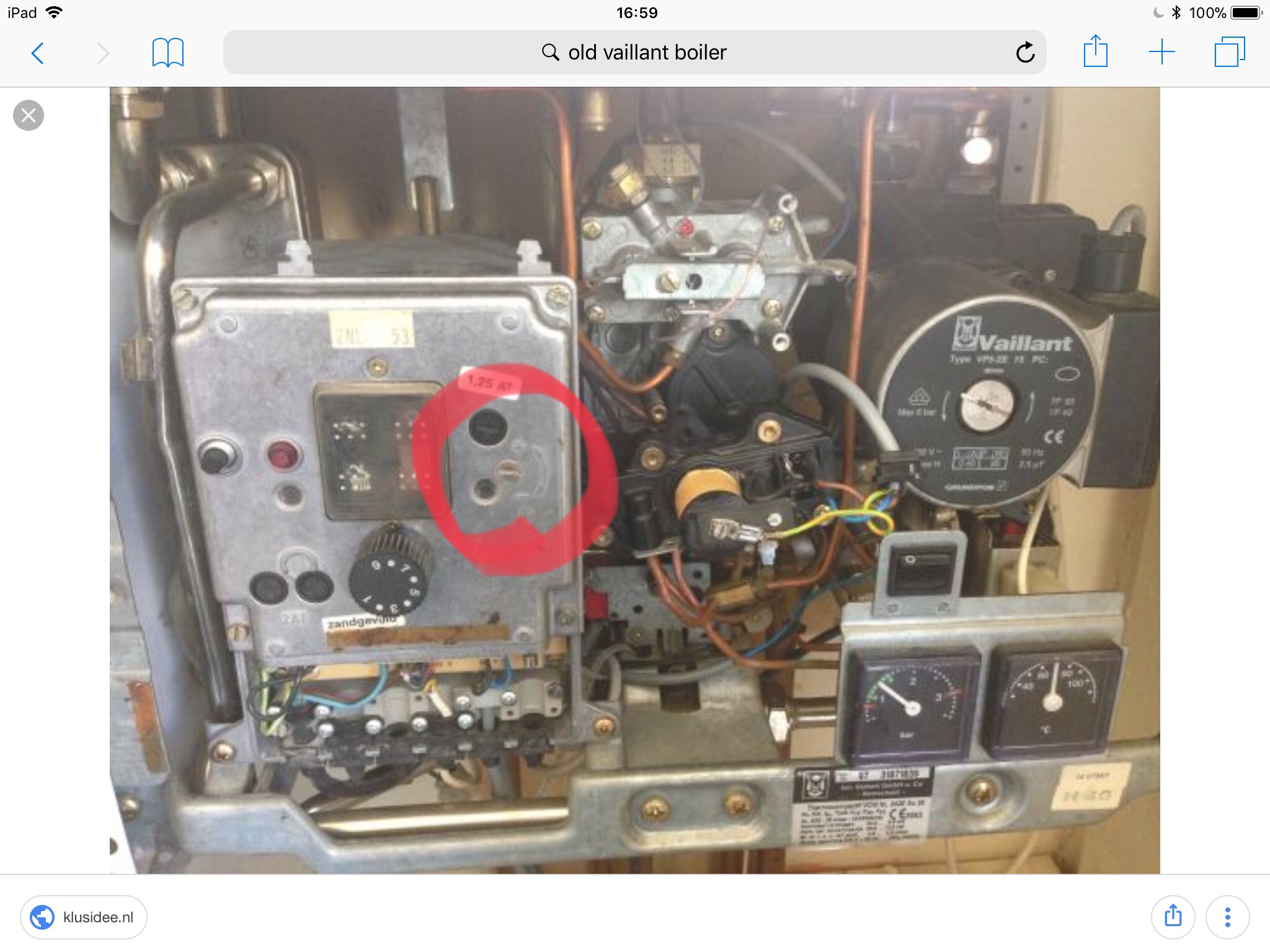

Hi
Inside your boiler there lots of mechanical. Hydraulic controlled valves fed by very small capillary tubes. Any one can block up. Trust me , you have a great boiler, but once an engineer starts on this, he will have sleepless nights.
But, there is one thing you can try yourself without contravention of any gas safe regulation. This has worked for me in the past. But may not make any difference to your problem.
Where I have highlighted, there’s a screw. Remove it, then with a very thin flat screwdriver locate the screw hidden inside. Turn this a quarter turn left, or right.
I’m not going into any more detail why. But it’s worth a go.
If that doesn’t help. I’m afraid it’s an older engineer, who is experienced in this boiler. Or a new boiler.
2 other things , that looks like the original pump if that is not giving out a good pressure it will effect some of the other valves, look to the right of red circle the black diff valve is one that fails gets weak again something you can do without compromising the gas rules, Think I've still got some replacement diaphragms for that valve along with a case of other parts
So according to the manual that's the re-ignition delay? Not sure whether that's where the issue might lie since the boiler occasionally fails to ignite several hours after the heating was last on....would I be looking to reduce or increase the delay?
Your nor increasing, o decreasing it . Your just moving onto a different contact point. Theses work like old hifi volume controllers and the contact burns out. Moving it slightly makes it contact with a new area.
Worth a try
