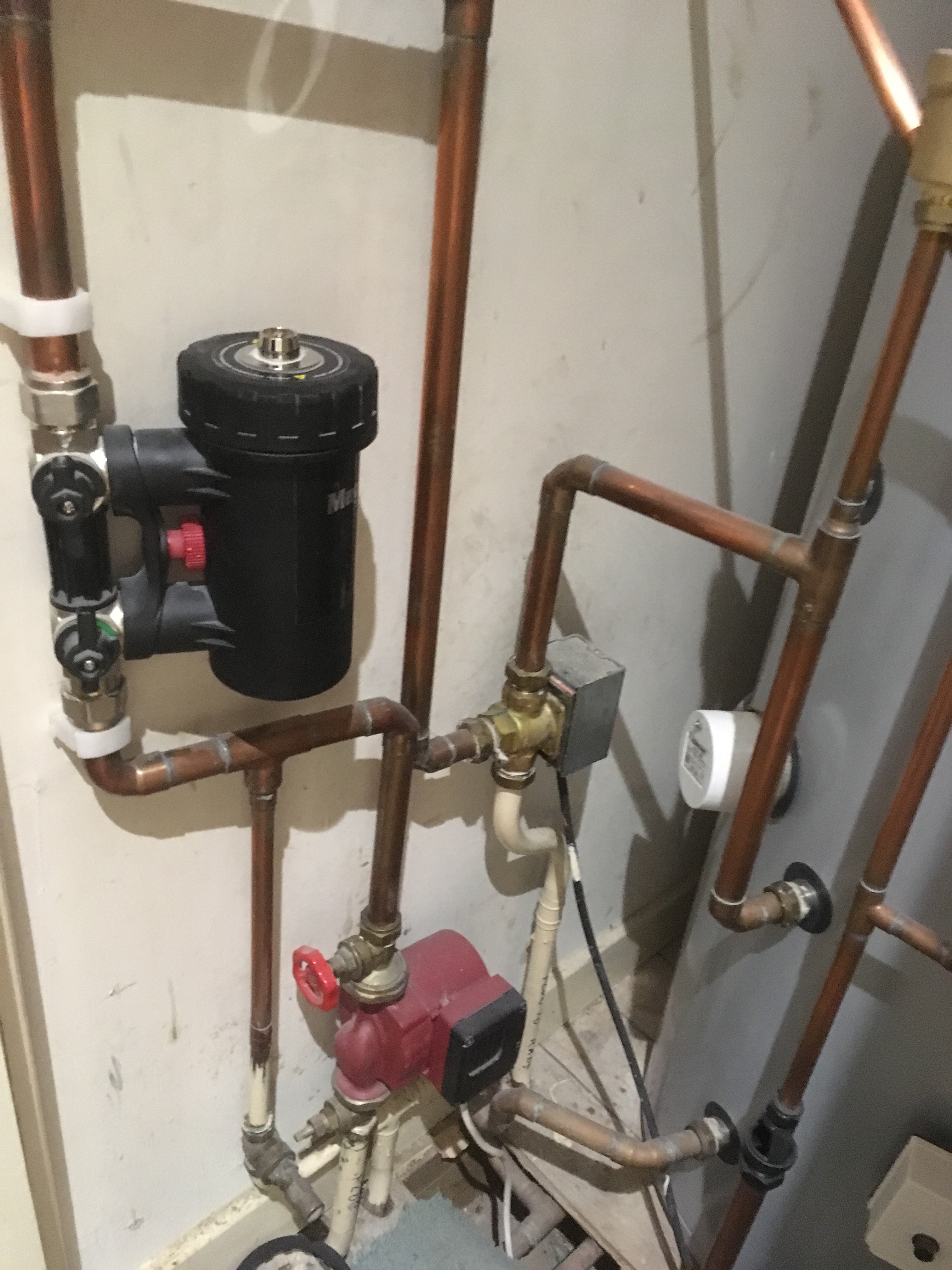

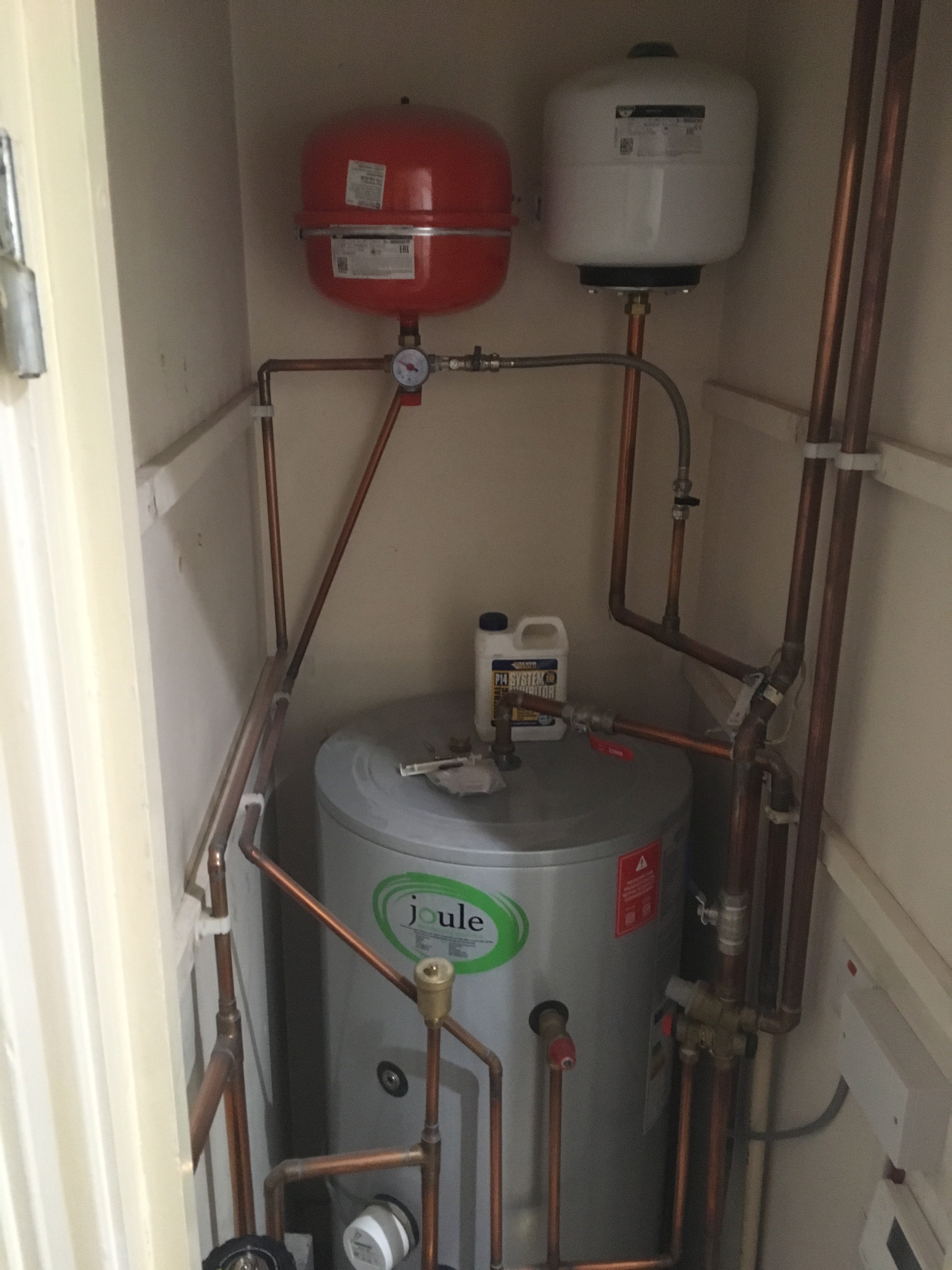

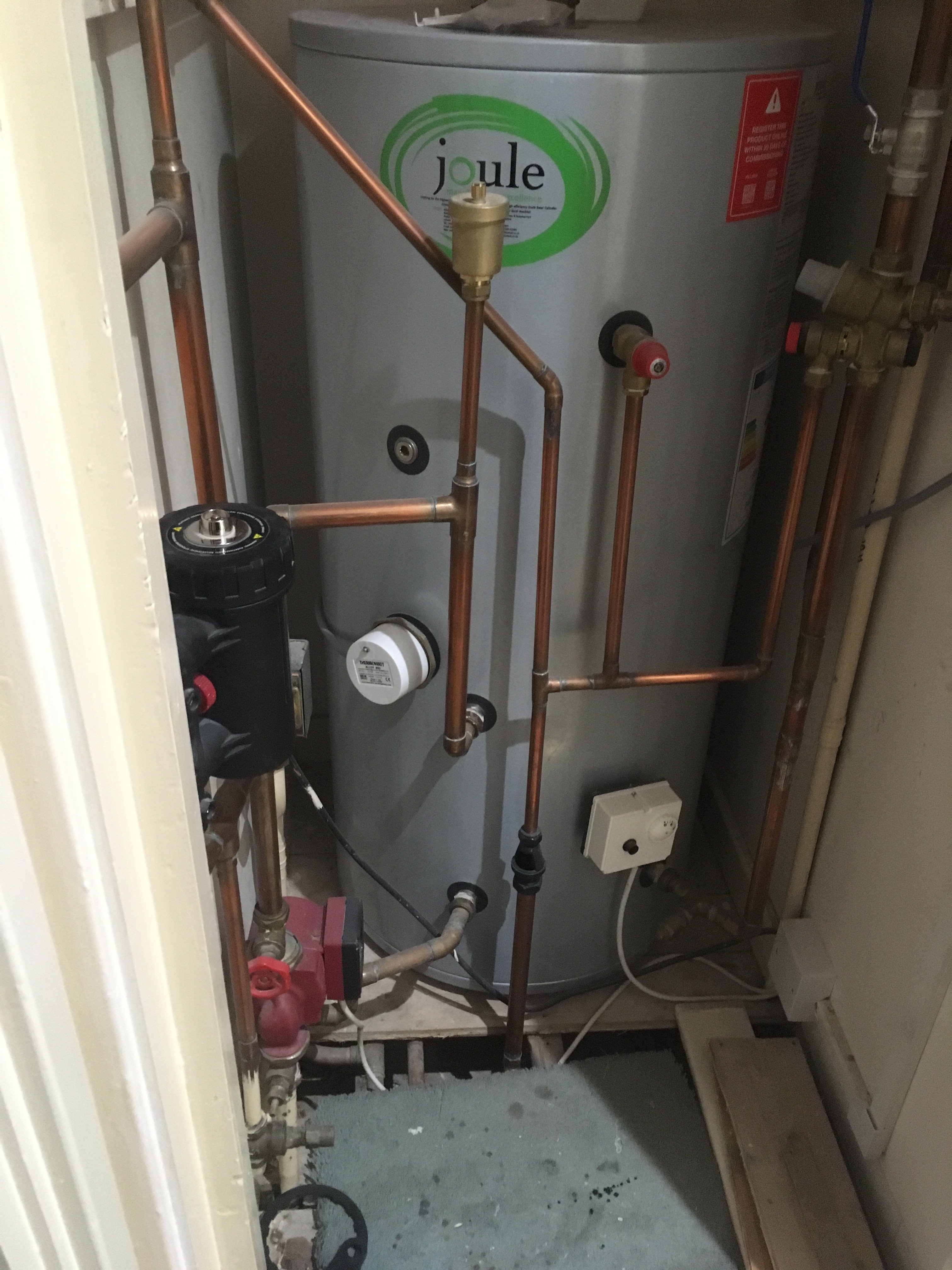

Hey guys, here’s the final update on the post 3 weeks after instal.
I went for Joule cylinder in the end. The install took one day, but that involve me preparing everything a week before and running the 22mm waste pipe along the plumber installing the cylinder.
Only thing I’m planning changing in this set up is adding an automatic by pass, but that’s for a next bank holiday weekend, I’ve got clockroom to do first.
Building regs certificte came through the post yesterday, so all seems good. Many thanks for all who contributed and advised, I’d get you a beer each if I could ;)
Don’t know how you have a cert as it’s not a good install
3 port valve istalled wrong should be a 3 port and a 2 port (safety) or two 2 ports eg s plan
Plus a few more niggling things
Filter on the flow
Not enough tundishs
Interring, I might have to follow up with the installer about the 3 port valve.
I wanted to change that to an S-plan, but installer said that changing the valves and pipes would take the install into two days work territory and add about £50-100 plus the cost of parts for this job. So it seemed like it wasn’t worth it to me.
I’ve also noticed that filter was installed on a flow, not return, but he said that there isn’t any space to put in on return in this clockroom and boiler downstairs installed about 15-20cm from the ceiling, so can’t go there either.
As for tundish, the what’s wrong with it? As the bend is 38cm below the tundish.
It requires the extra port valve or an s plan so no option to fit without you should of been made aware of this
As for extra they normally supply a two port valve with the cylinder so no excuse
Would want a few more install one on each of the safety’s but not a requirement that’s why it’s in the niggle cat :)
Your main safety issue is the port valves
How did he manage to get Bulding Regulations Notification certificate? As I have it in the post with his company name on it.
Guess he lied on it
Hmmmm I’d still be dubious. The valves thing is unventeds 101. Does someone at his company hold the qualification but not him??
