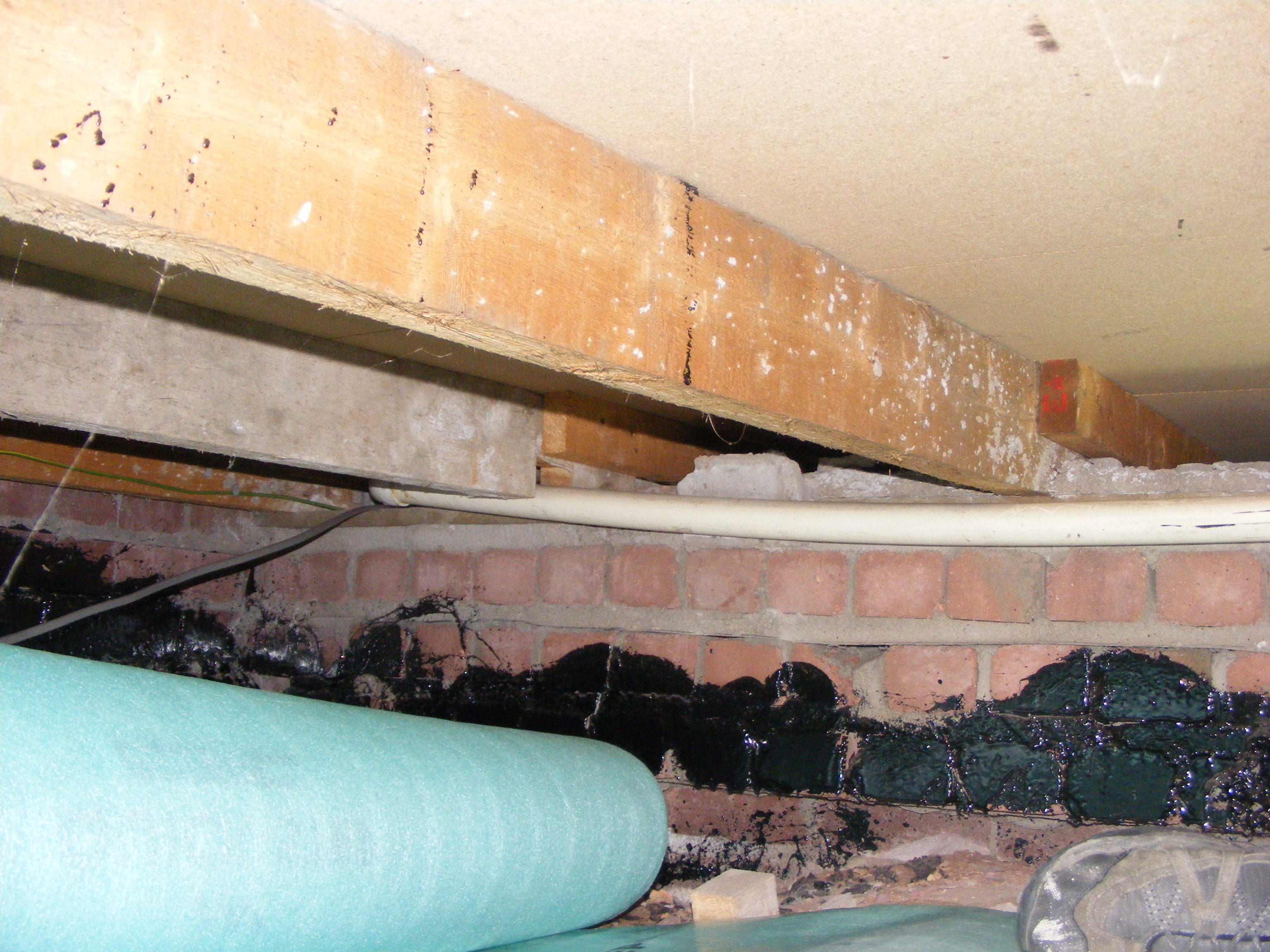

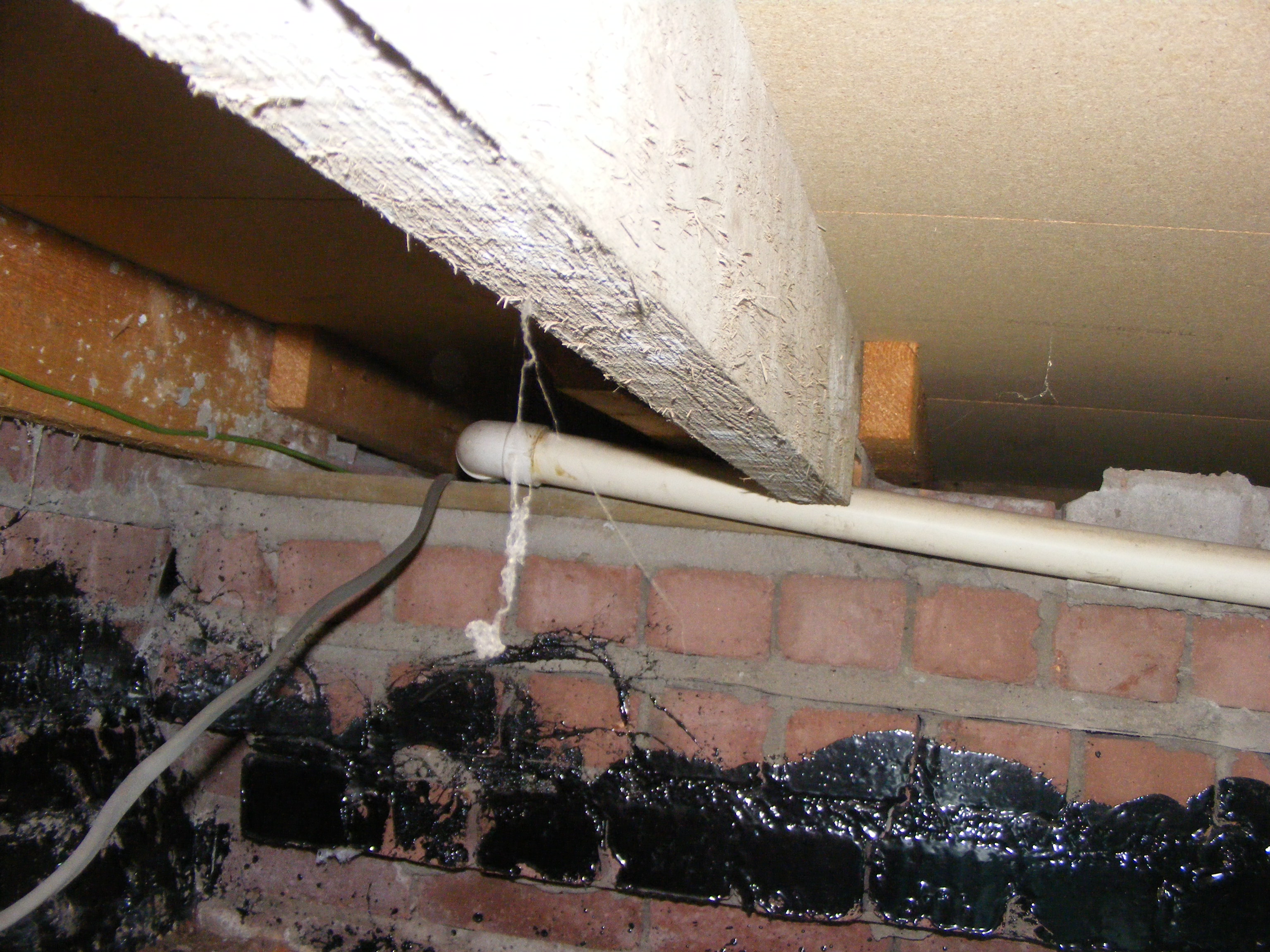

I've attached a couple of photos.
What size is that pipe, it looks 40mm? A 4.5m run is too long for 40mm. Might just get away with 50mm but the waste pipe size rules are:
32mm - 1.7m; 40mm - 3.0m; 50mm - 4.0m.
That's without it sagging and then going uphill.
Considering that the total run length is a lot more, you're really faced with using 3'' or even 4'' soil.
You can't be notching joists for that diameter of pipe so you're left with taking it under the joists then out. You only need about 1cm drop per 1m, so the total drop on the 4.5m run would be fine if it was 5-6cm.
Would it be possible to do it this way? If so then you know what you need to do ;)

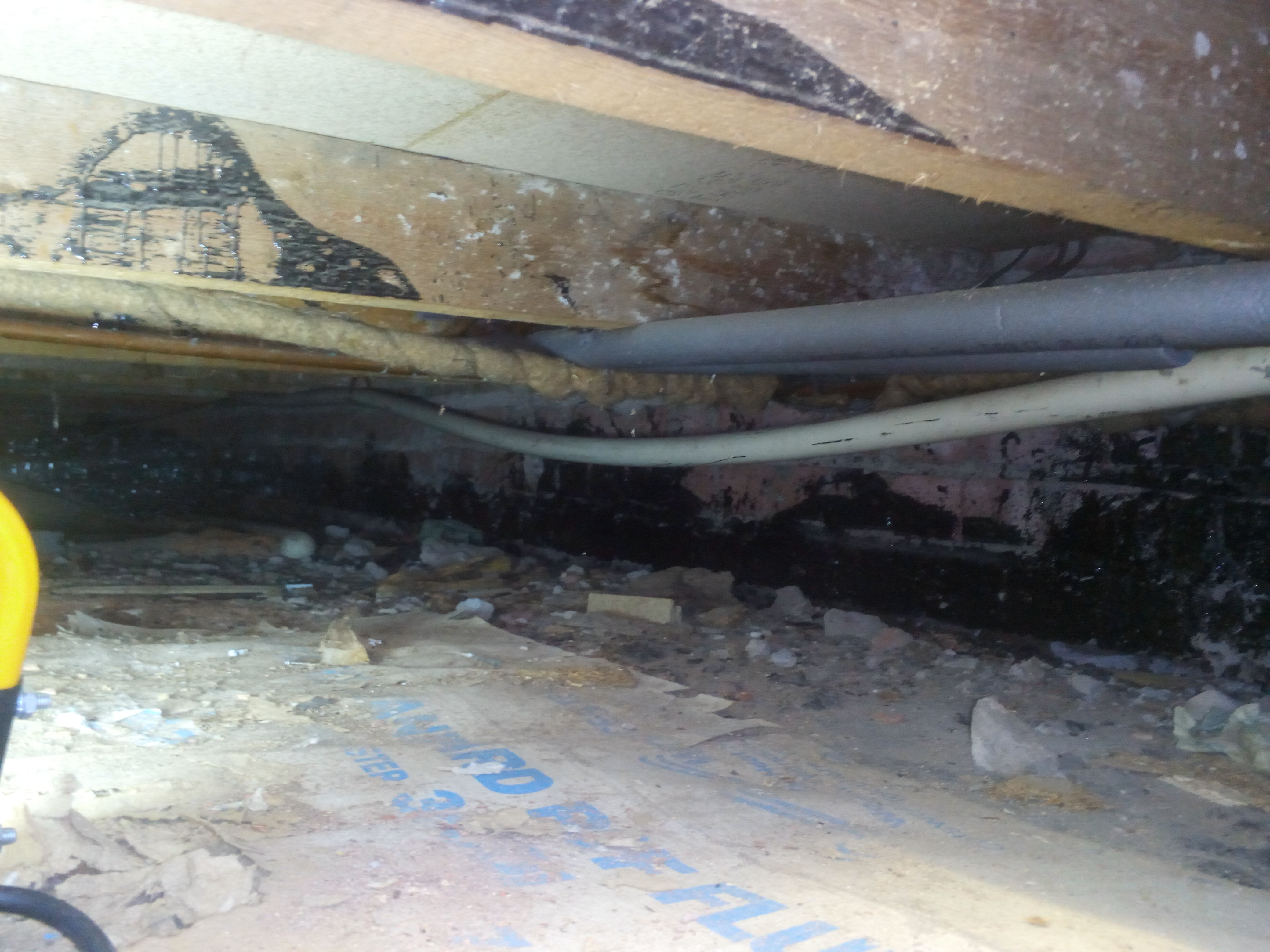

I found another photo showing how it was before I added a couple of supports. This is looking towards the bend but from closer to the sink.
You can't drop back down to 40mm, you'll need to run 3"(82mm) all the way to the soil.

If it was sagging below horizontal it will be partially blocked and so it will not drain properly. It also appears to be leaking at that first 90 bend. Should be clipped every half meter. I see this sort of thing a lot, sadly.

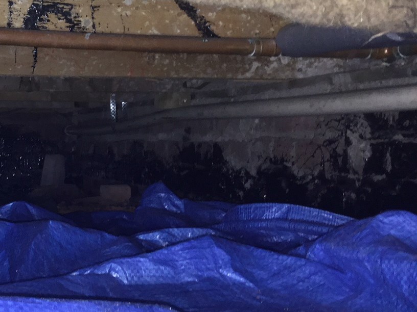

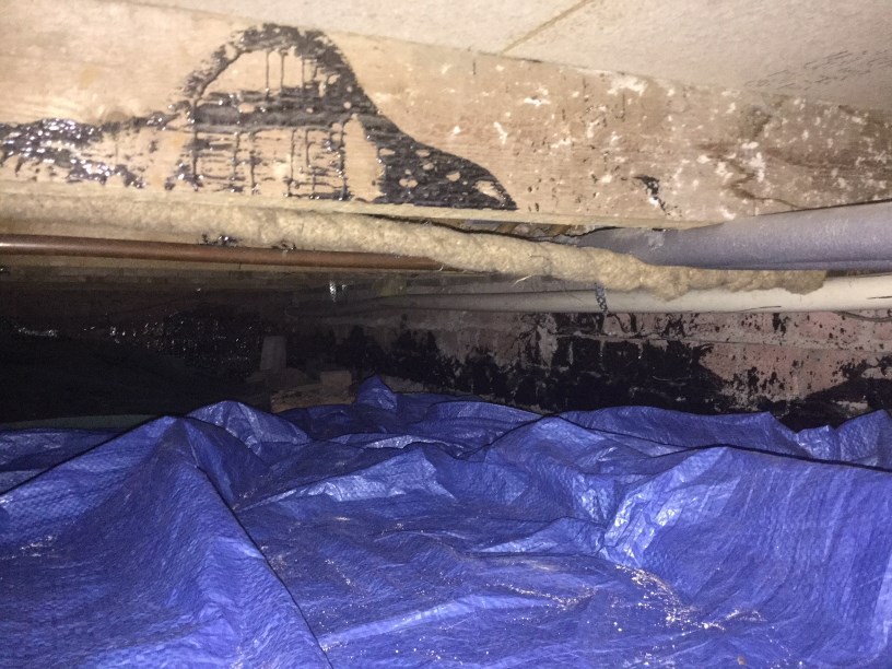

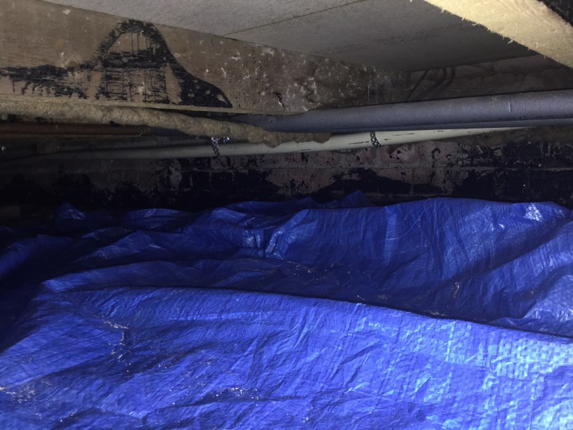

Worth saying that I have repositioned the pipe since the original photos, by removing bricks, changing existing clips and adding other supports... and a bit of wood.
I've taken some new photos. In these, the sink is to the right and the right-angle turn towards the left. The lagged pipe running across is the obstructing pipe leading to an external tap. There's a bit of wood 3/4 of the way along preventing the pipe bending further upwards.
If you're thinking that the pipe will be clogged due to previous sagging, is it worth pouring some acid down to see if it helps? I did that when the pipe was in it's initial position and didn't notice much difference. Maybe now the pipe is better positioned it would help, albeit temporarily?
