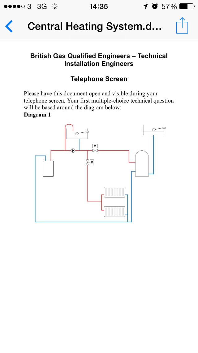

This is the image they said they will ask me questions on. Does anyone know what questions they ask at all? Or anything glaringly wrong with this picture? :D
If they get picky it needs a balancing valve on the hw return and some docs at the lowest points
System pipe work is under negative pressure with neutral point after circulator.
Danger of draw-down on the open vent when circulator starts, depending on the system head.
Auto bypass required before zone valves if boiler has pump overrun fitted.
How are the red & blue pipes connected at the cylinder ?
What are the two things marked with an "M" & what do they do?
Why should the righthand cistern have a higher water level than the one on the left ?
What size pipes should be used & where ?
This is fun we could / have recked BG's entrance exam. Any more anyone can think of?
All answers been said but if being picky the returns could go closer to boiler seperatly b4 teeing in together, oh and it defo needs a powerflush and a magnaclean

The glaringly obvious ones are: no supports under cws & fe tanks and cylinder.
No magnetic filter so obvs will need a power flush.
being picky but
no trv's
no drain point
